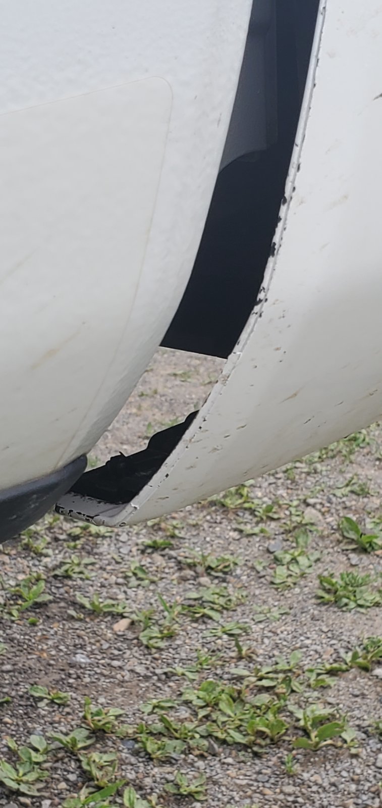

    That doesn’t look so bad, it’s just a few nicks. I once knew a guy who thought the runaway truck ramp was a freeway exit, boy did that look bad!
    But the worst I ever saw was what happened after the cow licking incident. A herd of cows licked all the paint down to bare metal when a buddy parked his rented work truck in a field!
    :rofl:
    Ok, so for such a new truck that does look sad, and you should take it in. At least it’s not the dreaded peeling paint issue a lot of us Arctic White Tacoma owners have, welcome to the club!

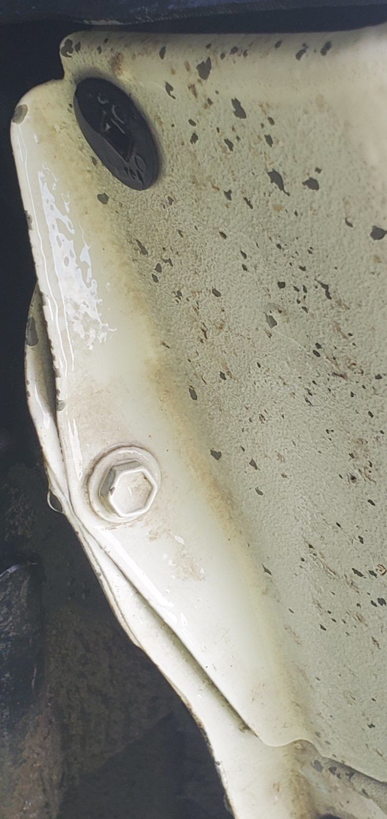

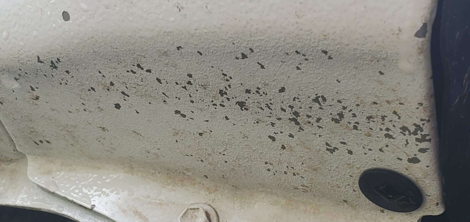

    These "chips" do not appear to be paint loss from stone impacts. They are too consistent and almost have uniform patterns to them. No primer loss or underlying sheet metal dings. Many of them are almost duplicates of their neighbors around them: Rounded at their trailing edges and elongated at their leaded edge. Almost like a flow effect or spray-effect when something got splashed up resulting in eventual loss of paint or some contamination of the surfaces before the final color coat was applied.

    The thread is getting kind of long, so you may have missed the photo and post - I cleaned a small area with rubbing alcohol and it almost instantly dissolved the paint. Toyota repainted the poster's truck you're quoting for the same issue.
    Your observation of how the paint is flaking/chipping is a good way of describing it.
