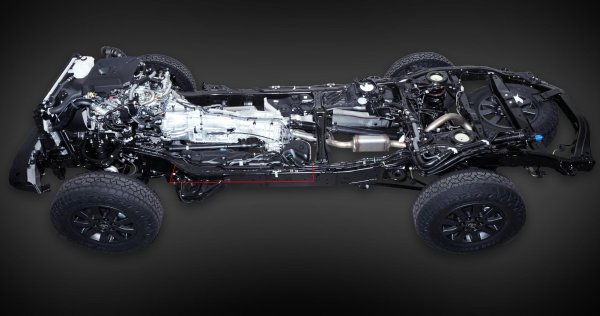

    ^Where do you think you are, Europe? :rofl:
    Note the massive DEF tank squeezed between the front driveshaft and frame rail:
    SwollenGoat likes this.
  8. Dec 29, 2023 at 5:19 PM
    #88
    SwollenGoat
    SwollenGoat Onwards and Upwards!
    Dec 13, 2014
    #144225
    8,234
    ‘21 ACLB, ‘99 XCLB, ‘92 RC, ‘85 4R
    Where did find those? Guessing that is the Prado 250, yeah?
    Any mpg figures on that? Just curious.
