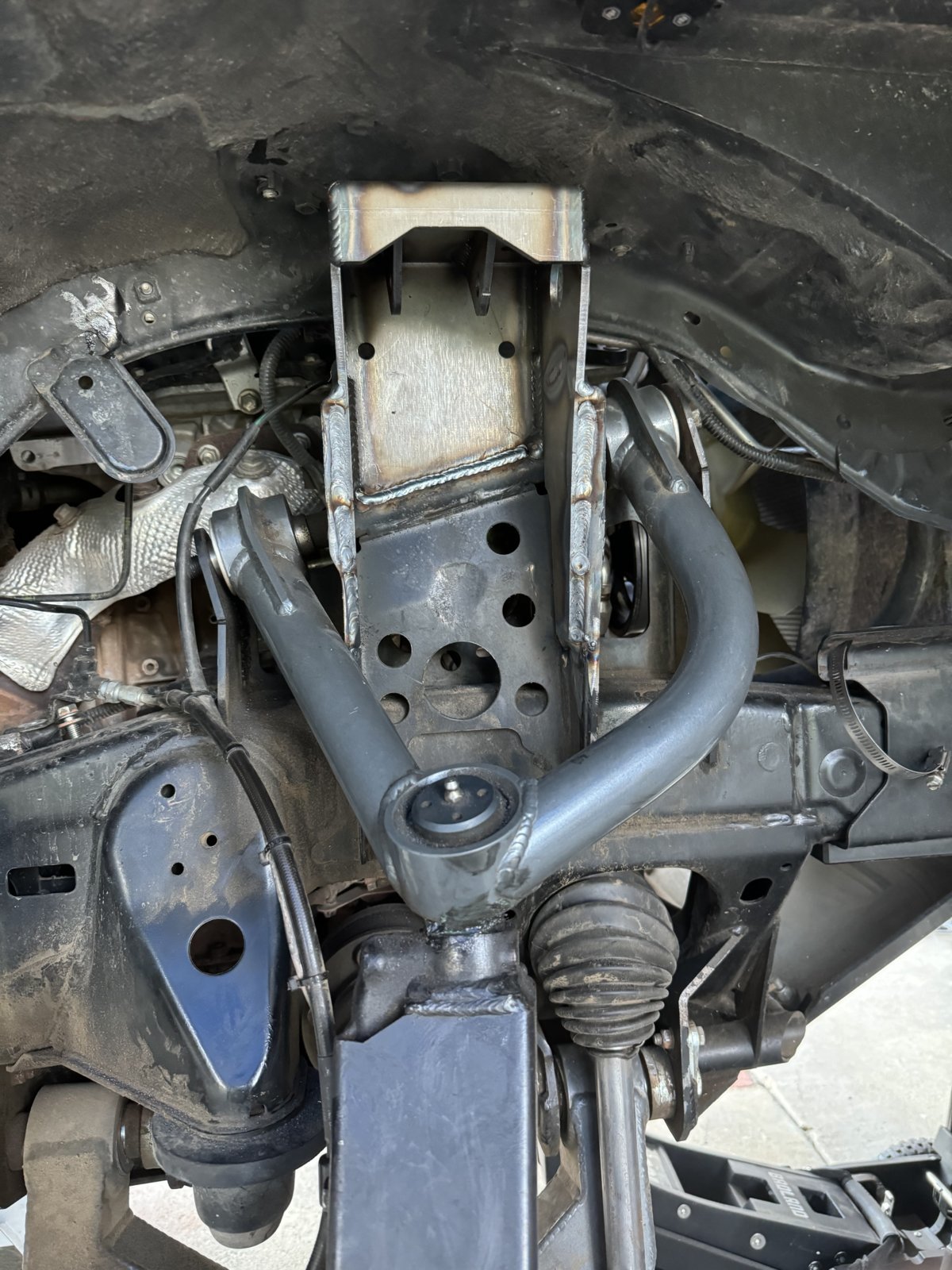

  18. Aug 16, 2024 at 9:19 AM
    #58
    lit_taco4x4
    lit_taco4x4 IG and YT: @2a_crawlcamper
    Apr 7, 2021
    #361928
    1,054
    Louie
    2018 Tacoma TRD Pro
    JD fab LT, Archive and Deavers, King shocks, Dual locked, Dual T case, Tundra steering rack, 39’s
    Here’s my solution:
