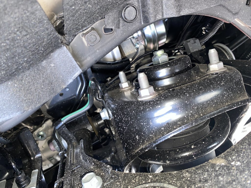

    Chock it up to early adopter woes. The 2025 4Runner went back to a steel top hat. Not sure if the 2025 Tacos did as well. Picture of a 4Runner at a dealer:

  7. Mar 20, 2025 at 8:56 AM
    #147
    gmtech
    gmtech Well-Known Member
    Nov 13, 2018
    #272524
    582
    quad cities illinois
    2016 trd or. 2024 trd OR iforcemaxx!!
    Stock AF

    Sure would be nice to find out if they changed the Tacoma top hats to steel. I’d like to replace mine for them rather than adding an aftermarket on top of pot metal ones.

    How can you tell that it is steel instead of pot metal? I wonder if the 4 Runner part would fit the Tacoma?

    That looks proper!

    That's clearly stamped steel like Toyota had been using the previous 40 years. Compare side by side with the 2024 potmetal cap and it's very different. You are welcome to drop by your nearest dealer with a magnet in hand.

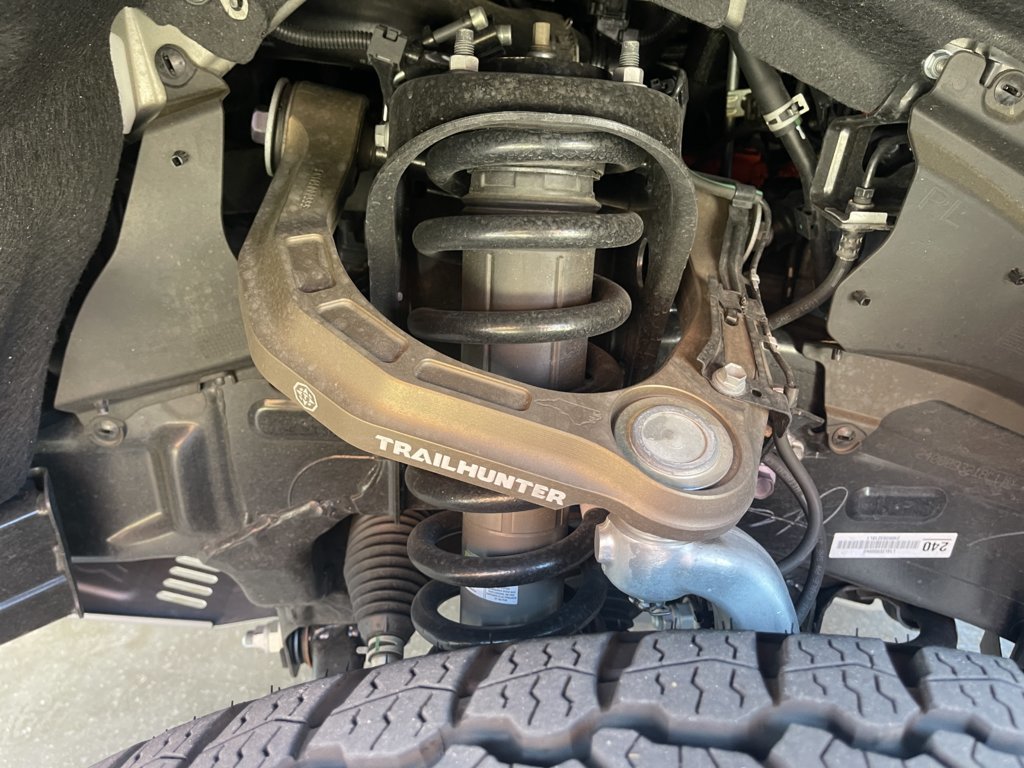

    TACODOC1
    TACODOC1 Well-Known Member
    Jan 9, 2012
    #70334
    565
    SoCal
    2024 Tacoma Trailhunter - Bronze Oxide
    2024. September build date. Both sides look good after 3,000 miles.
    I’m going to look closer during daylight tomorrow

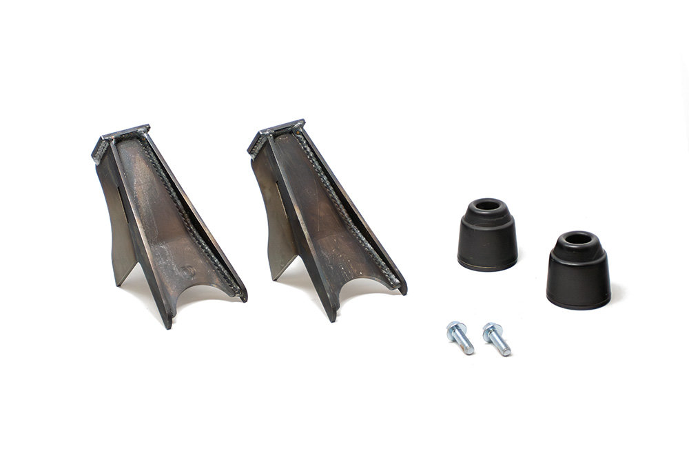

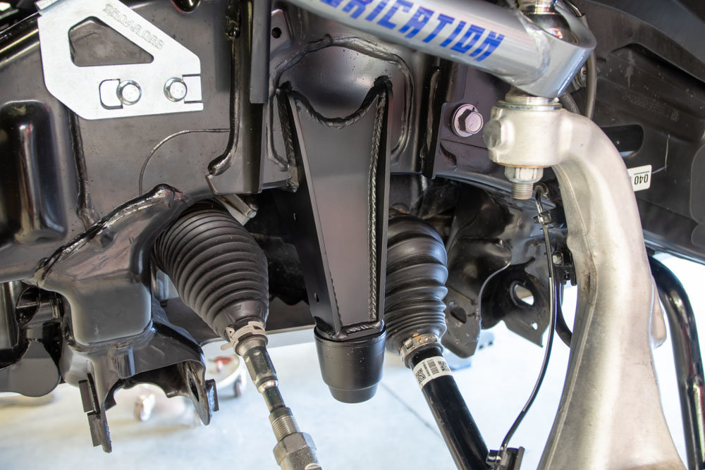

    Part of the problem is the internal bumpstop. Coupled with a weak top hat. Recipe for destruction. If the truck still had an external bumpstop like all previous Tacomas and even the current land cruiser, would not have happened.

    I'm sure they are working on a decent solution. A balance of strength, and ease of install are key.
    Total Chaos has a weld in option available. But it's designed to go with their aftermarket lower control arms.
