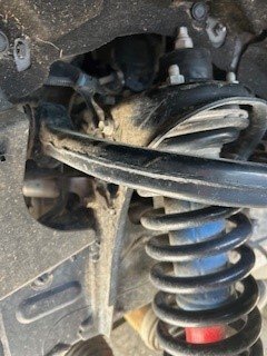

    I was on a gravel road, but I could hear it 'tapping' when I went over a bump or turned. Then I got out and looked at it and could see the top of the shock. When I went to Toyota, they said I'd feel a lean or a rough ride, but I didn't notice either, only that something sounded different. I had to drive home and only felt it a few times, haven't driven it since. It looks the same in every photo, but here is mine.

    I should also add, I asked Toyota if I should fix it, and they told me to wait to see if a recall would happen. Because of that, I am going to see who in Canada may take an interest in this, as there is a move in the US to have this recalled. I don't know yet, but will update if I hear anything.

    I completely agree. I’m currently dealing with the warranty process for this issue, and I spoke with a friend who owns a steel fabrication shop. He took a look and said it definitely appears to be a design flaw.
    In my experience, Toyota isn’t exactly eager to do warranty work—though to be fair, in 25 years of owning their vehicles, I’ve rarely needed it. But given the delays in getting parts here in Canada for the brake line replacement, I can’t see them rushing to issue another recall. This may be something Transport Canada needs to step in on.

    Update from Toyota: the repair for this will be May 15th.
    That means, on my $71,000 TRD ORP Tacoma, I am not able to drive it for a month and a half while waiting for this repair.

    try looking to see if anyone was selling a take off strut you could use untill replacement is had?
    https://www.car-part.com/cgi-bin/search.cgi
    looks like you can get a whole front shock assembly for 89$ . could get you back on the road. dealer could keep the old one. you might have to pay labor to have them install the used one.

    I thought I had seen some YouTube videos of people who had preemptively changed it out for a reinforced top plate... (the Icon link below says " Will not fit Tacoma TRD Pro or Tacoma Trail Hunter"). I cannot find the video of the replacement procedure, but I recall it looked like a straight forward modification not requiring much more than a wrench (no need to remove the wheel or jack up the vehicle). The Icon replacement is $73. It looks like you have to order two, but that is a question to ask Icon.

    I'm sure you could, but after paying for an alignment and installing new tires, I'd not want to. Not only that, but it hits the wheel well and I would imagine that would not be covered, so it simply causes more problems.

    Icon cost has dropped to $60 with free shipping.
    https://iconvehicledynamics.com/acc...tacoma-coilover-top-plate-reinforcement-kit/#
    I am picking up a pair just as a precaution, esp. since the jury's out on whether Toyota will offer the fix, much less pay for it. Plus, I can only imagine how long the wait will be for my local stealership to get me in there plus how long I'd wait in their waiting room for the job to be done. Frankly, $60 plus 30 min. worth of work in my garage is well worth not dealing with the stealership.
