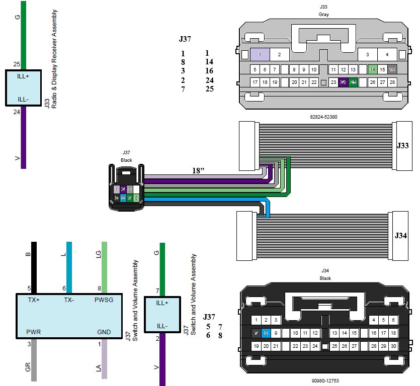

    Hood Struts, My version Fogs always ON, Map & Overhead Light Mod,
    Updated harness:
