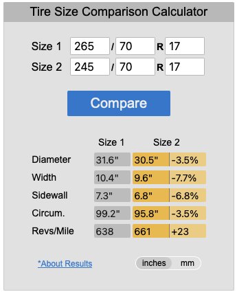

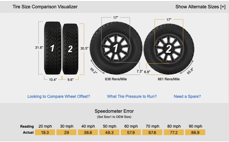

    Noticed this issue with a '19 Frontier SV. Speedo indicated faster than actual speed. 23 Taco SR did the same thing. Both cases was 2-3 mph.
    It seems they calibrate the speedo for whatever the largest tire option is across the option range. If you buy a lower trim with a smaller tire, your speedo reads faster than the vehicle is going.
    Quick "here how tire sizes work", for those who don't know. The first number is the width of the tire in mm. How that gets measured can vary by manufacturer, but usually it's the contact patch (outer edges of the tread pattern). A 265 is 265mm across. The second number is the aspect ratio. That's a percentage of the width. 265/70 means the height of the tire from the lip of the rim to the top of the tread is 70% of 265 - or 185.5mm. The last ("R") number most everybody knows. It's the diameter of the wheel in inches.
    The SR comes with a 245/70R17. The OffRoad comes with a 265/70R17. The outside diameter of the Off Road tire is about an inch more than the SR. It doesn't make as many revolutions at a given speed, so the speedometer reading is less than a smaller tire. That same principle is why putting bigger tires on your truck changes the indicated speed (makes it read slower than you're actually going).
    You have 3 options to correct your speedo. 1st is buying a device that recalibrates (or "translates"). Guys who put 33's and whatnot are familiar. 2nd is buying a tire with a higher aspect ratio (245/75R17), and 3rd is a wider tire with the same aspect ratio (i.e.: what comes on the Off Road).
    Yeah, there are two 18" options for the Tacoma too. The TRD Pro is 265/70R18. It's about an inch bigger in diameter than the Off Road. The Limited is 265/65R18 - the same diameter as the Off Road.
    You can use and input data to your heart's content.
    Here's the comparison between the SR and Off Road sizes. My OR indicates maybe one MPH faster than GPS. It's pretty much spot on.
