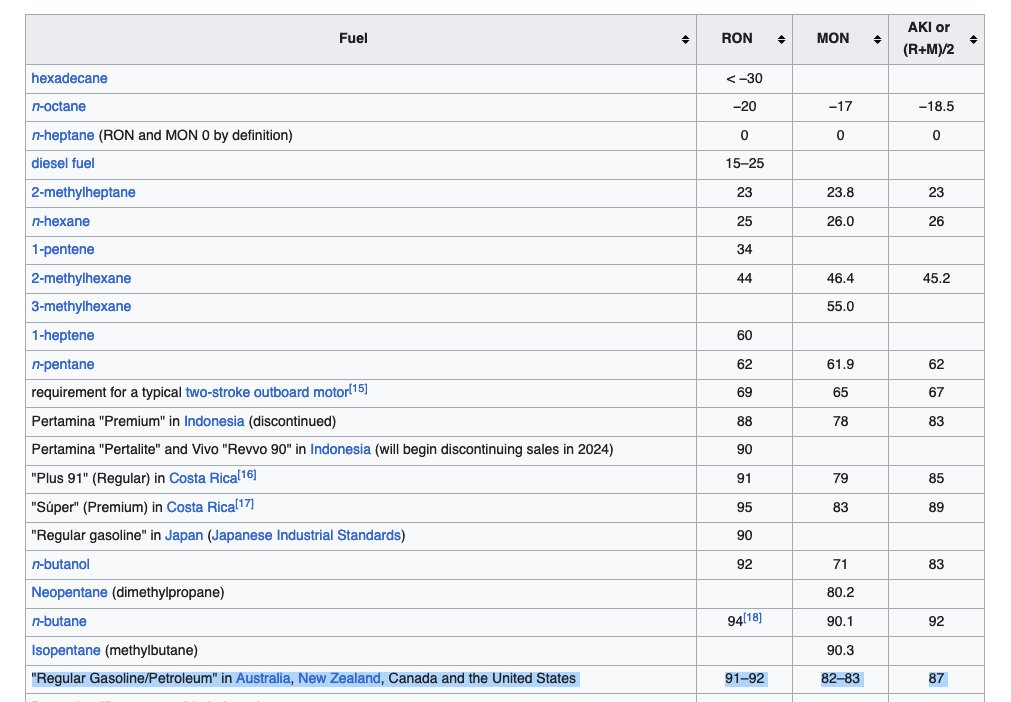

    Who says you need to run 91 octane?

    ah yes... i was going off teh post a page back.. officially 87... carry on

    It's RON vs AKI.... 91 RON = 87 AKI
