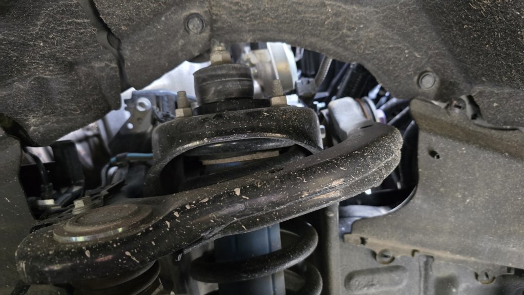

    I don't know why the servicing dealer is trying to shift blame. The strut mount and cap are made of cheap potmetal (new for 2024!) and the cap is known to pop out. It's well publicized. The cap wouldn't have been missing during PDI. It's Toyota's defect. The dealer didn't build the truck.

    Given how hard the vehicles are jumped from boxcar to boxcar during transport to dealers, the strut mounts could've cracked on arrival yes.

    I would love to see a picture of the broken part after it's removed (Edit: Anyone have a picture of a removed intact upper mount? I can't find any googling and Toyota's online diagram looks like it was made by a toddler with crayons.)

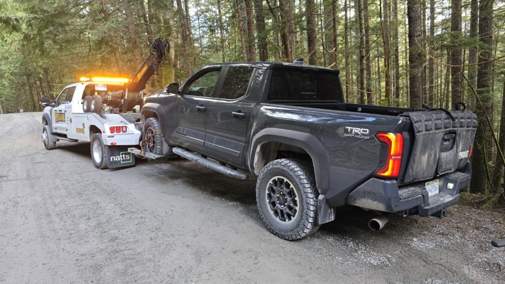

    2024 Tacoma Hybrid Off Road Premium. In Canada. My right shock top hat blew on a pothole after 6000km on a forest service road. I watched as F150s, older Tacos, Rangers and Subarus hit the same pothole for 2 hours with no problem. I had truck towed to Squamish Toyota 3 weeks ago and its still there. I've called multiple times and been told "We'll call you when it's done." WTF? How can Toyota sell a truck with a design flaw then not have parts for it when it breaks? It's the first Toyota I've owned and I bought Toyota based on my understanding that they offered excellent quality and outstanding customer service. It's the 2nd issue requiring warranty repair I've had with the truck so far. I've never owned a vehicle that has broken twice in the first 6 months and required so long to fix. And the worst part is that when they do fix the truck it'll be 'fixed' to the same condition it was before it broke and will undoubtedly break again. I'm hopeful this will be a recall given the number of vehicles affected so far. Maybe it will take a highway failure leading to death to make that happen? I'm already regretting the purchase but don't really know where to go from here other than waiting to get it back and break it again. Maybe there is an aftermarket shock I could use to replace and ask Toyota to foot the bill? susptophat.jpg

    Shitty design, for sure but it’s such a great truck overall. Be patient, it’ll get fixed. This thread reminded me to buy the Icon top plate. $73 and free shipping is a no-brainer.
