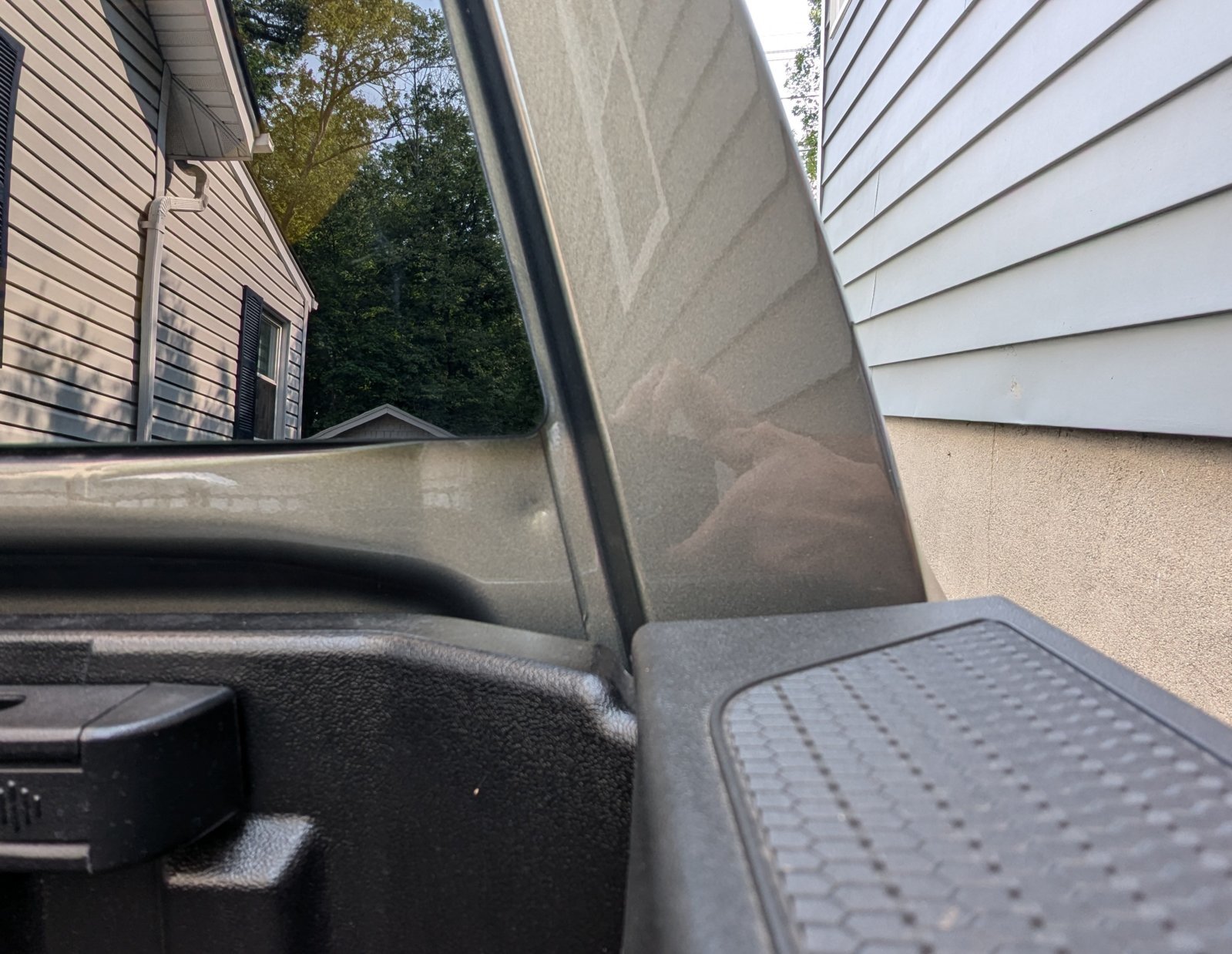

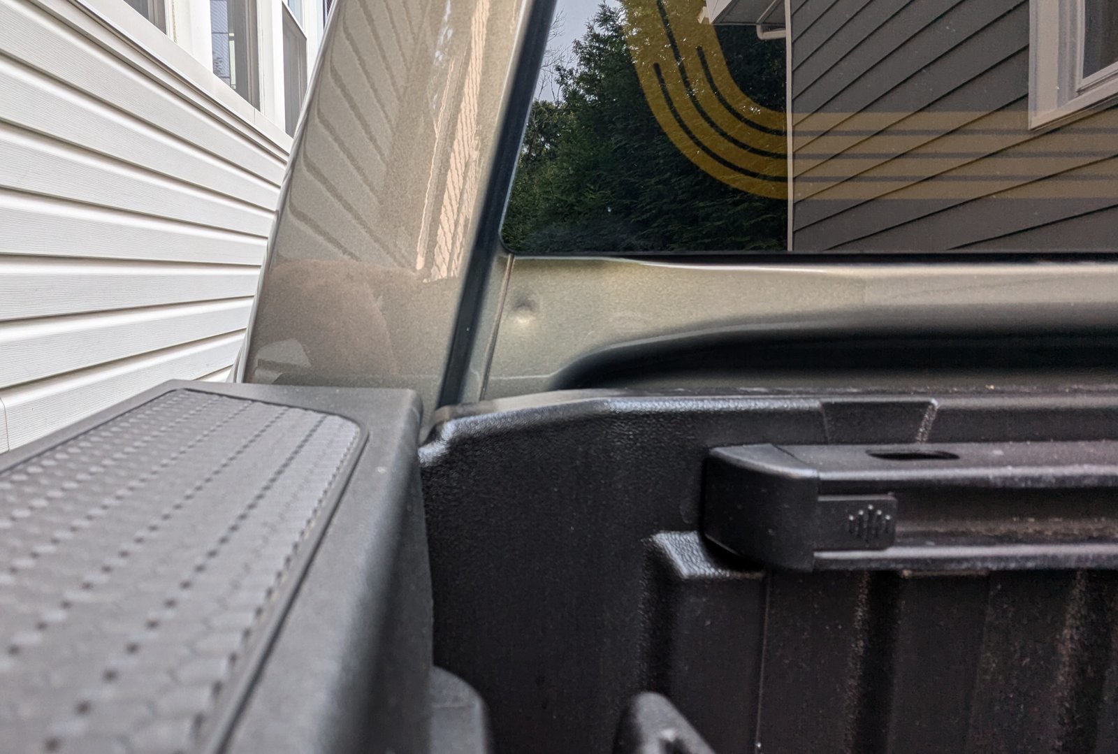

    Here is my misalignment. I had to get very flush to really notice it, I am not upset about it.PXL_20240816_195650386.MP.jpg PXL_20240816_195723896.MP.jpg

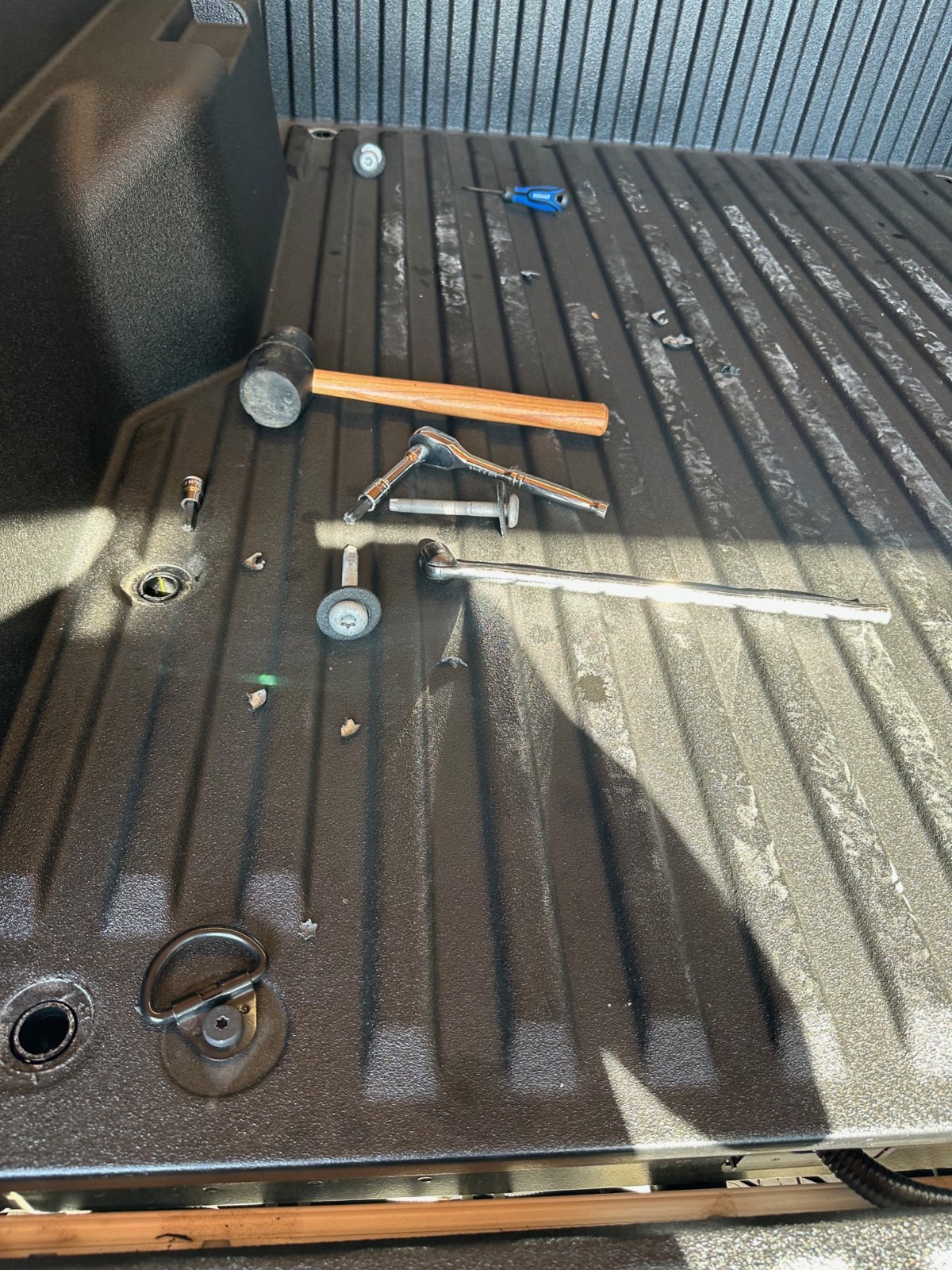

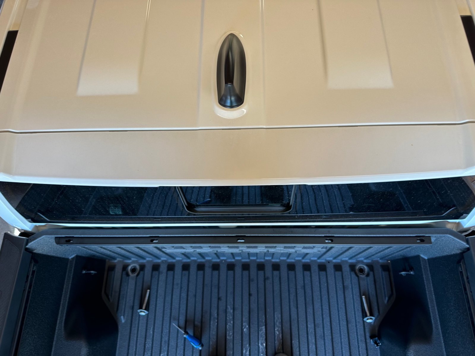

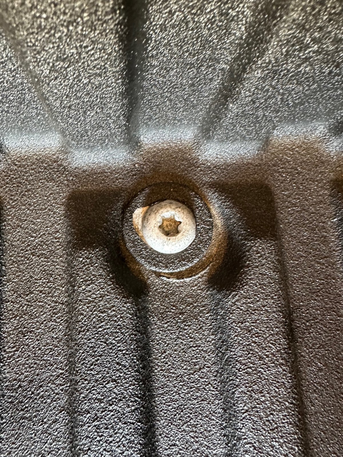

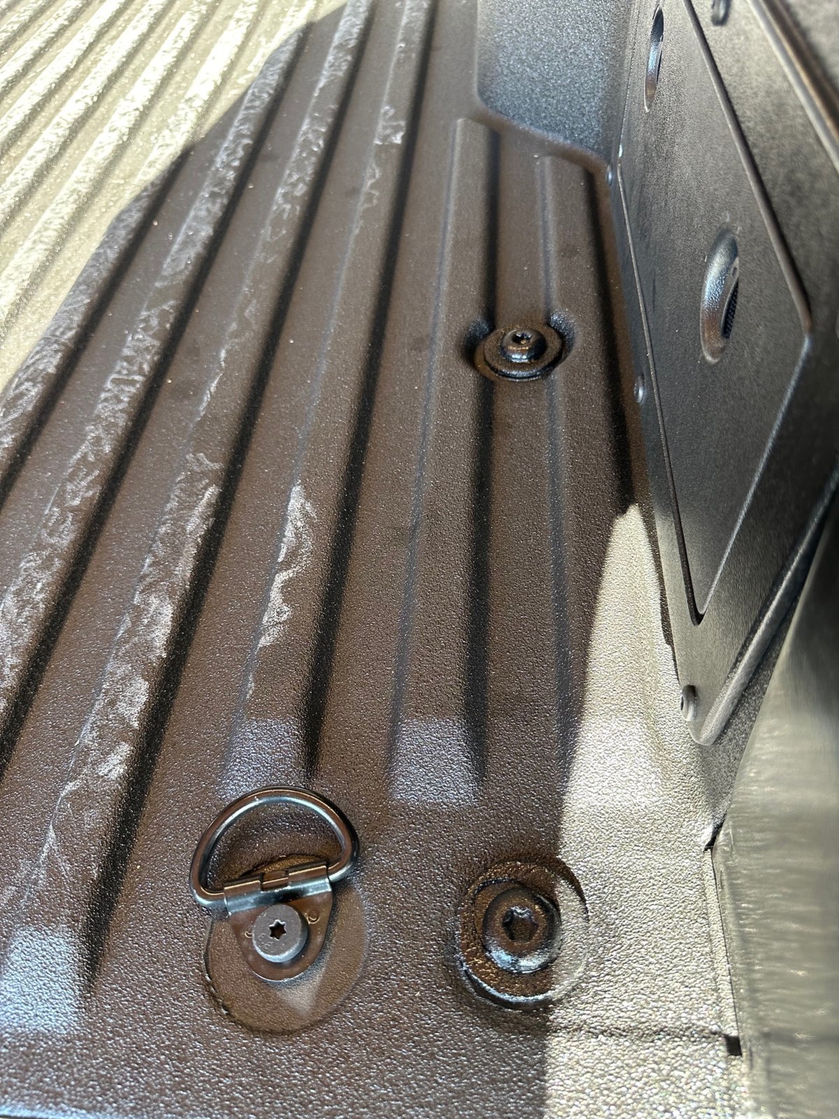

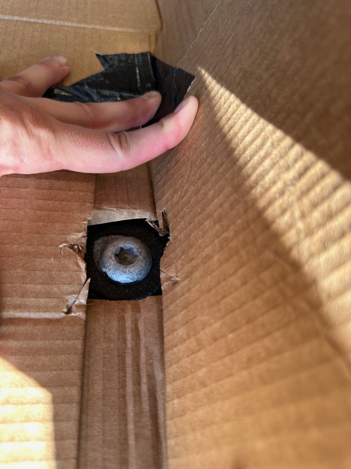

    Decided not to wait for the dealer to fix it and did it myself. What I think it actually is, is the bed may not have been made with tight tolerances vs just the alignment. On the picture showing between the cab and bed, it's hard to see in the picture but obvious in person. Adjusting the bed from left to right was creating a larger gap in this area on one side. Might just be because of how they drilled the holes in the bed & how much adjustment those holes give you.... I dunno, but I didn't want to end up with a cooked bed vs an offset bed. From the factory with the offset bed, the bolt holes lined up perfectly dead center with the frame. They give you mayyyybe a quarter inch of adjustment before you wouldn't be able to thread the bolt.
    Anyways, I went with a compromise between that left to right gap between the bed and cab - and the bed's left to right alignment, leaving it off around 1 to 1 1/2mm on the left side which also gave 1 to 1 1/2mm off in the gap "larger gap on the right side." You can see from one of the pictures, how much the bed moved vs were the bolt went back in. To the eye, it's now not noticeable at all. Zero chance the dealer would have realized that they might be creating an angle on the bed while moving it left to right if I had let them do it.
    From the factory, my bumper gap between the bumper and bed was already larger on the left side, this adjustment increased that gap and it's now much larger on the left vs right. I don't know how to adjust the bumper but in person this isn't noticeable unless you really look for it so I'm not super worried. To me, the bed was noticeable since it is skinnier than the cab and there was a giant difference at eye level. Mine was off around a quarter inch but it looked like a half inch visually.
    Notes for anyone that wants to do it. I literally have no idea what I'm doing & it took me a little less than 2 hours with a T55 Torx and some bedliner spray. Once the bolts are out or loose, you can literally lift up the bed with one arm it's so light. Part of this time was digging out the bed liner spray in the bolt holes with a flathead screwdriver so the bit would fit. That bedliner is pure junk, it comes off pretty easy. I used blue loctite on the bolts and torqued to 55lbs, I had planned to go 60 like someone else did but at 50 I was barely able to go more, might just be my wrench. Then I placed cardboard with a hole over the screws and sprayed them with bedliner spray. Looks like new.
    Not saying to follow my example if you want to adjust it yourself, again, I have no idea what I'm doing. Just adding info to the thread.
