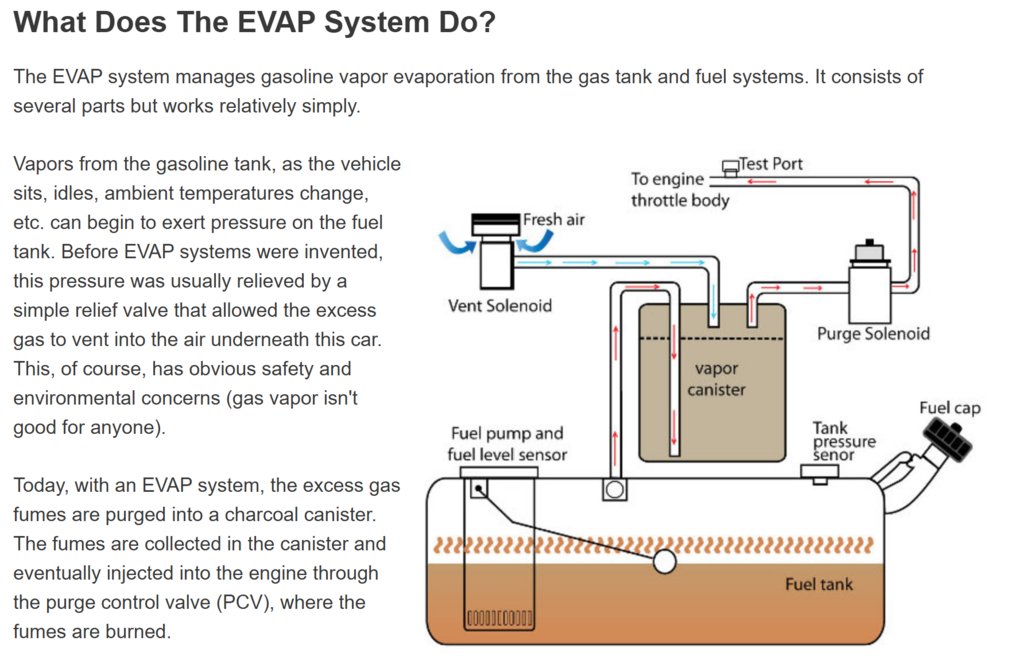

    Maybe this will help you. You can also get codes with a loose or bad gas cap
    The charcoal canister is the same as an Evap canister.
    Here's a breakdown of common EVAP codes and potential causes: This is not a 100% complete list
    Common EVAP Codes and Meanings:
    • P0441: Evaporative Emission Control (EVAP) System Incorrect Purge Flow
    • P0442: Indicates a small leak in the Evaporative Emission Control (EVAP) system.
    • P0455: Indicates a large leak in the EVAP system.
    • P0456: Indicates a very small leak in the EVAP system.
    • P0457: Indicates a fuel cap issue (loose or off).
    • P043F, P043E, P2401, P2402 and P2419 can also map to a bad EVAP canister or purge valve
    Possible Causes and Troubleshooting:
    • Fuel Cap Issues:
      • Loose or Missing Cap: Ensure the fuel cap is properly seated and tightened.
      • Damaged Cap: Replace the cap with an OEM (Original Equipment Manufacturer) cap if the current one is damaged or doesn't fit correctly.
      • Aftermarket Cap: Using a non-OEM cap can sometimes cause issues with the EVAP system.
    • EVAP System Components:
      • Fuel Tank Vent: Inspect the fuel tank vent and related hoses for leaks or damage.
      • Charcoal Canister: Check the charcoal canister and its connections for leaks or damage.
      • Purge Valve: Ensure the purge valve is functioning correctly.
      • PCV (Positive Crankcase Ventilation) Valve: A faulty or "stuck" PCV valve can also trigger EVAP codes.
        • Other Issues:
          • Short Circuit: A short circuit in the EVAP system's wiring can cause problems.
          • Faulty Sensor: A faulty EVAP system sensor can send incorrect readings to the computer.
    Here is a brief description on how a Toyota EVAP system works. Think of it like you would water flow in your house and how the vapors from the fuel tank go through the Canister. If for example the purge solenoid isn't working or the freshh air solinoid isnt working you can see there is no place for the vapors to go.
    The other thing to know is Toyota EVAP systems do a test when your vehicle is off it will create a vacuum in the system and if it detects a leak like gas cap or hose, it will set a code. One way to tell if its the test is to clear the codes and drive. If the codes don't come back after driving before the truck cools down, it may be the overnight test that is setting the code. My baad EVAP code only came after the teest ran. Toyota can initiate this teest with Techstream. This test doesnt run every night, it runs after so many miles, so many starts and stops and when the temp of the engine cools down. I had to troubleshoot this in my Land Cruiser and it took sometimes 3 days to initiate the overnight test.
    blah blah blah- why amd I asking you about this? When the code happens and how it happens along with what code can help really dive in on what the problem is. This can only help with your discussion with Toyota. You are more likely to win any discussion if you speak with data, even if you don't fully understand it. What I suggest is you have your current mechanic tell you exactly what codes are set, if they happen immediately or from the overnight test. Then when they diagnose it and fix it ask him if that could be from overfilling. Ask them to keep any removed parts in case needed to build your case. I would come back here with all this info and some of us may be able to help you build a case.
