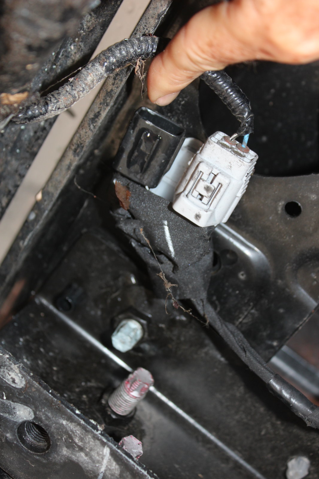

    I have a 2021 SR 4x4 - I moved my GFC camper to the truck. I wen to hook up the 3rd brake light - Under the drivers side at the rear corner under the bumper is a open connector. See photo - Is this for a brake light? can I buy a plug instead of tapping the brake light wires?

    No, that is for the parking sensors and cross traffic system I believe. No brake signals there. @caribe makaira will confirm for you.
    Grey is plate lights and BSM.
    Also, this is a 2024 specific thread so not ideal for your third gen specifics as 4th gen adds complications for toppers as noted here in this thread.

    David is correct, that connector is not for brake circuit. Parking sensors and Blind Spot Monitor System sensors.
