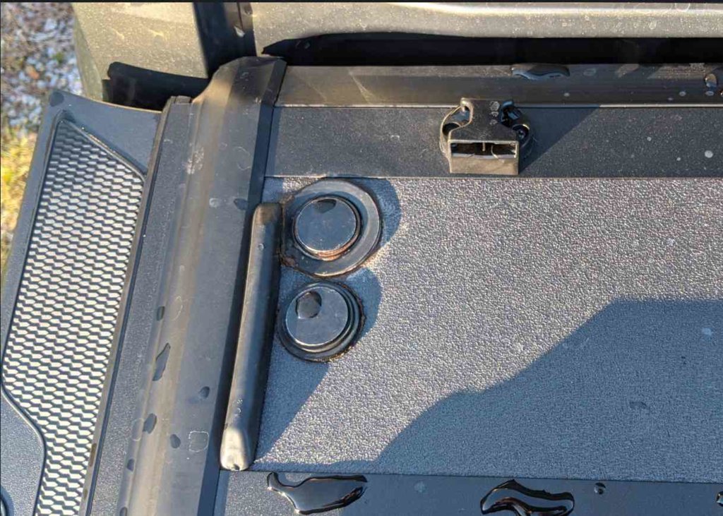

    Bro, I installed min myself. No washers should be on the top. The bolts at the top are black. They cover the hole and are tapered with a rubber gasket. Then there is another rubber washer that goes on a Black thick spacer. Then the rail bracket then that big washer. Then a lock washer then a nut. mine does not leak. Those holes should be fine.IMG_0110.jpg

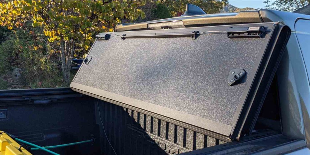

    Here is a picture of the Tonneau leaning against Cab

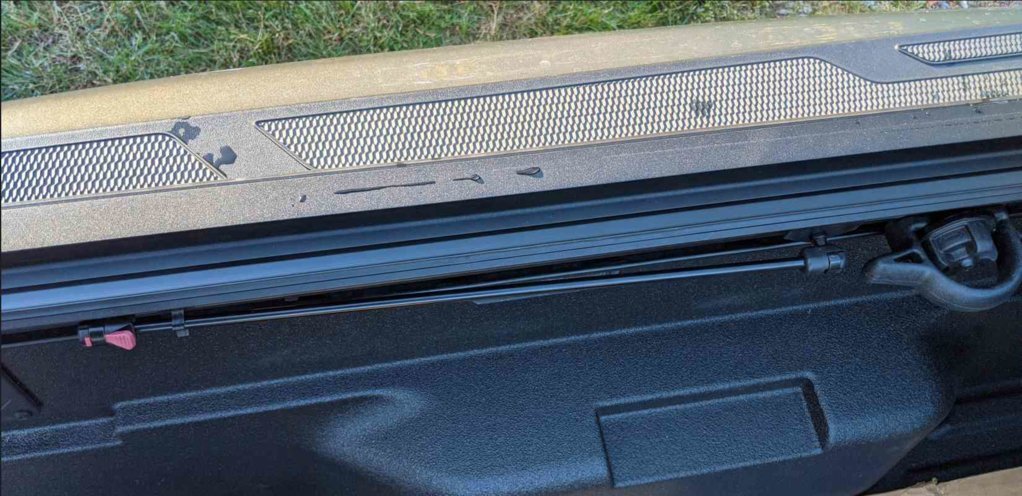

    and the rail with the prop rod

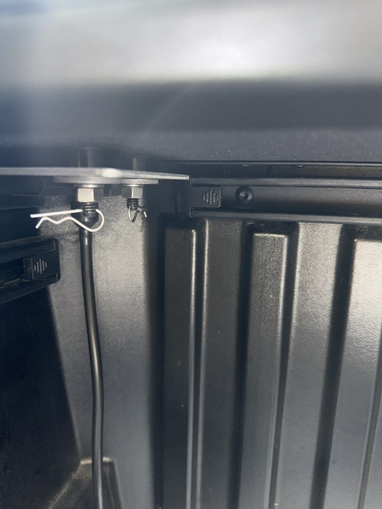

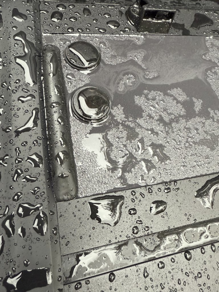

    To fix the damage done by the installer (don't ask, less than competent installer and I got a big price adjustment) I added in some extra rubber washers and gasket seal. I will fix color when set for a few days. It no longer leaks around the bolts and the rail gutter and drain works properly now.

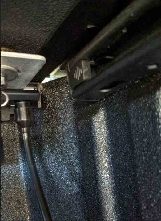

    I do however get a small amount of water up in the corners by cab. I see light. How did you get rid of that? You can see the tonneau is flat in the corner.
    Here is a picture from the inside:

    I think mine sits the same way. Not sure if I get a little moisture there or not. I know for a fact this one is way more water resistant than the 3rd gen oem trifold. So I’m ok with it. It has weather stripping over it and it’s behind the cab

    Adding silicone to the corners will fix the leaking.
