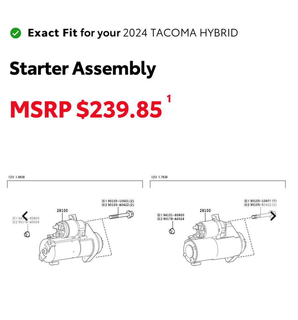

    I remember the car care nut addressing this in one of his videos. The hybrid truck actually has a standard 12 volt conventional starter in addition to the normal operation which is the ability of the motor/generator to handle starting. I’d assume that is in case the relatively small hybrid battery is dead or to allow jumpstarting.
    If you look up in the parts list of a hybrid trim, there is indeed a normal starter.IMG_1689.jpg
