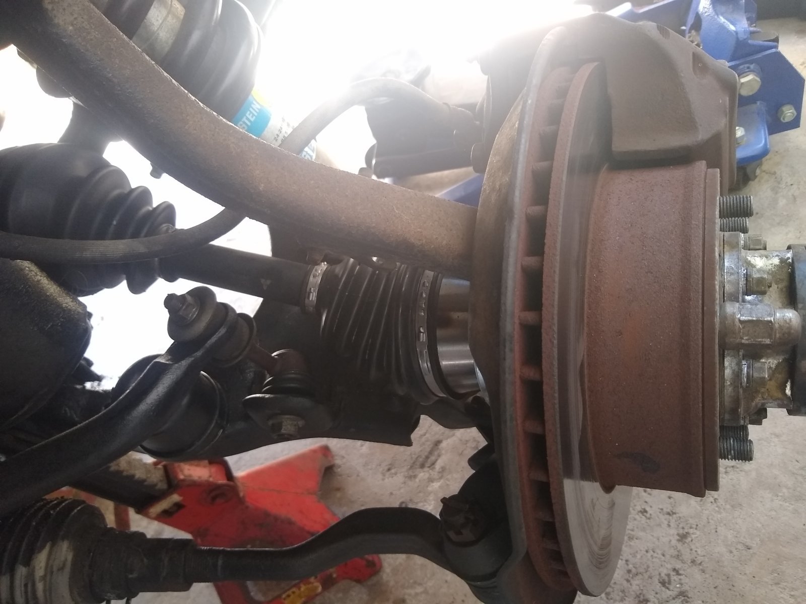

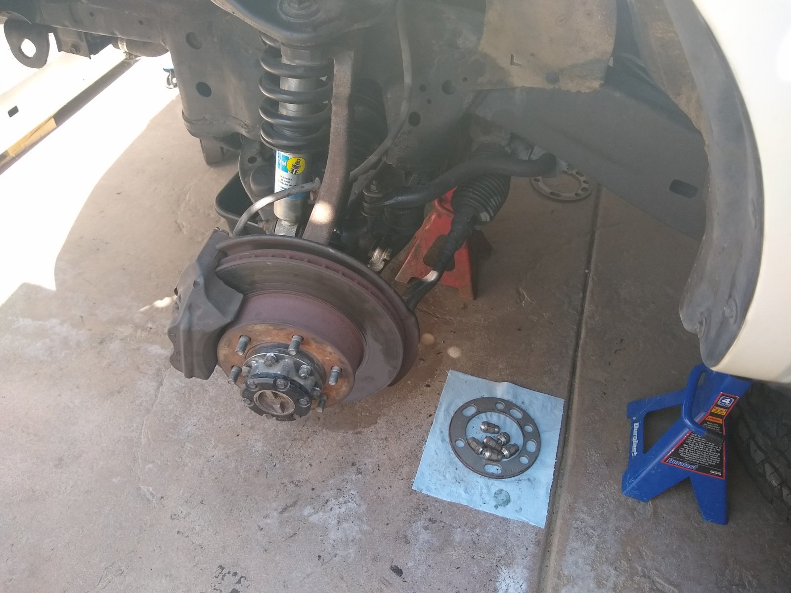

    Changed out the CV axles, CV axle oil seal, and LBJ on the driver side.
    Drained the front diff gear oil too.
    Tomorrow, changing out the pass side CV axles, CV axle oil seal, and LBJ.
    Change ALL the diff fluids by tomorrow.
    Got a new window washer fluid reservoir tank as well. My washer neck was completely dry rotted... typical.
    So, gonna try to do that tomorrow as well.
    Then, I gotta replace my front brake pads. Plan on doing that in about 2x weeks.
    The finished front driver...

    I've always liked how much smaller the manual hubs are for the 1st gen tacomas. Mine stick out so far I've smacked them on rocks a couple times, and a buddy broke one of his too. I wonder if there is a way to retrofit them onto the older trucks...
  16. Jul 5, 2024 at 3:46 AM
    #956
    WileECoyote
    WileECoyote Well-Known Member
    Sep 22, 2014
    #138864
    6,128
    SoCal
    1st Gen 4WD 2.7L RegCab
    Yaesu FT-1900R w/ 2m/70cm Comet SBB-224 antenna, Cobra 19 DX IV w/ 4ft Francis CB24 Hot Rod antenna, Uniden Bearcat BC355N 800Mhz mobile scanner (analog), an external BNC mount routed to inside the cab for a handheld fire/police scanner or HAM HT's, Rancho RS5000 front struts and rear shocks, 6in KC Daylighter (pencil beam), 15x7 Black Rock Wheels Series 942, 31x10.50R15 Firestone Destination AT, fog lights, COBRA antenna hood mount (this is used to mount the GoPro on to)
    You probably can? I would think it would be a fairly expensive conversion kit though?
    You'd need to take into consideration axle length, spline count, wheel bearing hub, etc.
    In other words, you would have to change out pretty much the whole front suspension components from the steering knuckle, control arms, etc etc etc.
    The only thing that "engages" on the hubs is really just that very outter portion.
    Pretty damn neat and impressive engineering at work there on how they figured that out.
    I plan on going back and revisiting both of those hubs though because the star gasket on the driver side is ripped partially due to just wear and tear. So, going to order replacement gaskets for both sides.
    I will be doing the pass side today. I've done CV axles before, but this is my first time replacing on a 4wd and with manual locking hubs. It turned out not to be all that hard as I prepared myself by watching as much YT vids as possible and reading my repair book. Just did all kinds of research.
    I still ran into some minor things because doing the actual work is just always completely different in some form or fashion. BUT, all in all, it was a pretty easy job.
    The ONLY thing for me that was very nerve racking was making sure the axle oil seal was not installed cockeyed or too deep. Everything went and looks fine, but I will be doing a test drive obviously.
    What you don't know is that I'm working on my truck at my sister's place in Chino. "I" live in San Diego. My stupid apt parking is on a slight incline and the rest of the surrounding area is on some damn incline, so putting diff fluid in and "leveled" is near impossible!!! So, she is letting me borrow her driveway and I figured to visit for the 4th too. Just gotta make sure this all works since the distance from where she lives to me would be a very expensive tow if things somehow went south (no pun intended) during this repair work.
    The brakes, cat-back exhaust, header, etc I can easily do at my apt. This repair job involves fluids and fluid leveling, which again, I'm on a slight incline where my parking spot is located and just the overall surrounding area. Trust me, I did all kinds of surveying of my area and I just had no options of where I live where I could work on my truck.
    Anyways, in about 2hrs from typing this long post, as usual of me, LMAO, I will be going outside to start on the pass side.
    I bought an OEM washer fluid reservoir too since the filler neck on mine was just completely dry rotted and broken in many spots. So I'm hoping to install that today as well. If not, I can at least do that at my apt. Just hoping to have enough time left to install here since my truck is already up in the air.
    Finally, I'm concerned about my new LBJs because it feels as if there is NO GREASE inside the ball joint boot? Am I too put grease in by some sort of syringe or something??? Going to call/e-mail the manuf ASAP. They are made by ProForged and from my research, they are a fairly solid reputable company. I almost got the 555 Sankei's, but the ProForged were recommended to me by a member because he uses/used them and has had no issues so I just went with that.
    I'm thinking I should just go ahead and order some 555's and install those instead? They are not terribly expensive and I can do that work at my apt as well if need be.
    EDIT:
    I had just done some research and reading that if there are no zerk fittings, then they are pregreased during manufacturing and is a "sealed design" type boot. My LBJs came without any zerk fittings and have no place to install any zerk fittings. So, it implies my new LBJs are a "sealed boot design". I mean, it didn't feel "dry" while I was maneuvering the lower ball joint during reassembly to the steering knuckle? I'm just saying that while I was pressing my finger on the boot after install it just felt like it lacked any grease, if that makes any sense.
    I'm just used to seeing ball joint boots somewhat bulging at the seams with grease like a fat chick wearing a thong??? :notsure:
    Lord Helmet and Drainbung like this.
