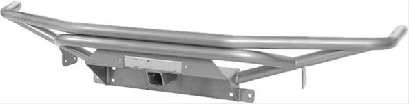

    LOL, are you willing to help me paint another bumper? I plan on getting this one soon... It's a direct bolt on, which is what I like and what I have been wanting and waiting for.
    I've always wanted to match my front with the rear.
    But yeah, thinking about getting this very soon. Just no exact date on getting it other than I would like to get it soon.

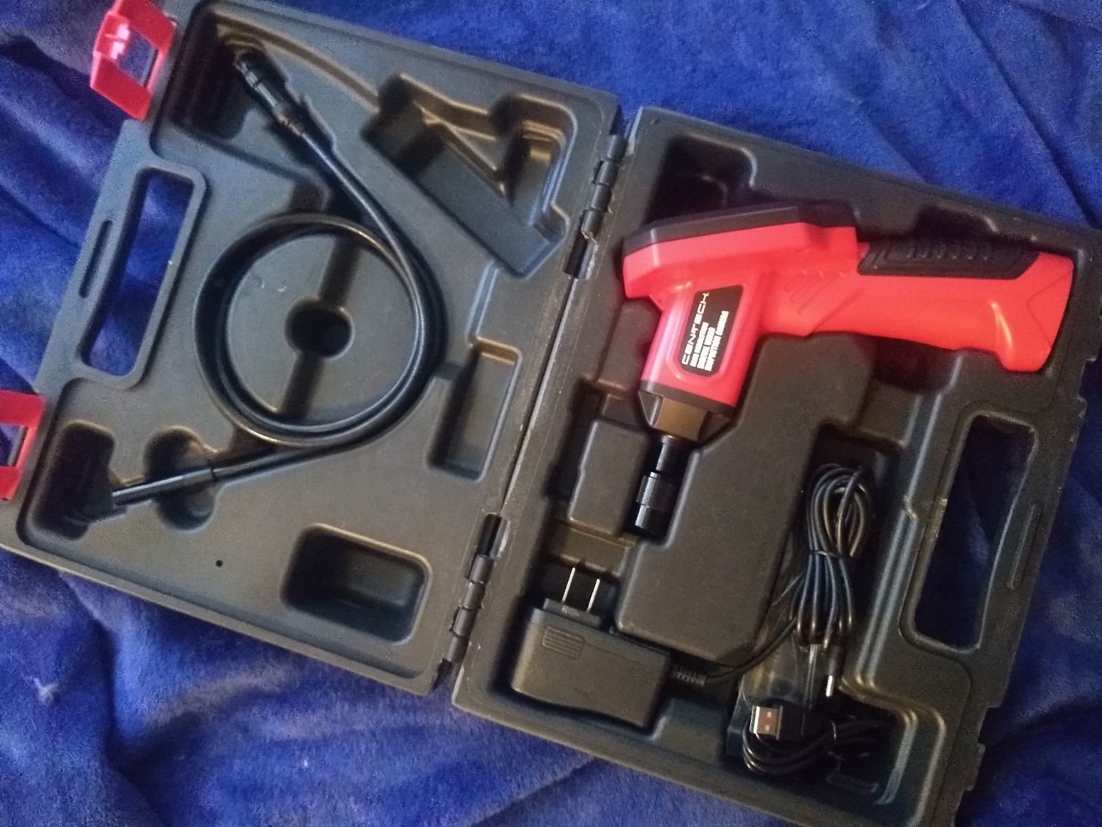

    I have a bore scope I bought a while back. It's actually a pretty decent bore scope, not that bad.
    When I get home from work today, I'm going to use the bore scope to see if I can find the other disconnected end. It SHOULD work as I expect it. At least I will be able to see where the other end is where it disconnected. Then I will have a better plan from there instead of just ripping the whole top end off.

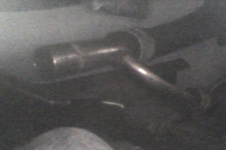

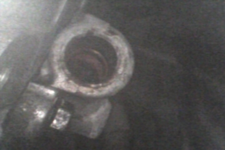

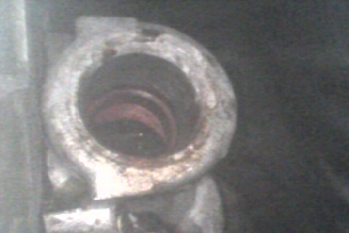

    Found the disconnected end with the bore scope. I figured the bore scope would help me be able to see what at least is going on.
    The bad news, it looks like the fitting itself somehow "broke"? You can tell it is missing some piece of some kind?
    I will have to tow it to the shop, which is better because they have better equipment and tools than what I have. They will likely have to pull the head anyways in order to fix it?
    I won't know until I talk to them?
    Here are the pictures from behind the engine. It is pretty well hidden too.
    Below is the metal t-type tube I was talking about earlier. Where the break is, it apparently comes out from behind the engine head lower-right corner and goes into the heater core.
    It actually looks like the metal tube was inside that housing??? I really don't know and it is hard to tell because of where it is located.
    In either case, to me it looks like they would have to pull the engine head to even get to it???
