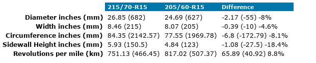

    MB makes 5 lug wheels in 3 or 4 different bolt patterns and a half dozen different backspacings.
    And 205/65-15?
    [​IMG][​IMG]
    Now, understanding that your speedometer is ALREADY about 6% fast, these tires will move that up by another 8%.... When your speedo reads 70 you'll be doing only 60, but you'll still be racking up 70 miles every hour on your odometer.
    Nice to know that when you blow past your warranty, you'll actually have fewer miles on the truck.

    Discount tire's site shows that the Alpina 15x7 5-lug (5x100/114) in 38mm backspacing will fit.
