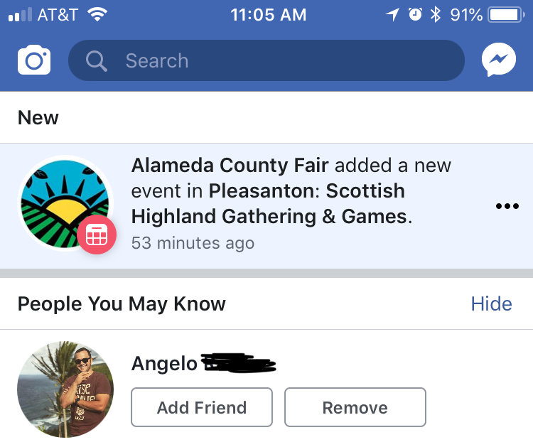

    @roguegs why are you invading my FB idk how they know but they do

    LOL instagram/facebook always has shit like that for me. I have no connections in common but how do they know that we know each other.

    I approve of the FacePlant ad for The Scottish Games on your feed(Caledonian Club of SF member since I was old enough to join.).

    @foxrcing07 actually - I think they are tracking our phone. A lot of these social media platforms are able to connect with people around them who are also using the same app. I know Venmo, Facebook, LinkedIn, etc all have that feature. So maybe they saw that we were all at the mod day for like 10 hours and were like "oh maybe they know each other"

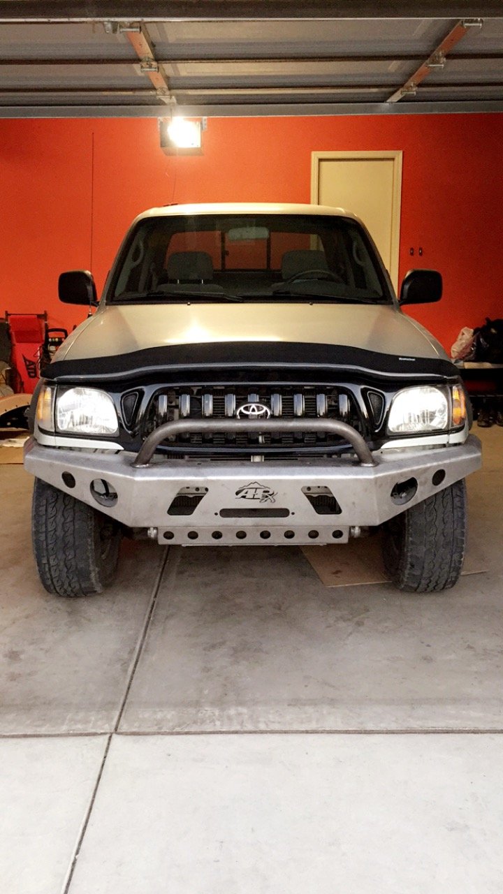

    Some more progress. Fitting the front was more work than I thought. Seems like the Tacoma had a small bumper accident in its history. Nothing major but I guess it made the reinforcement bar bracket off by a couple centimeters. Had to make some of the mounting holes on Apex bumper bigger. Die grinder with the carbide burr bit worked like a charm. Everything lined up great after that. Mounting the IFS skid plate was the most work. It wasn’t as straight forward as you would think and also it is not diff drop friendly. I talked to someone else who had the same setup as mine, same year and model Tacoma too that had the same problem with the skid plate. Had to use spacers and washers for the back two bolts. I had to make the mounting holes for the back two bolts larger too so it would line up properly. I’ll post pictures of those snags later. Tried to do the Trans plate as well but it looks like I’m going to run into the same issue because the back of the skid plate hangs a little lower for the diff drop. So I just left it off for another day. Took awhile because most of the wrenching was done by me. Didn’t have constant help but an extra set of hands is very recommended. If not than a hydraulic lift and jack stands are your best friend.
    On a side note. Does anyone know why my Tacoma is about a half inch lower on the front and back of the driver side compare to my passenger side?

    Do first gens suffer from taco lean?

    Not sure. Someone else mention it is the Taco lean that I am having. I’m going to do some research on it and see what I can come up with.

    That bumper looks bad ass!
    The driver lean is probably Taco lean. I don't know if the Dakar leaf springs are side specific. Ask @foxrcing07 or @Wheeler's Off-Road Inc if there is a specific side the leafs should be installed, they may have been put on the wrong sides. You have the trim packer up front, and it's on the correct (drivers) side. That is supposed to compensate some of the Taco lean but if the leafs are side specific, and not on the right side, that could be enough to cause the problem to be visible front and back.
