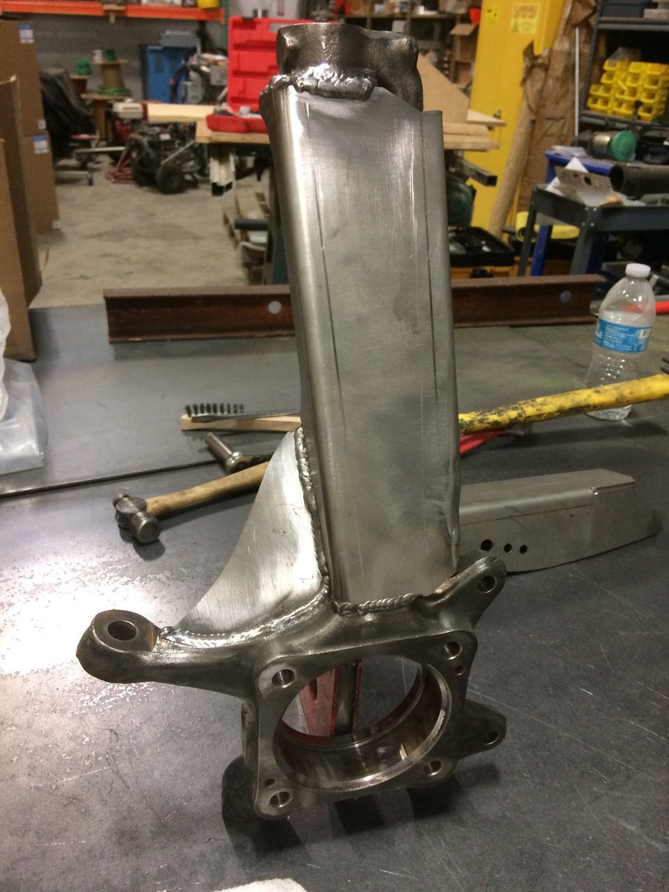

    Just remember to mock it up before welding, including your upper bj. If you are not using uniballs then you have to hog out the spacer/plate to make room for the bj castle nut.

    Those aren't the Total Chaos gussets I'm looking at... but they look pretty bad ass! I'd put those on my truck!

    I welded those up. I'd be glad to
    Fuck yours up too. I'm long travel and mine haven't broken yet.

    I'm not using uniballs. I'm using SPC UCAs so the ball joint is flipped.

    Mmmm, gusseted spindles. I love mine, makes me feel a little bit better about my spindles being stronger. When you look at stock and see that metal going up to the uca there isn’t much there.

    Dude... if that's your version of "fucked up"... you can fuck up my steering knuckles whenever you want.

    Are they off the truck and bearings out? Or is it your daily driver?

    I'm collecting parts for a 4x4 swap. I just bought a set of steering knuckles/spindles with manual hubs for the swap. So they are a spare set... not currently being used till I do the swap.

    Def get the extra triangle gusset (sway bar version) spindle gussets. I cracked my non sway bar TC gussets
