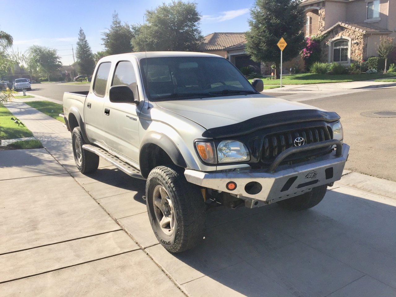

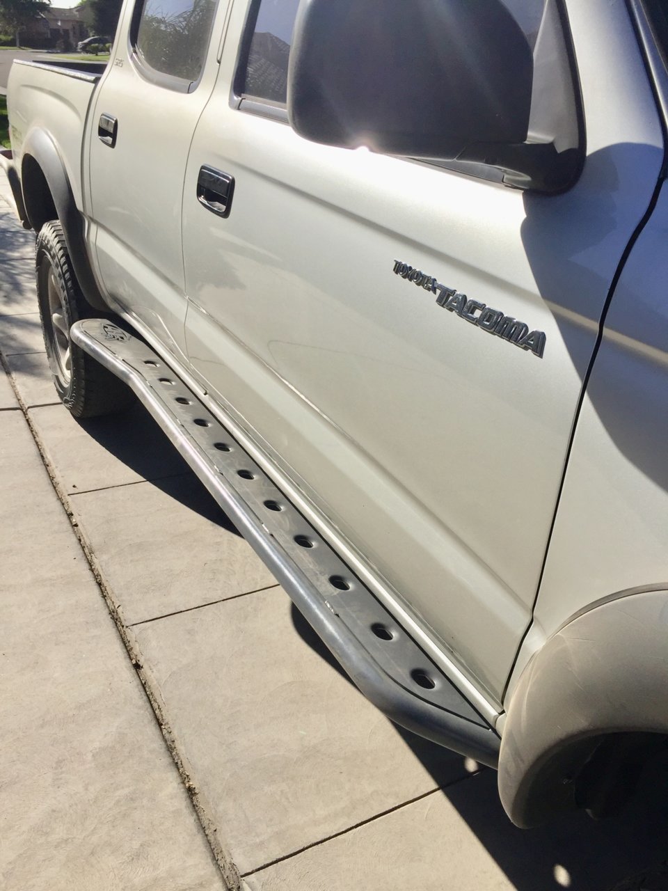

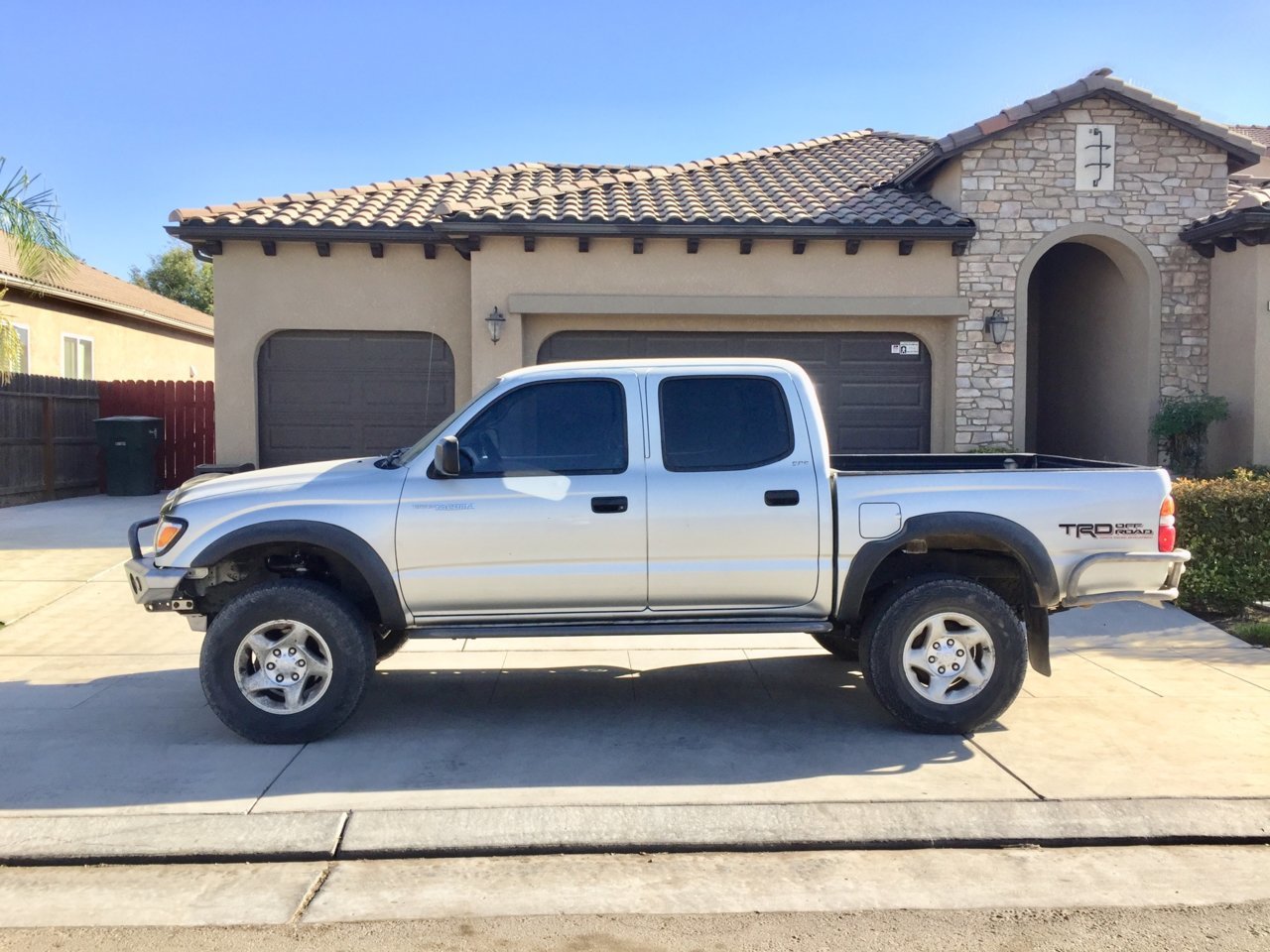

    Got the sliders welded on. Also changed out my 881 to 883 springs. I might be selling my 881 and Toytec 1/2” spacer w/extended bolts soon. Spacers are brand new and 881 has less than 500 miles on them.
    With the new 883 it raised the front up to 1” so now I only have 1” of rake in the rear. Had my gf sit on my front bumper and it only brought it down no more than 1/2” so I know when I have a winch on there it will probably only go down 1/4” or less. From ground to bottom fender 37” front and 38” rear. Still have about 1/2” of lean on driver side. I did take it for a drive around town and maybe I need to drive it more but it actually feels the same or better compare to the 881.
