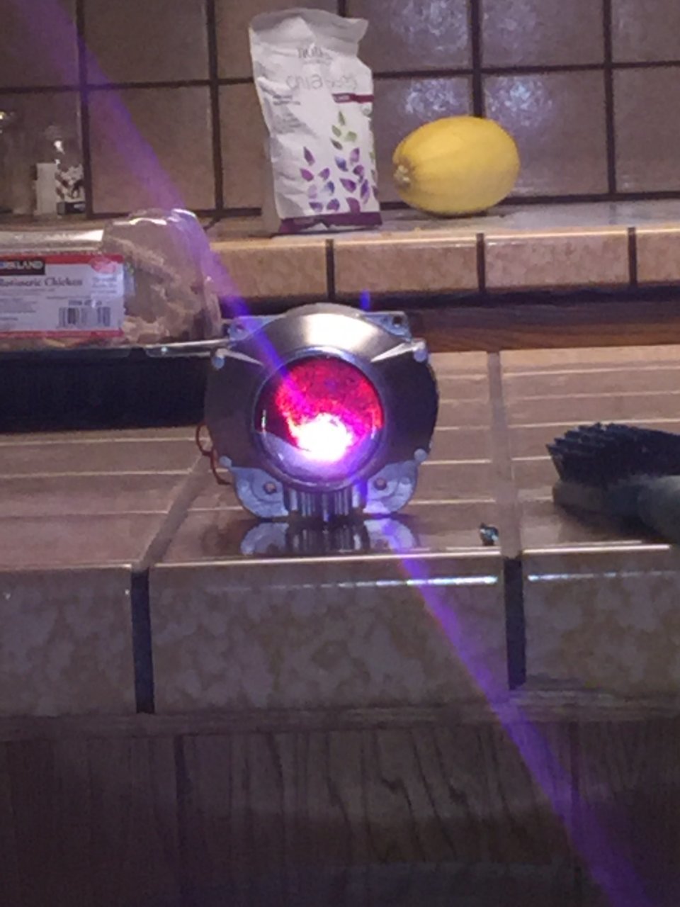

    @Uphillshunter This is what my demon eye looks like. I was shining a flashlight at the projector

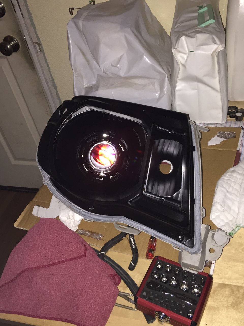

    getting closer to final product

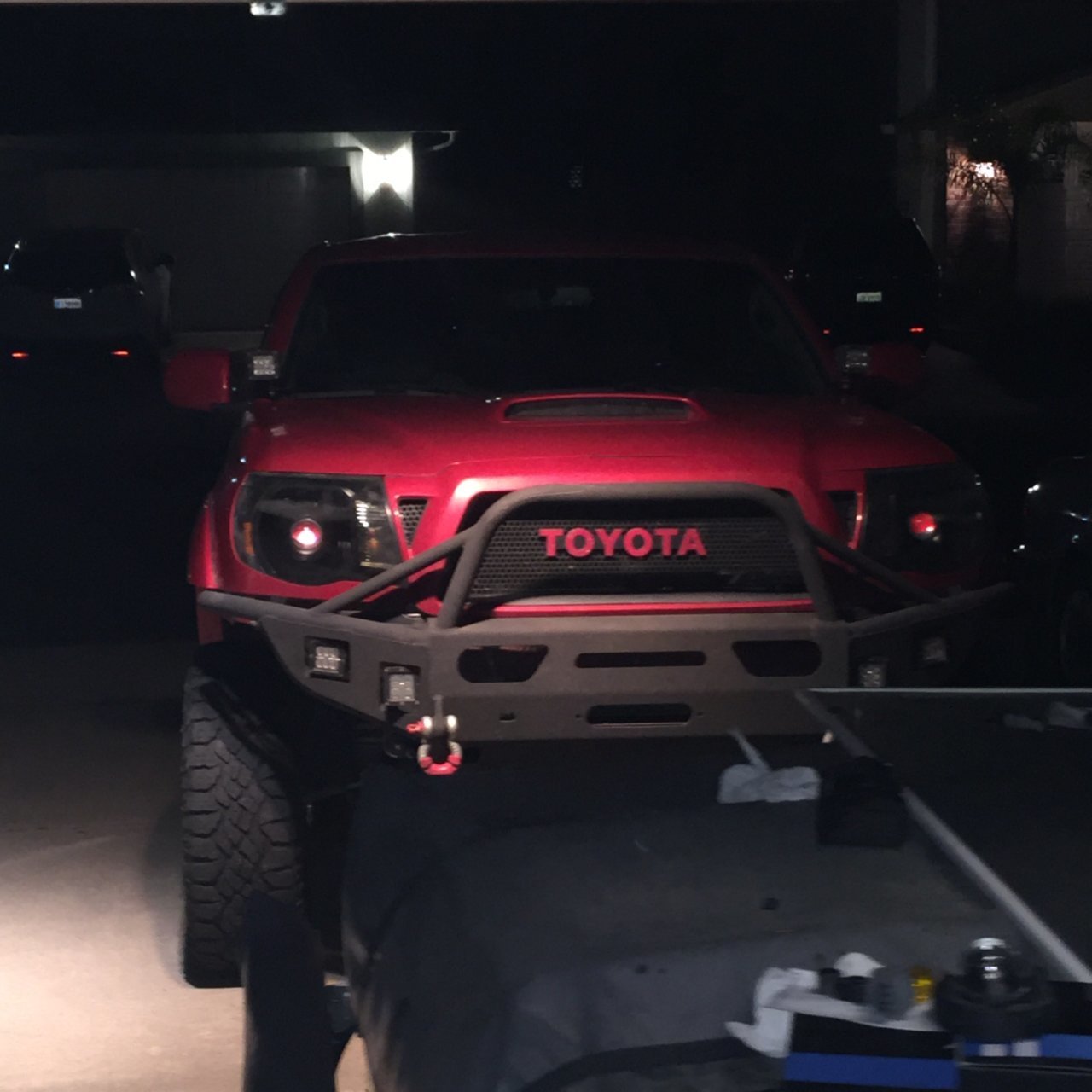

    On the truck and when you could see my lights. I was shining the flashlight from the back of the garage

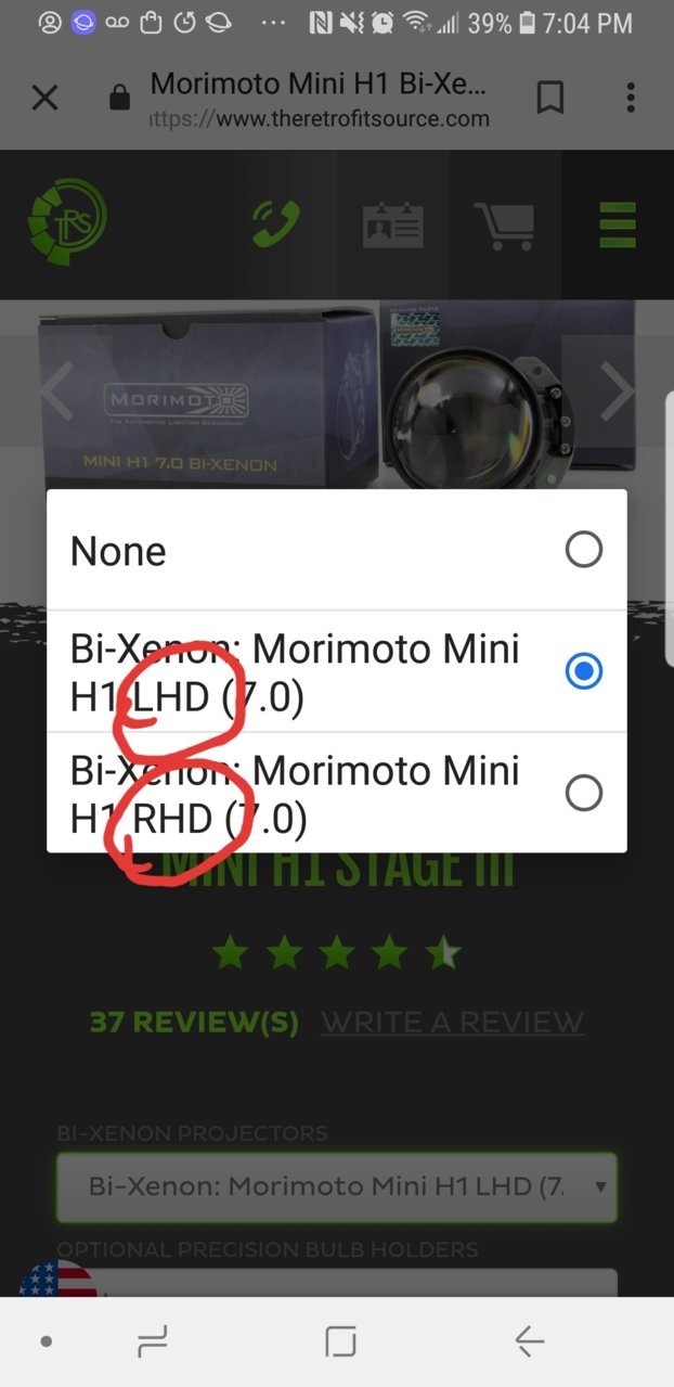

    Can anyone tell me what the difference is?
    All I can think of is left hsnd drive / right hand drive... but can't see how that would matter.

    Maybe left high def and right high def?

    https://www.theretrofitsource.com/blog/headlight-tech-hid-projectors/
    Read about half way down
    Edit: screw it I copied it
    LHT vs. RHT:
    If you live in a country where the standard is LHD (left hand drive) then you need to use a projector with a beam pattern compatible with your traffic pattern. The step in the beam pattern will go up and to the right. In North America where LHD is the standard, the step in the beam pattern goes up and to the right. In countries like Australia, the UK, and India where the standard is RHD, the beam pattern from the headlights will be lower on the right, higher on the left. What’s the point? On the side of oncoming traffic, your beam will be lower so you don’t blind them. On the side directly in front of your car, your headlight beam will shine further down the road.

    Well dang... it does make a difference. I figured that would all go in to the adjustment of the headlights when you install them.
