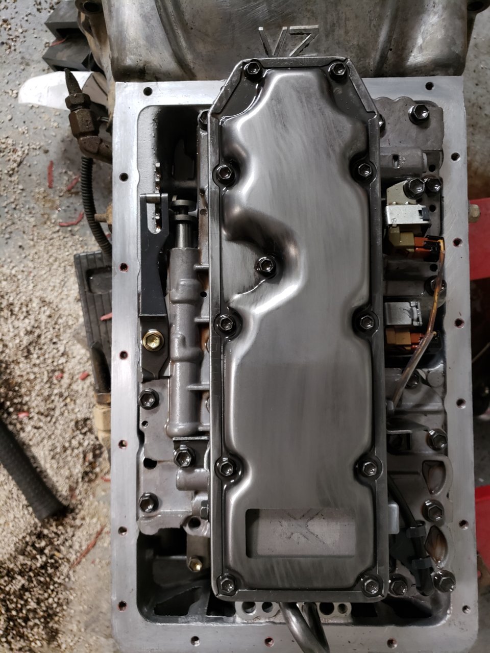

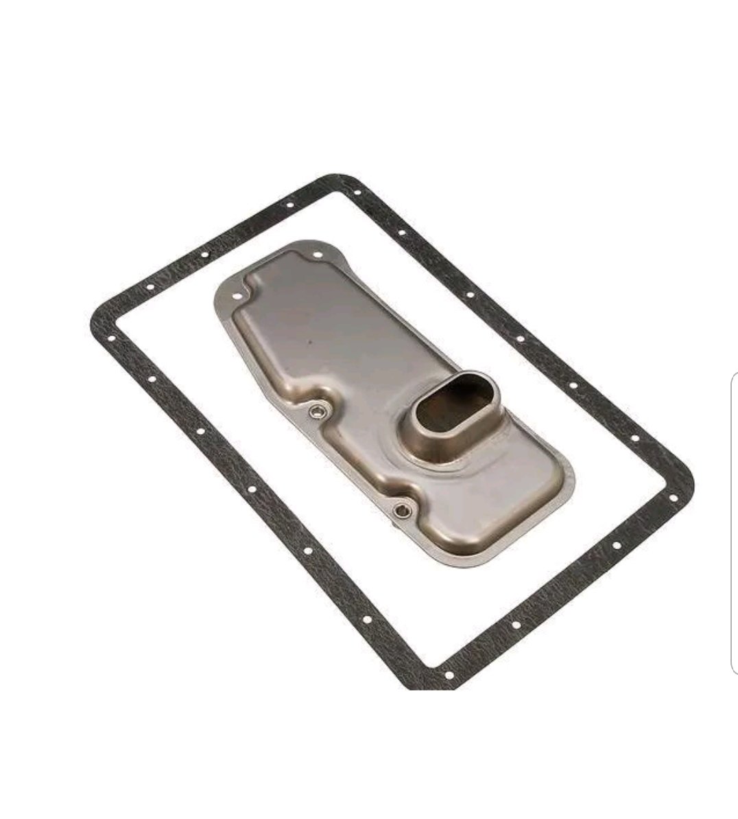

    Ok... I'll go to Toyota tomorrow.
    How bout the filter. The only OEM filters I can find listed (for A340F) look like this.
    This is the filter I'm trying to replace.
    Apparently there are multiple filters that have been used for the A340F. The only filter I can find that actually looks like mine is Wix
    https://www.summitracing.com/parts/wix-58884/
    Should I just go with the Wix? Is it even worth doing an OEM?

    No idea. Only autos I own are on newer toyotas that dont have replaceable filters.
    Wix has always been good quality.
