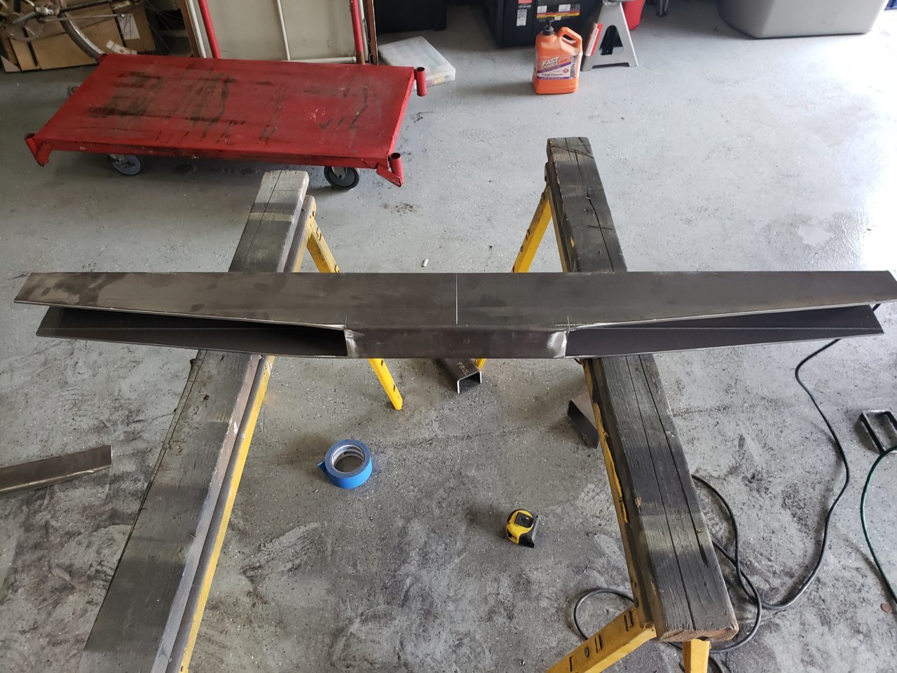

    Cut to length
    Laid out
    The pain in the ass cuts are done.

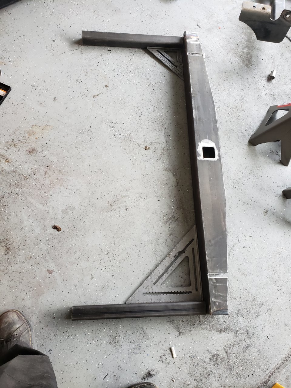

    Made some re-inforcement for the back side of the bumper around the receiver.

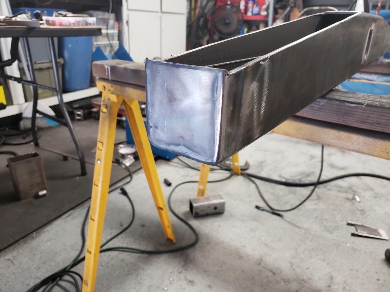

    End caps done ✔️

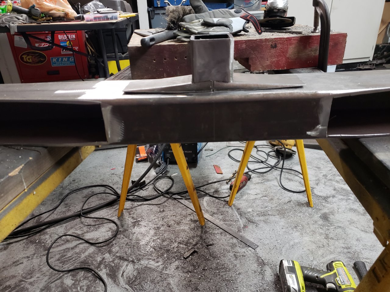

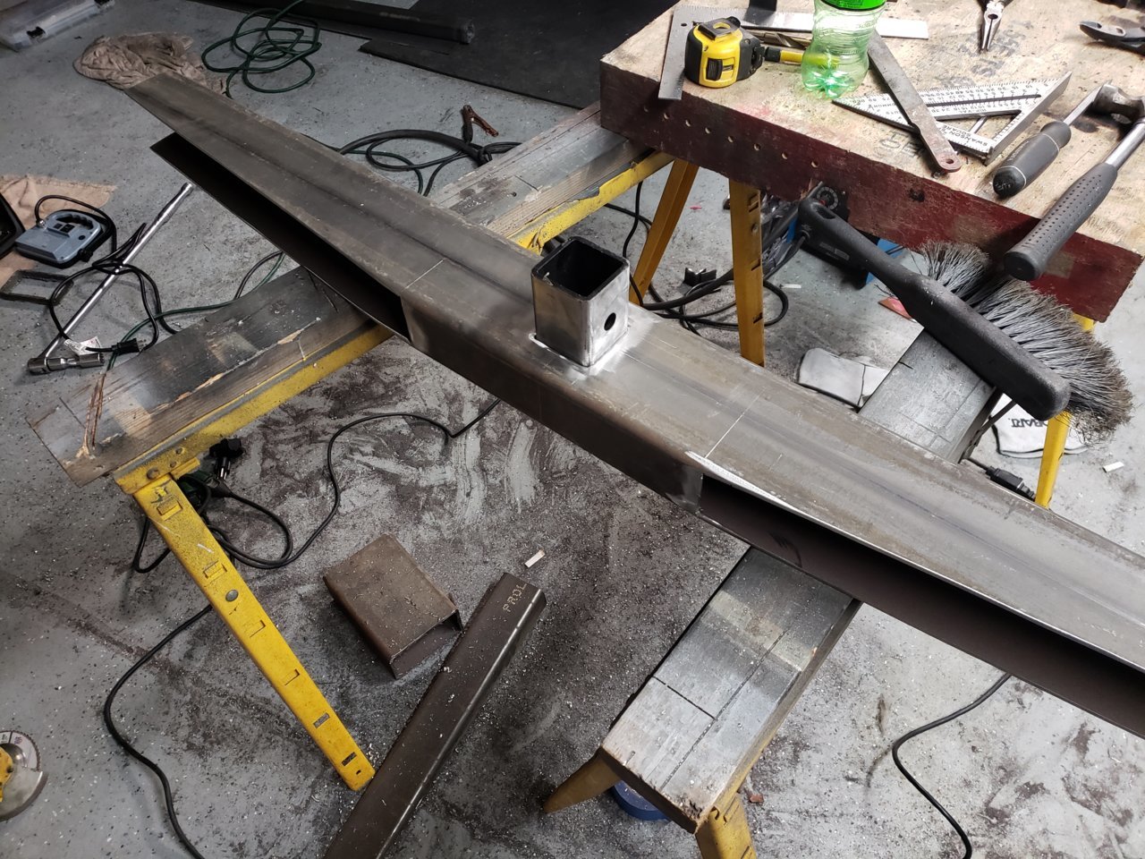

    Mocked up the bumper and got the measurements for the slots that will saddle the frame brackets. (Frame brackets will be 3 inch x 1/2 bar stock)
    Also cut the posts for the swing out.
    Posts are notched so the back side can be a full weld all the way down the back of the bumper.
    Pretty sure the posts aren't going to sag.

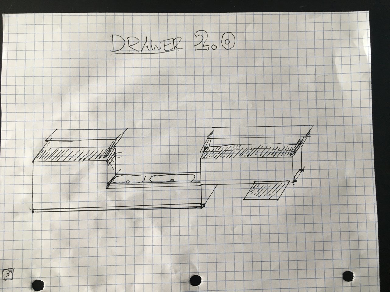

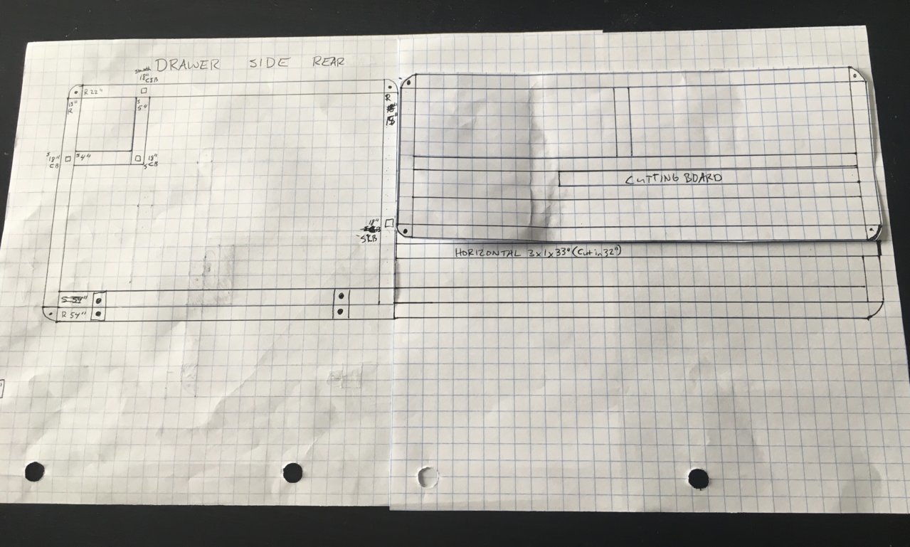

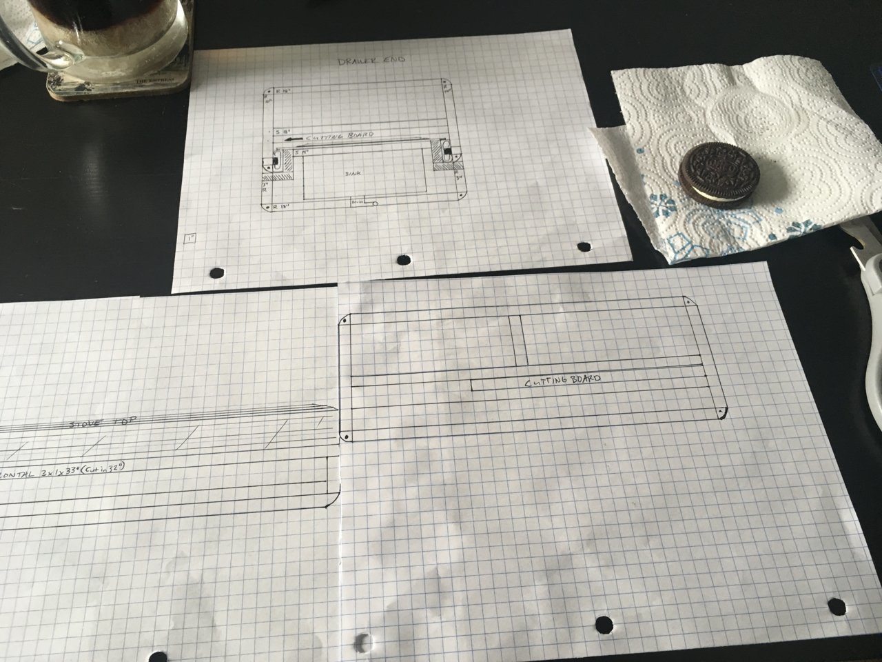

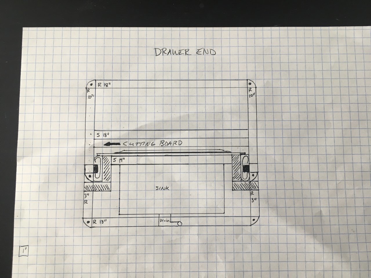

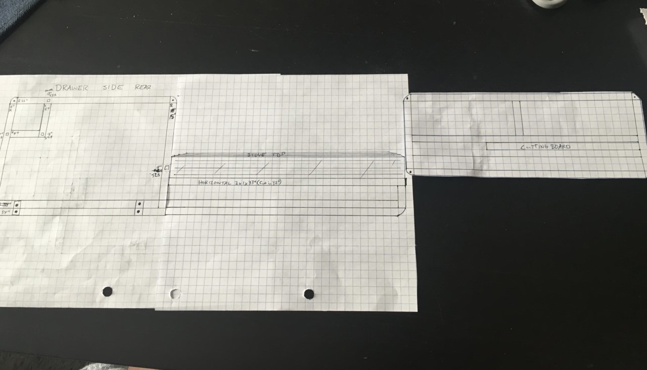

    Working on plans for my next project, powered by my brain food
    88C98474-31F8-4AD9-8276-D8947EACC04D.jpg 4CC99FEB-4FC7-48D6-9486-68B8554298A4.jpg
    rob1208 and CalTacoma09 like this.
  14. Mar 4, 2019 at 2:26 PM
    #4154
    Papadave418
    Papadave418 Well-Known Member
    Jul 17, 2017
    #224251
    1,938
    The drawer looks like this when closed, then an upper set of locking drawer slides will open the upper section to reveal the cooktop and sink. The whole drawer system is 56” and will slide out on full extension sliders, then the upper storage slides out as well
    23B380C2-2E93-4FE8-813A-0C452AD98275.jpg 9C744DED-96D0-40E0-B3E0-4B42E531AE64.jpg
    I bought this cooktop and sink which is hugely popular over in Europe for its compact size and utility. But they are really hard to find here
    The end cut shows how the sliders work on the inside of the storage compartment, kind of like the monorail at Disneyland

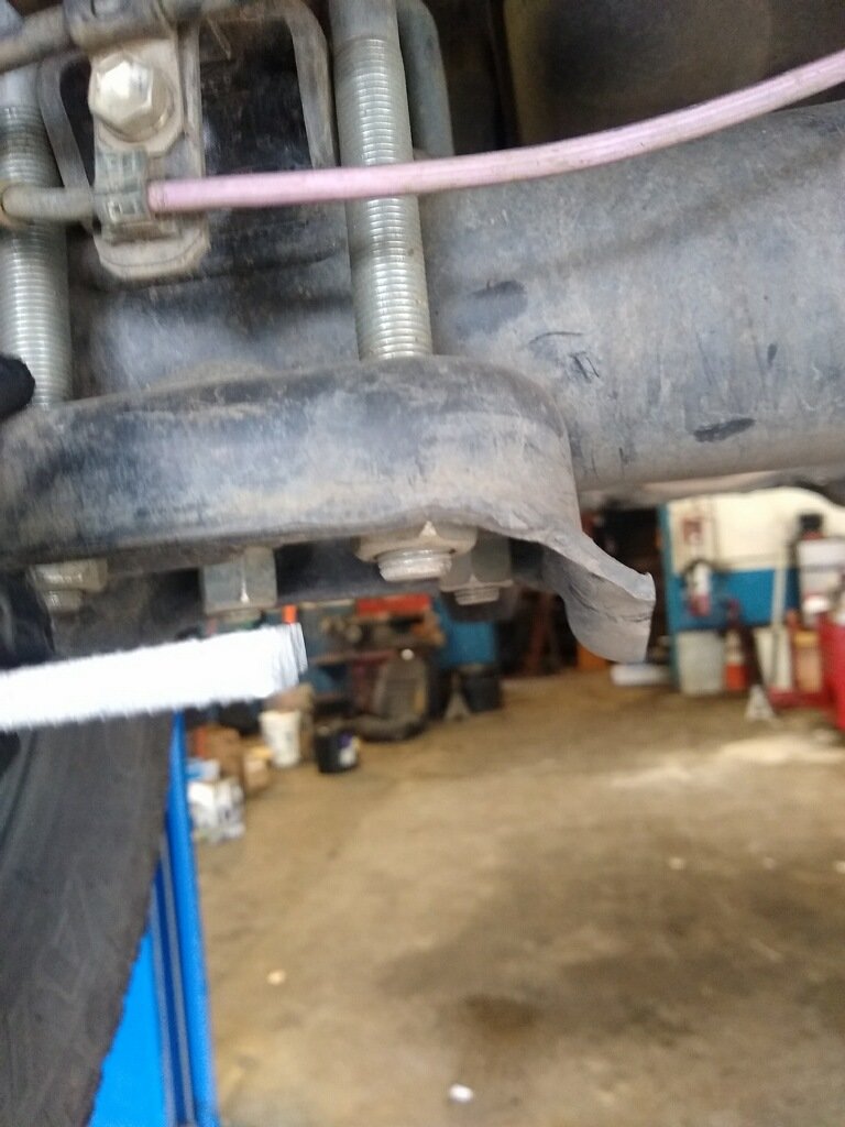

    I need longer you bolts to get my shims on. What would you guys recommend?703ABEB9-2D78-483B-A180-315B228773B8.jpg

    First, I recommend a ubolt flip kit from wheelers. Then just go ahead and add new wheelers rear superbumps.
    :D
  17. Mar 5, 2019 at 12:27 PM
    #4157
    Twizted
    Twizted 1GR FE
    Jun 20, 2014
    #132313
    8,611
    Rob
    America
    '15 DCLB TRD Locked 4WD & '17 Tundra DC SR5 TRD Offroad
    stock af, but hover if you think you disagree... RV living: Vagabond Drifter (6' bed) Custom bed cabinet buildout 175w Renogy solar panel 40a Rich Solar MPPT solar controller 1000w Wagan Pure Line inverter Lavaner Pro 2kw diesel heat exchanger Suspension/wheels: Toytec Aluma 2.5 front shocks with resis 13x700 coils (soon 14x700) Toytec Aluma 2.5 rear shocks SPC UCAs Deaver Stage 3 rear leaf springs Wheeler's 3 degree axle shims Wheeler's U-bolt flip Wheeler's Super Bumpstops 18"x9" XD Monster (x5) 275/75/18 Cooper ST MAXX (x5) EBC Stage 3 pads/rotors Electronics: Kenwood DNX773S iDatalink - Maestro RR Stubby Antenna No-name Switchback LEDs Hella Sharptone horns (no relay) Relocated backup camera w/DIY bracket Armor/recovery: BruteForceFab Rear HC w/swingout BAMF Sliders (DOM, 10 degree w/kick out, rattle-canned) BAMF IFS Skid (BAMF powder-coated) BAMF Mid Skid (BAMF powder-coated) BAMF TC Skid (BAMF powder-coated) BAMF LCA Skids (BAMF powder-coated) BAMF Rear Diff Skid (early model, powder-coated) BAMF CMC Plates US Offroad Winch Bumper Smittybilt X20 10k synthetic rope winch Total Chaos Bed Stiffeners ARB compressor w/air-up kit DIY cowl snorkel ARB rear air-locker Interior: Husky Floor Liners (F&R) Rear 40% seat-delete Hinged fridge platform in place of rear seat Exterior: CaliRaised Low-profile Ditch Light Brackets CaliRaised Side-projecting LED pods CaliRaised Faux TRD Pro Grille Morimoto amber LED fog lights One-of-a-kind 1GRFE plate (second iteration) Removed: OEM Bed Mat CaliRaised bed molle panels
    I second this.

    Thirdsies.

    Super bumps huh. Suuuuper. Are they super?

    Yep me four!
