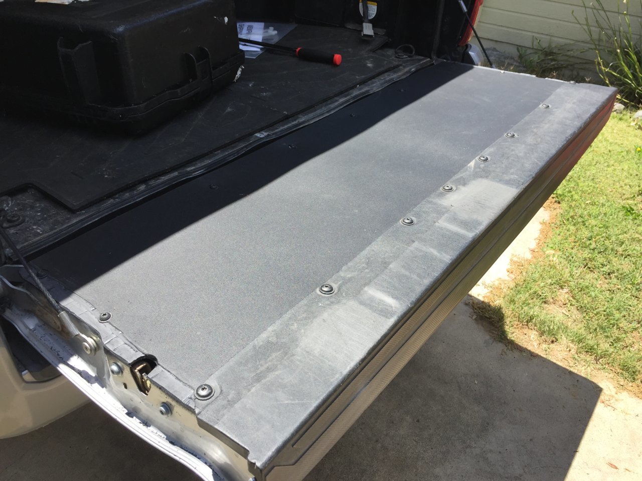

    Simple mod, looked at the mountain hatch and mobtown tail gate options, but they are over $200. This is 1/4” HDPE from Tap Plastics which was $54. Took me longer than expected to install as I only had a little finish router as it wouldn’t close with a 1/4” thickness on the edges. But looks good enough and saves my knees when I’m crawling up

    Do you think 1/4" is sufficient? Seeing as how the retail parts are like 1/2".
    Asking because I have some spare 3/16" ABS (even thinner than yours) that I am considering making one from.

    When I push down on the sections in between the supports it barely moves. I figured if I break it, well it was only $54 and my effort. 1/2” would be very strong (kinda heavy too) but the sides you have to shave down to about 3/16”. So I say try it

    Stock thickness is about 3/16” but it’s been molded and shaped for strength, and to bust knee caps. The aftermarket ones are 1/2” in the middle but thin on the sides as the clearance closing is minimal

    I'll give it a shot with the 3/16" then, thanks!

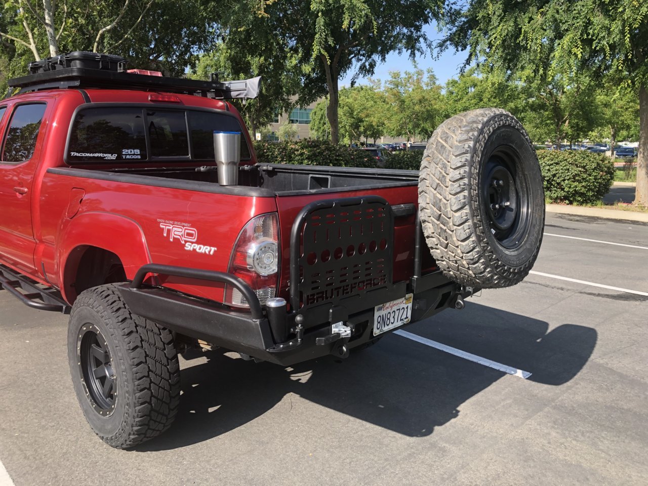

    Finished the swing outs yesterday.
    B117CBC3-9204-488D-8F20-5588568F9160.jpg 171CA400-AC86-495A-B90E-1E753BD7FA3B.jpg
    Need to get lug nuts and the spare tire mounted on the scs wheel.

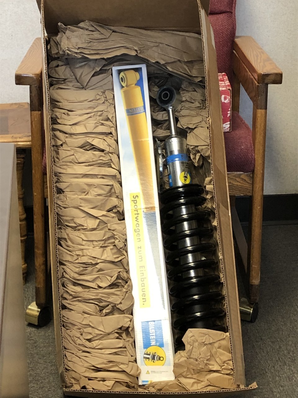

    Brown truck dropped off some stuff26AC188F-DAF5-4E24-9FB5-5A31458E5C85.jpg, but not the AAL :mad:
