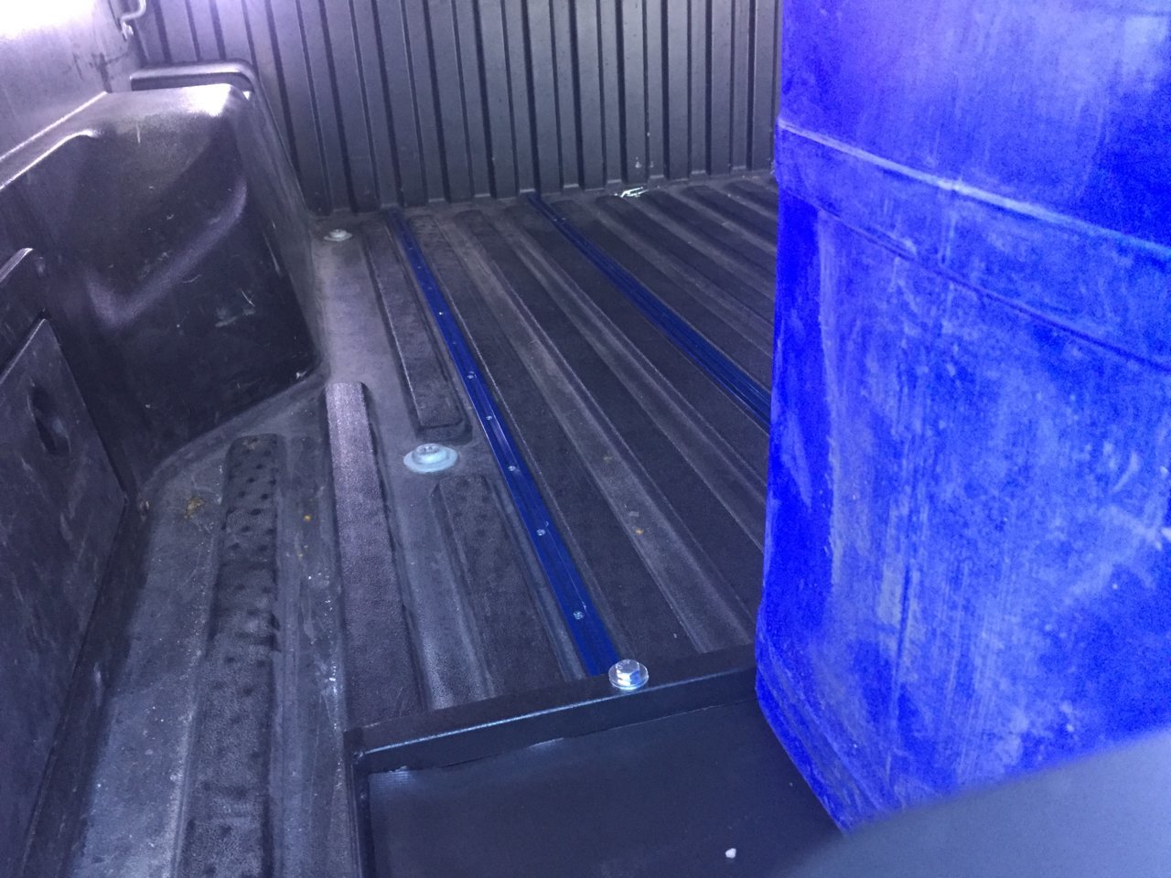

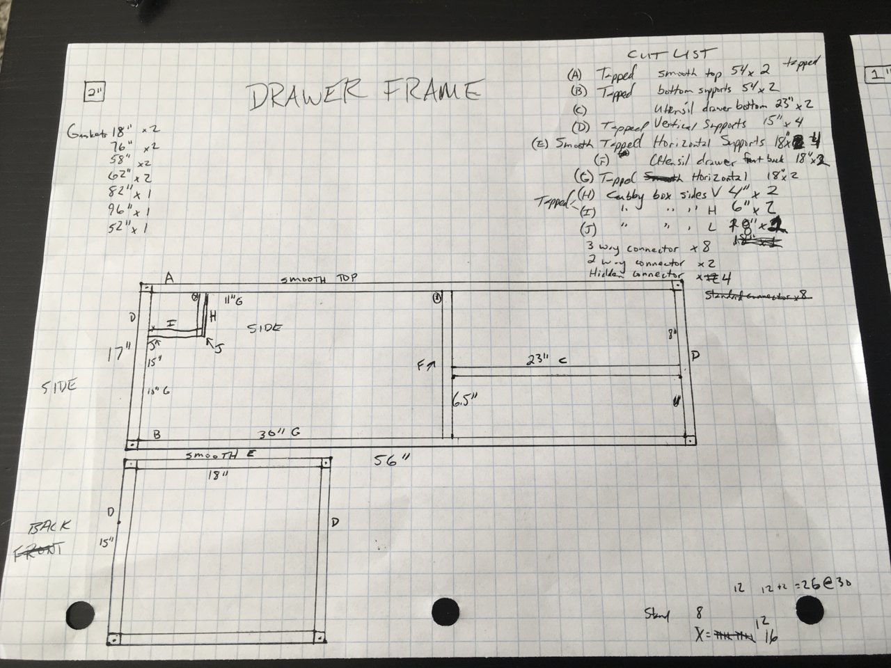

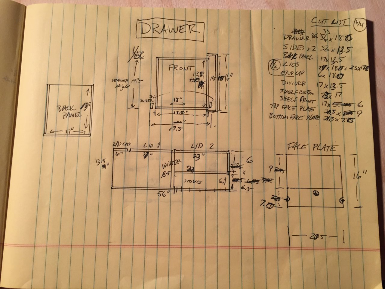

    Seriously though I’ve got wood drawer plans, 80/20 drawer plans like my wood drawer, and my new fancy drawer plans with parts lists. They are sized to fit under a tonneau and for 5’ beds. Hit me up if you want me to send them to you.

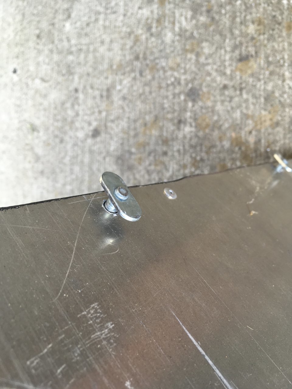

    I don’t really have plans for the fridge slide, it really is just angle iron welded together with aluminum riveted to the bottom. I used two C channel guides that are meant for table saws and anchored them to the bed. 1/4” t slot nuts hold the slide in when you extend it. My fridge just barely clears the tonneau so I couldn’t use a standard fridge slide. I like it though cuz it’s long and I put gear in front of the fridge.
    F301F5E3-D17A-40A9-BCCB-481B973497CB.jpg 21C69FD9-2129-4FA2-B605-A7A7524ADAA7.jpg 9929E78C-6C4C-4D16-8EBB-4B5A5399BC11.jpg
