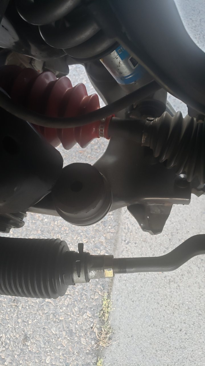

    I actually just bought OEM LBJs already and they are being shipped out. Tie rods I think were replaced at 180K miles or so

    It's possible... we already did it on Robert's T4R

    Get bolts too?
    With front sway bar? Not that it matters for me since I’m not running any but just curious on the matter.
    Also, kind of surprised this isn’t something that is done more often. I didn’t even know about it until you just now

    We haven't put the sway bar back on yet. But it doesn't look like it'll be a problem. If anything, the Taco OTRE's shape gives more room.

    Hmm, I’ve been wanting to throw in a new set of LBJs soon. You’ve got me thinking big time

    I don't see why Toyota even did the 2 different set ups... or why everyone doesn't do this swap. The ITREs are the same for both. The OTREs thread right on... and the spindle is the same, so the LBJs bolt right on to it.
    Taco LBJs suck... but not half as bad as T4R LBJs.

    yessir got 8 fresh bolts ready to go

    Not sure where I even got the idea then... but it works, and it's been aligned with no issues.

    @MattJakobs ... I'm looking around and others have done it. Some say you'll lose turning radius... bullshit... Robert's T4R can turn a circle inside the circle I can turn in my Double Cab. I don't see how it could turn a tighter radius than it does now.

    I don’t have steering stops so I wonder what it’d do to mine. I’m assuming I’d have the same steering amount until the LBJ hits the LCA
