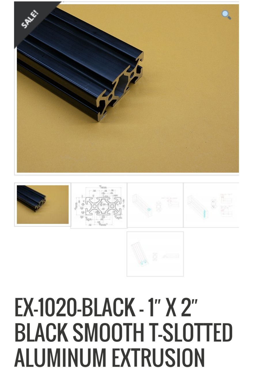

    Correct me if I'm wrong. This is the profile of Prinsu crossbars. Correct?
    And I don't think the Prinsu outside plates (the plates that run front to back, that the cross bars bolt to) are 1/4. I seem to remember them being 3/16th max... maybe 1/8th.

    Yea I believe it’s the 1x2” I can double check when I get home

    1,938
    That’s it. Maybe 3/16th or a touch thinner. If you know someone with a CNC machine they could cut out a design for you
