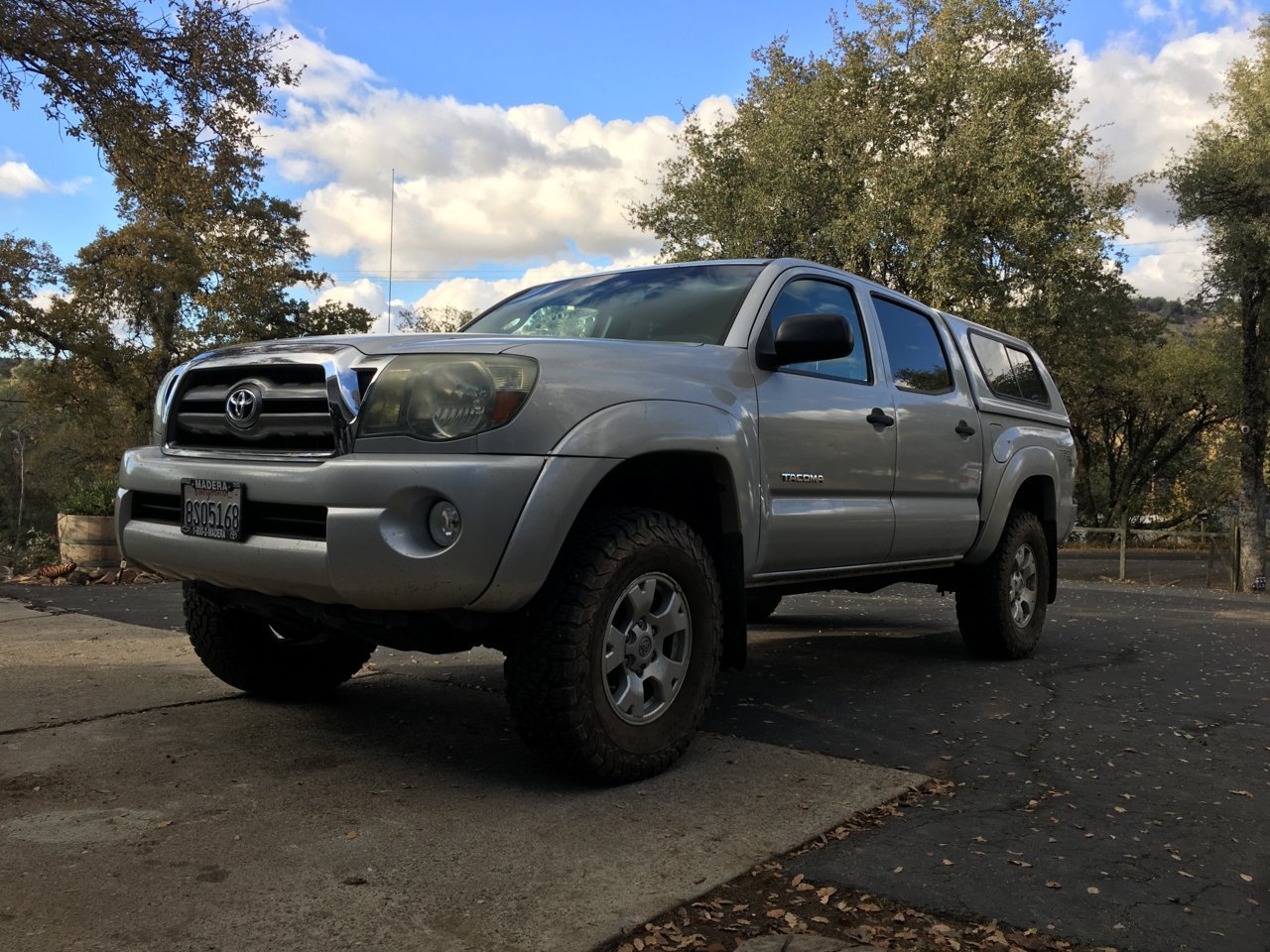

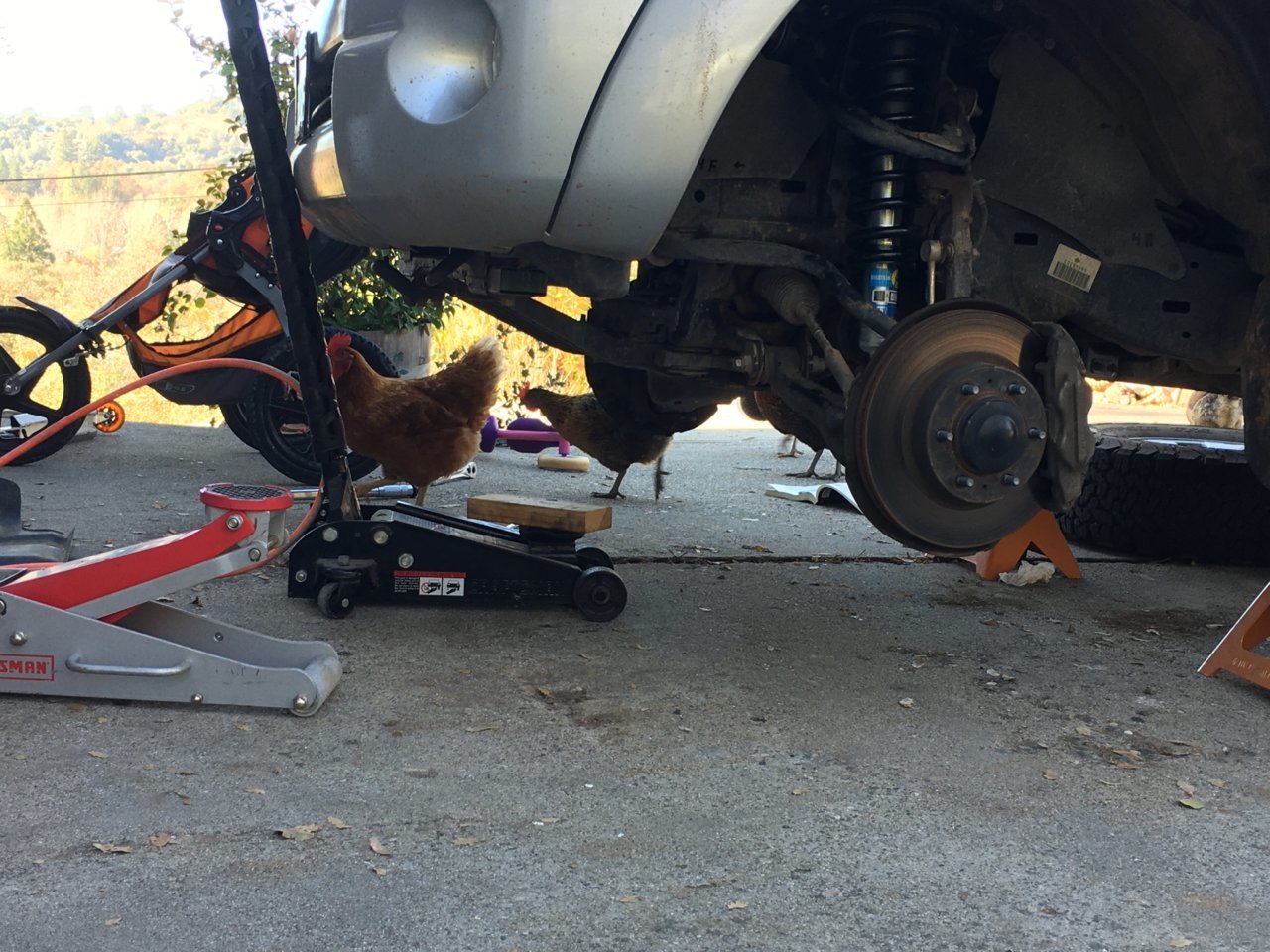

    And finished! Rear springs went really good...did the easy 5100 install I’ve seen here on TW. Fought it for a while last night, and when I quit realized I had the spring seat on upside down . By that point I had the front end all apart and ended up taking the springs to a local shop to get assembled, and finished the install today.61750BBF-8E5F-427D-B81D-854E896349E4.jpg My helper taking the front end apart last night.
    224857EC-EDB7-4CCA-B407-0EE9AAFA14AE.jpg Today’s not so helpful helpers!
    5248C24C-E332-4A8B-BBEF-B8758F9CC562.jpg Finished product
    Alignment scheduled for Saturday...pretty happy so far!
