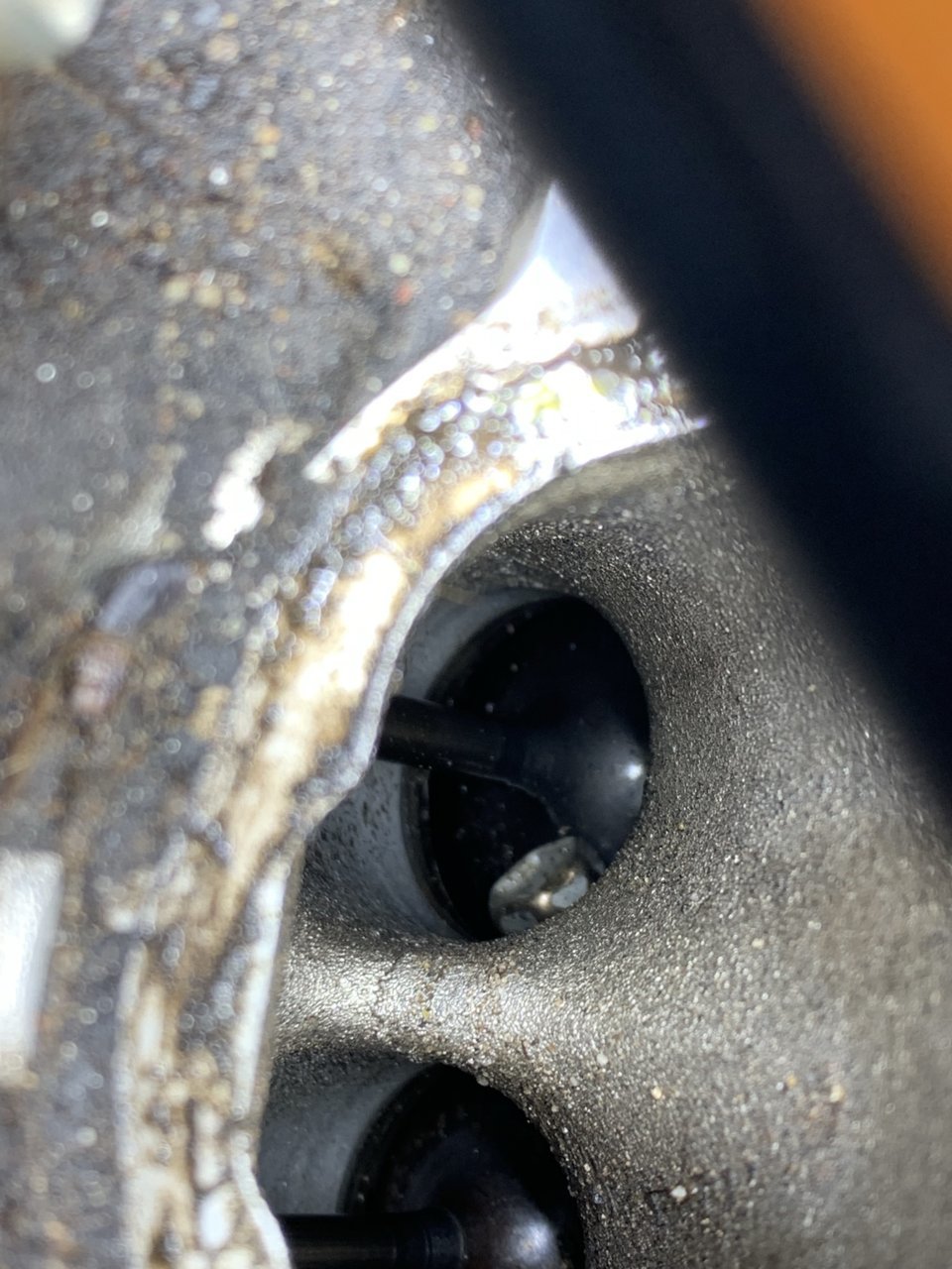

    So I was working on the 4Runner I bought with a dead cylinder and I think I have found the problem,
    I don't think this valve bolt is torqued to spec.
    This is the intake valve in the zero compression cylinder, the valve doesn't open far enough to let the bolt fall all the way in,
    So it just sat there not allowing the valve to close.
