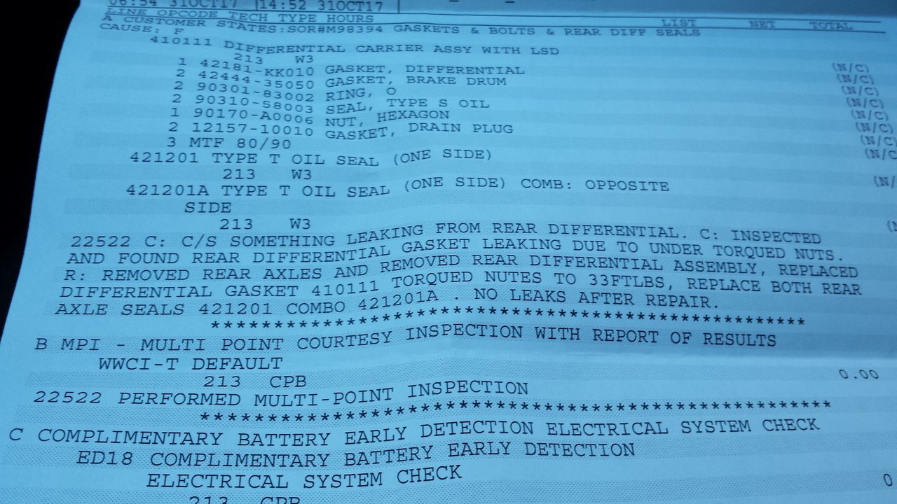

    Job complete, below is the work order including list of parts.
