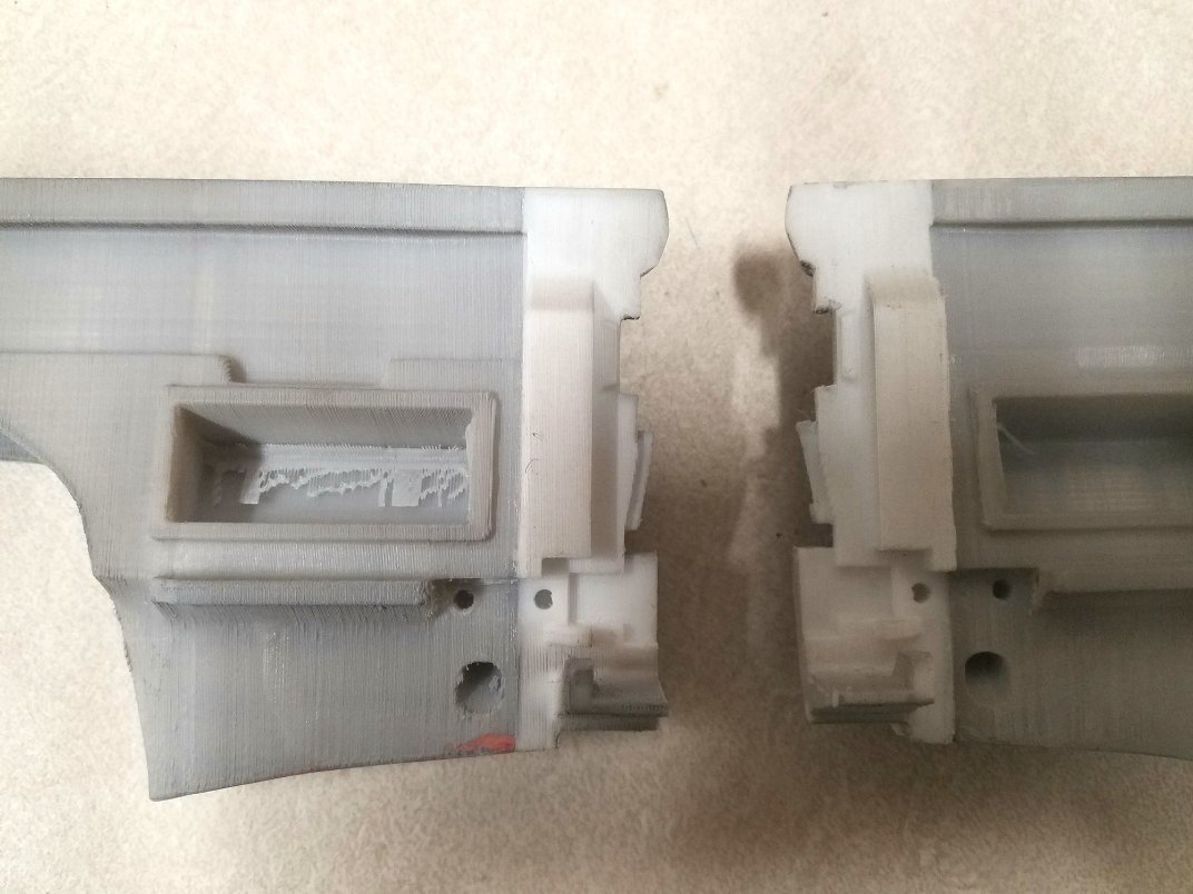

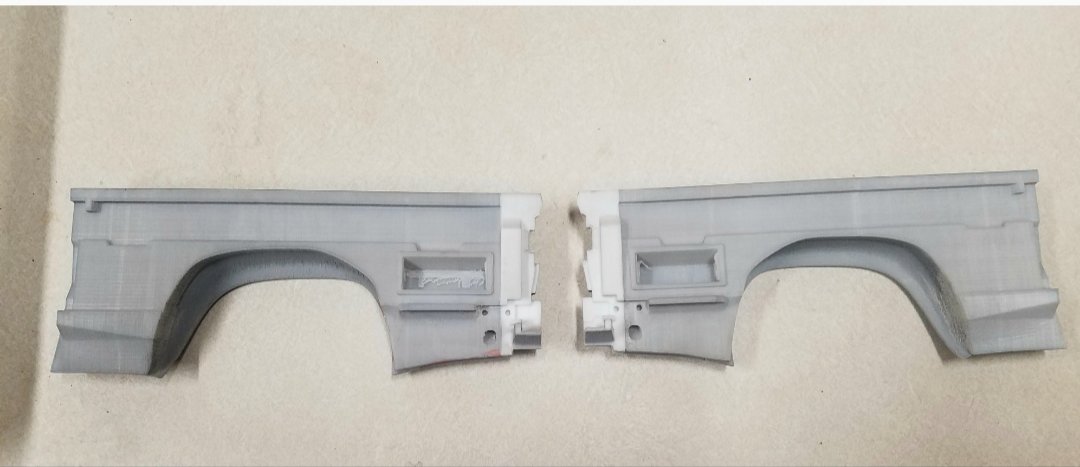

    Since this is my 1st time building these I decided to start with the bed since it appears easier. Bed structure consists of 19 pieces plus 4 tail light parts. The bed sides are 2 pieces. This is to allow easier printing of the holes for wiring lights. Getting the parts lined up to avoid a seam is crucial. Then fill any gaps, remove and/or fill printer lines on the outside body panels. I'm not doing the inside of the bed or underside. It will be done with bedliner later. Here are the 2 pieces joined. You can tell since they are different colors.

    ABS? If so, you can do an acetone bath:
    I have done it similarly with a paint can. You use magnets to hold a paper towel to the inside of the can and swish some acetone on to it. Just enough to wet the towel. Place the part on the lid and put the can over top. You don't want anything touching the parts. Comes out smooth.

    I'll have to check with maker. Since these are thin hollow parts that need a lot of sharp edges not sure it would work well. But love the idea.

    You can hang them on a wire. Also, you can do it a couple times or for a short time. Lots of possibilities.
    ABS will soften in the bath / vaper wash but will harden back up like new.
    Asking the maker is a good idea. Other than a go / no-go, they may have good recommendations.
