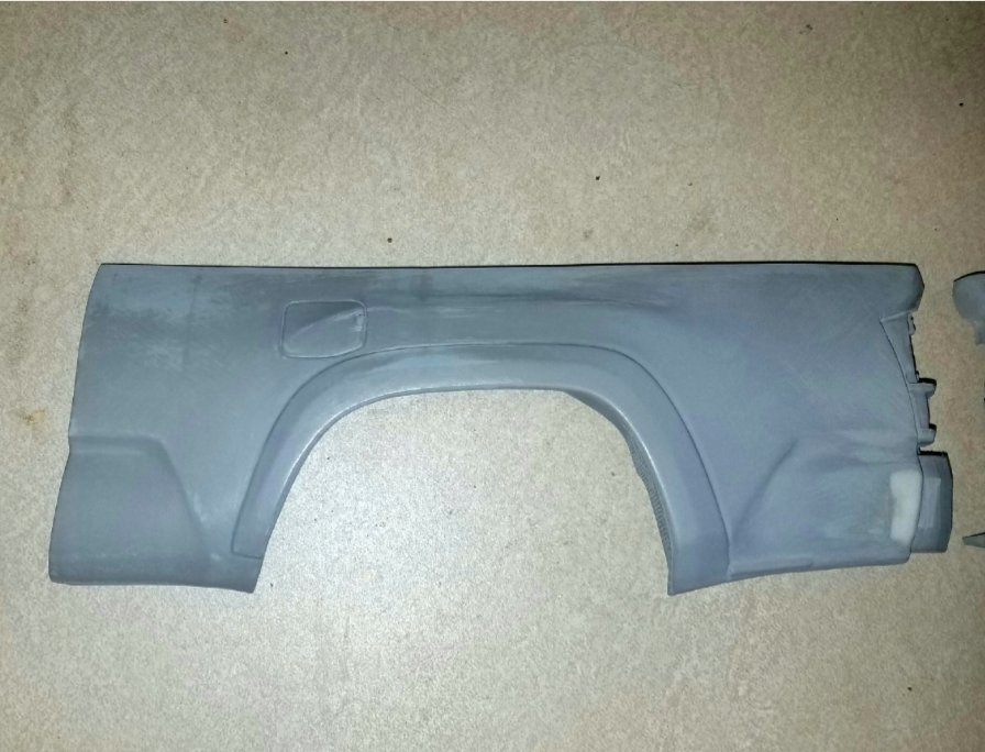

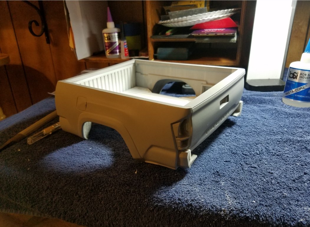

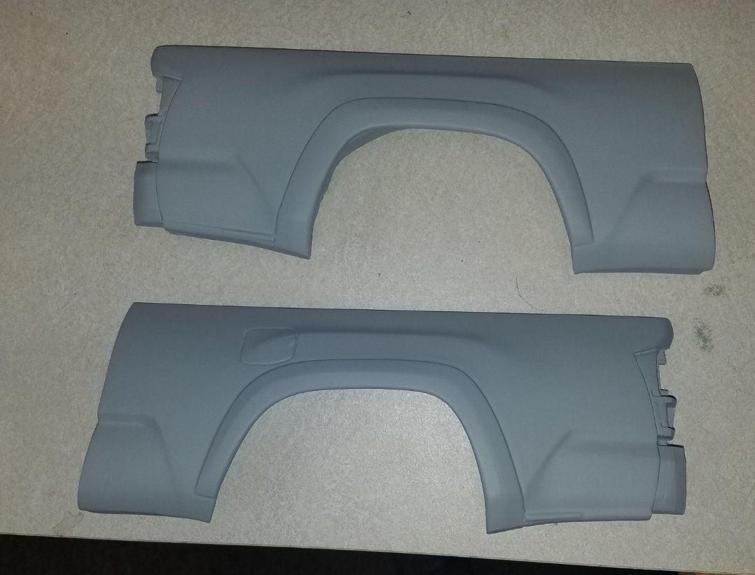

    So after the sides were glued together and all the seams filled it was time to sand, prime and repeat to smooth out printer lines and seams. After a few cycles I was getting close. Since parts are a little small for a guide coat I used a different color primer to find low spots which you can see it this pic.
    Then a semi final coat. After complete assembly I will fix any scratches, wet sand then paint. Took a bit of work but turned out pretty good IMO. :notsure:
    Hopefully I can get most of the bed assembly done this weekend.

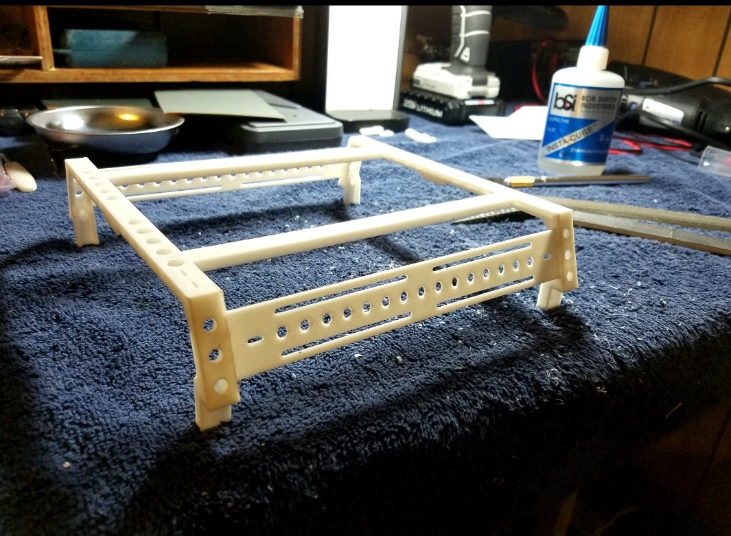

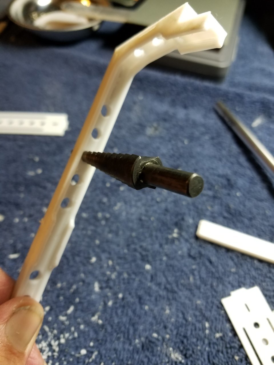

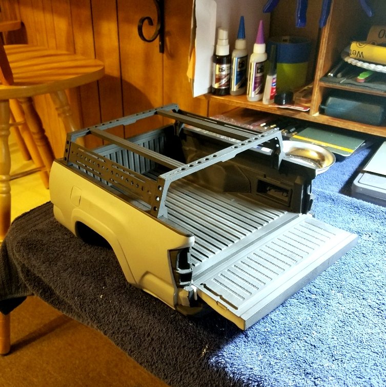

    Hopefully I can get the bed assembled today. Started out working on bedrack. Lots of printer slag, if that's what it's called, in all the holes. Cleaned them all out using a small step drill. Didn't want to go too far using a drill so I just used my fingers to spin it for better control.

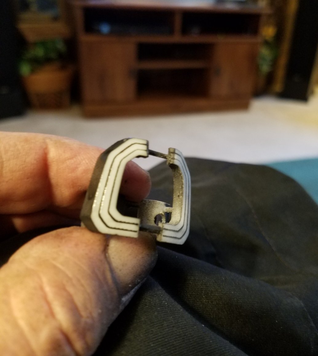

    BTLM of inner lense. Now gotta see if @MESO can fit 200 leds on there. Lol:eek:

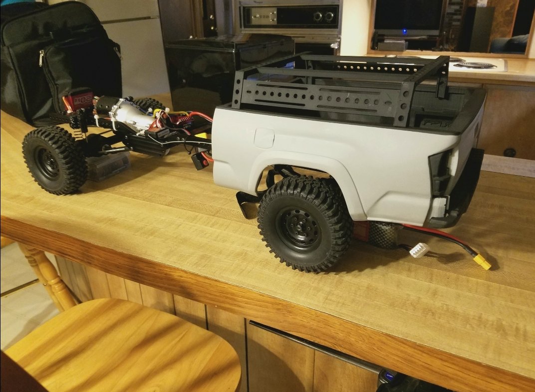

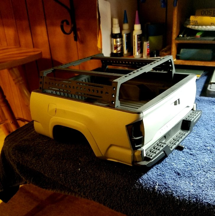

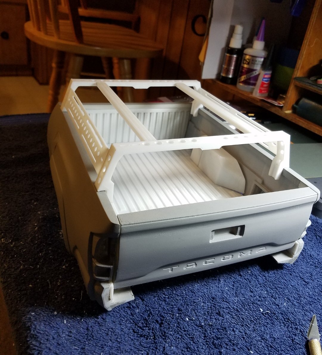

    Most of the bed and rack are done. Still have some small pieces, lighting and final sand and painting to do.
