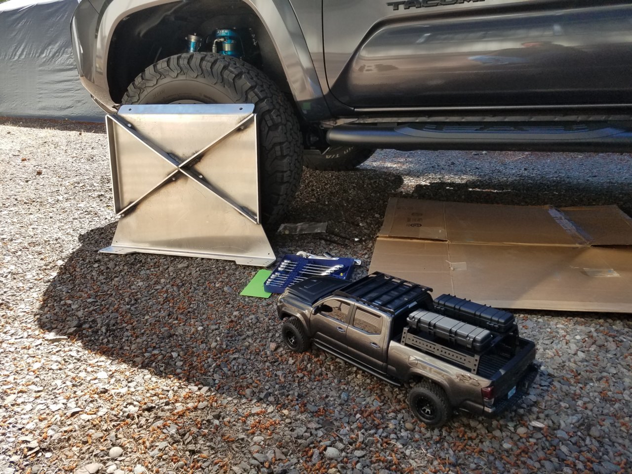

    I like your inspector. Ensuring only quality parts and craftsmanship goes into the big rig.

    Yea, he had make sure I did it right and matched his a couple weeks ago. :spy:

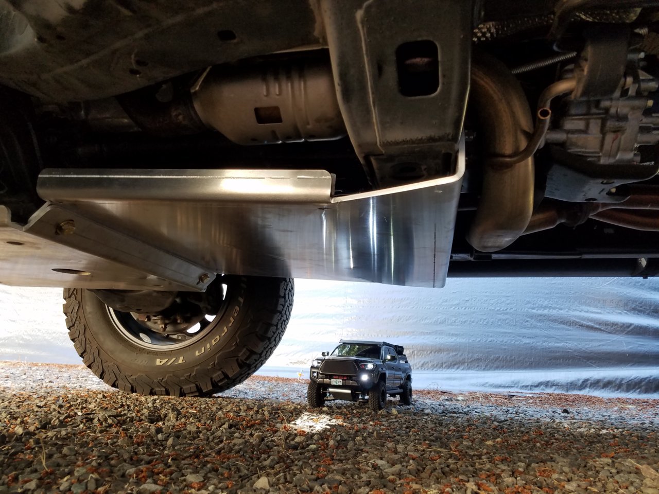

    Did/can you strap a camera to that thing and use it to really peer under there?

    I'm sure it could be done but I haven't done it. Truck already has 2 batteries to tap off of 1 for motor and another for lighting.

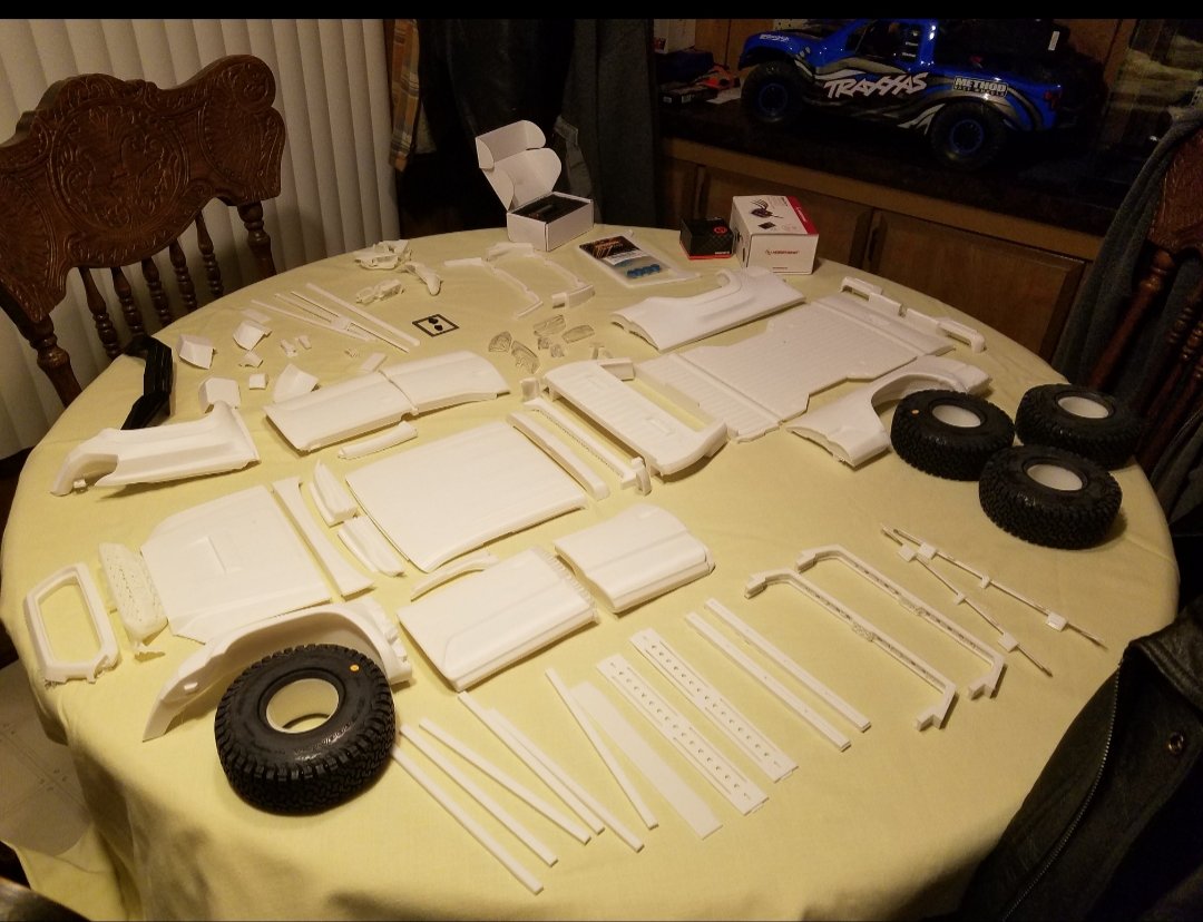

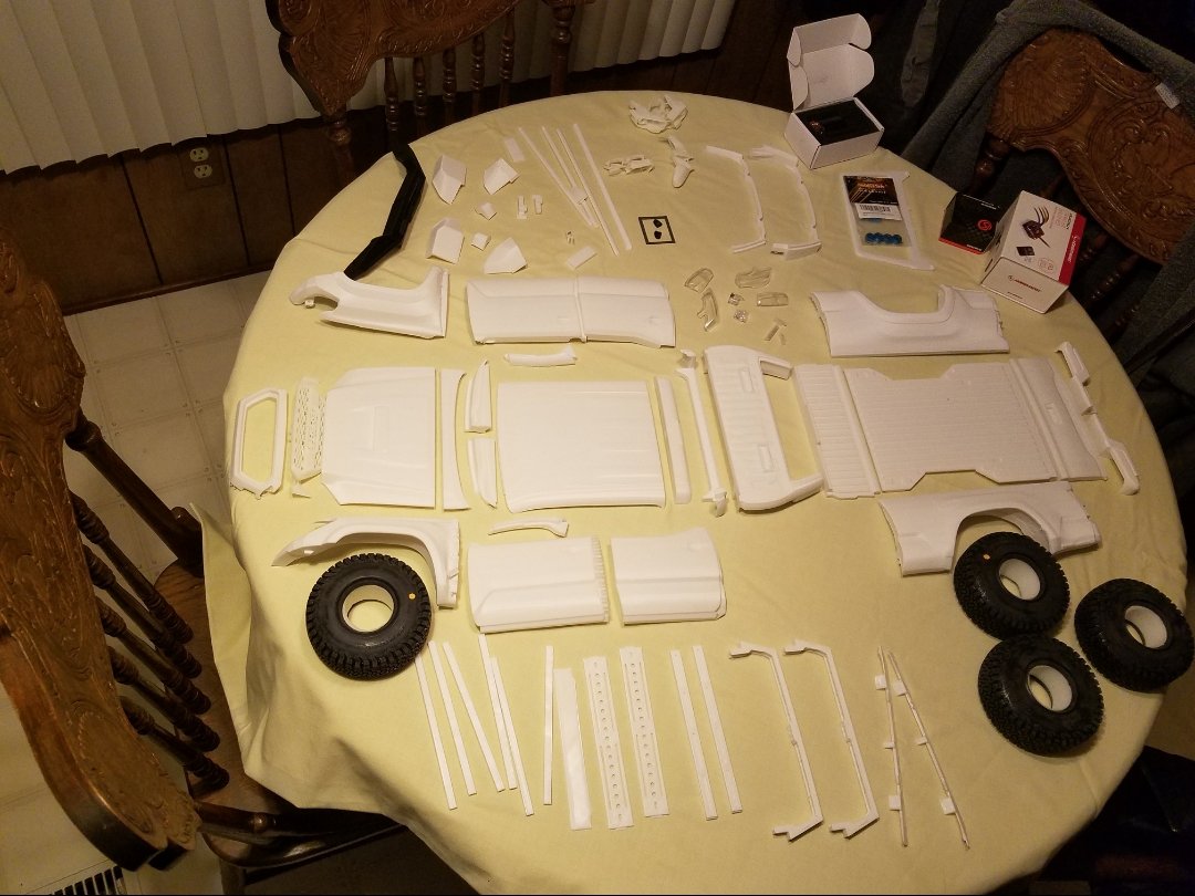

    Getting things laid out for my 2nd build now that winter is arriving. Gonna be Wide Body Overland Tacoma. Still waiting on lots of parts. Lol20201113_192308.jpg 20201113_192248.jpg 20201113_192647.jpg 20201113_192551.jpg

    Looking forward to seeing this!

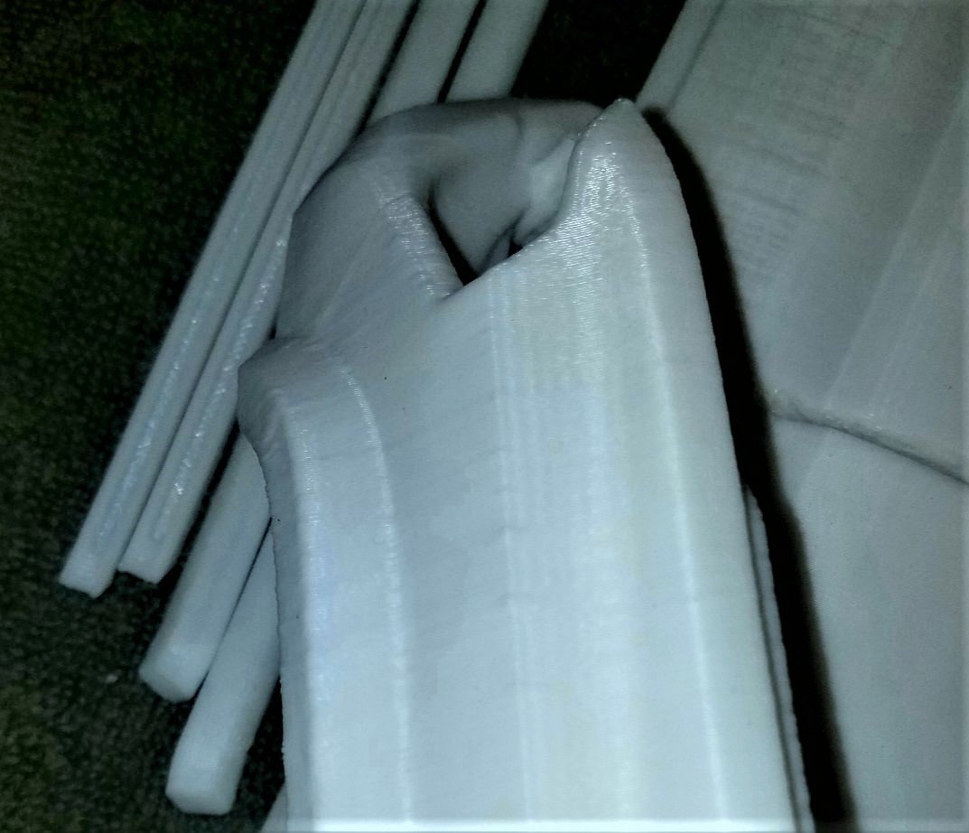

    Got started a little this weekend on the wide body. Mostly trimming, sanding and fitting before I remove/fill all the printer lines. As you can see in the pic, the surface is actually really rough so its time consuming.

    Why not have these printed in resin? It'd be much smoother.

    Don't know much about that stuff. Lol. I just take what I can get. :D

    Big difference. I know he's working on it but this is what I have. Sure would save a lot of work.

    Yeah, there are definitely benefits to either side as well as cons. FDM printing is much cheaper for example. Though the costs are going down over time. Resin parts require more prep time on the manufacturing side, as once finished on the printer, they have to be cleaned and set for extra curing time. Then you need to remove supports and then sand the spots where they were. The finished part though won't have the FDM ridges though. But some high quality (or highly tuned) FDM printers can print very finely and can almost do away with them.
