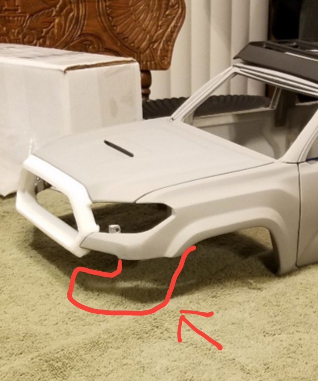

    Um, thats overspray...:der:

    Well yah, that’s obvious...
    Now that you point me in that direction.

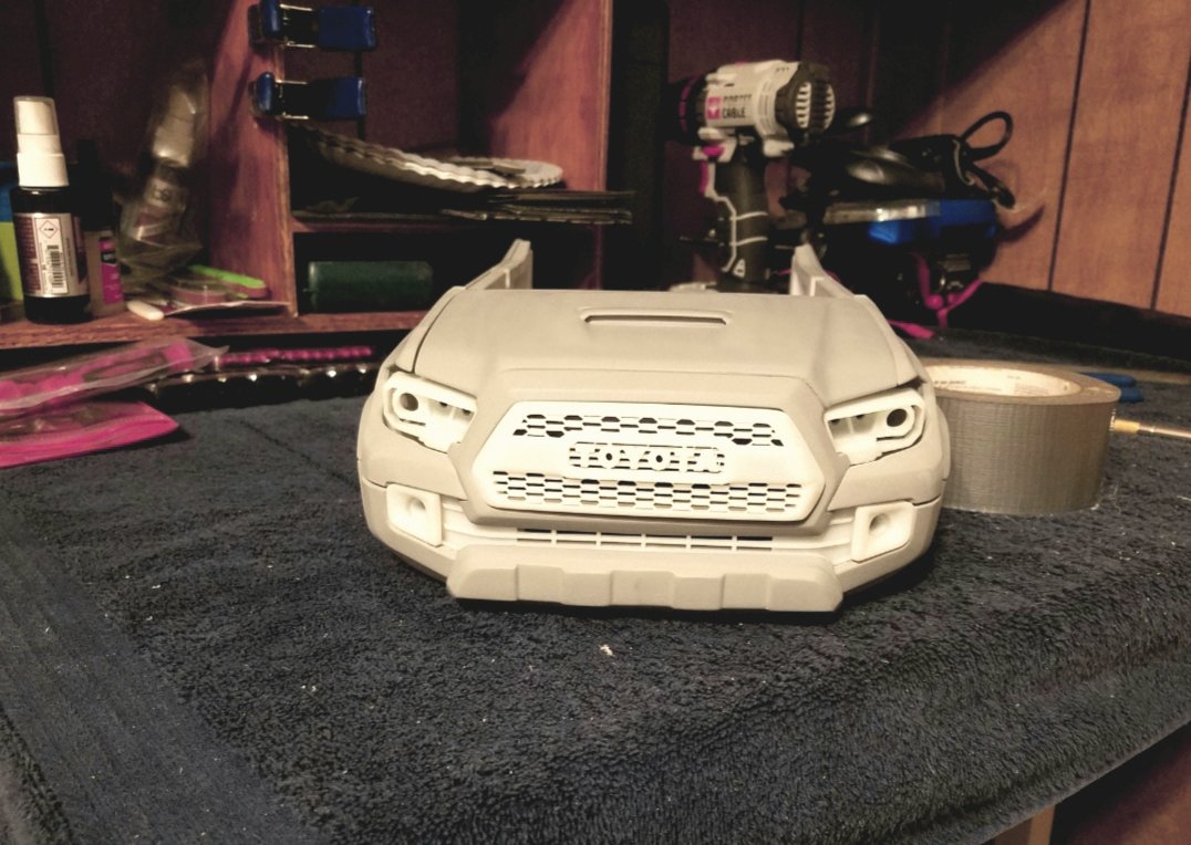

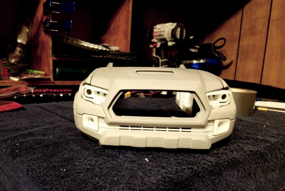

    Spend the day test fitting front bumper and grill area. Comes with a Pro grill so I will have to make my own. Actually getting harder to sand and smooth out the parts the smaller they get. Still got a lot of fitting to do but getting closer.

    My first attempt so we'll see how it goes.

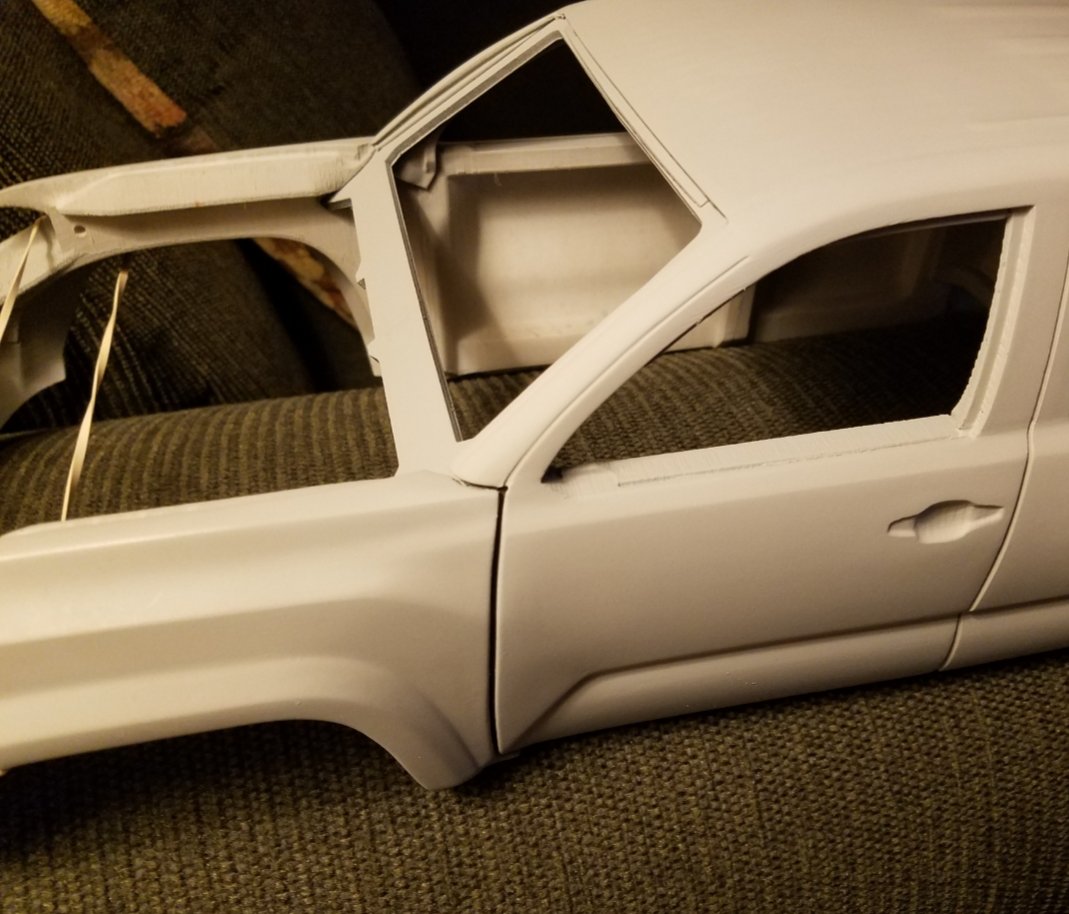

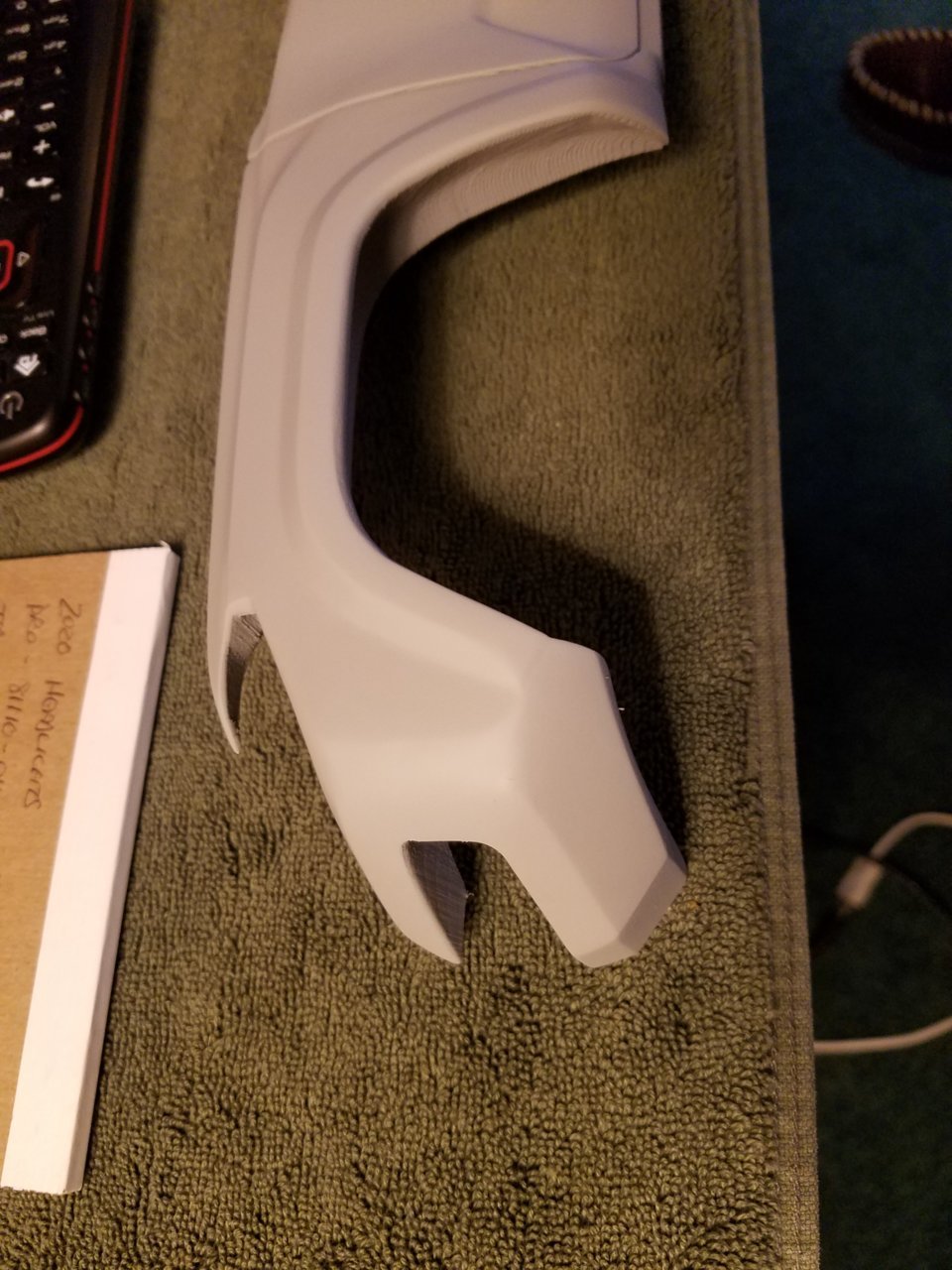

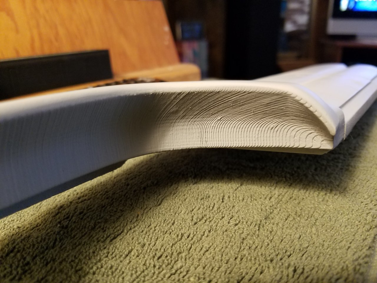

    Another one of the hard parts is putting 2 panels together that would have seams that are not on the full size Tacoma. Once you get most of the printer lines out and fit 2 pieces together you have to fill the gap, sand until it becomes one piece. Hear is the front fender. The seam would be in the wrong place if I just left it. Roof, hood, back wall, bed sides and bumpers are all 2 piece.
    As you can see the front lower piece is missing.
    After
    Here's a good shot of the printer lines you need to remove on the outside of most panels. Not quite this bad on the outside of the panels.

    Layer lines suck! But, it is the nature of the beast for now. In the end, large format printers are even worse.

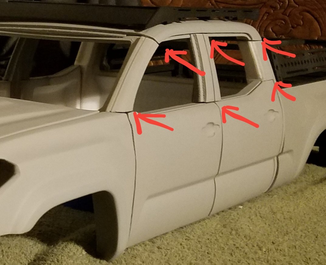

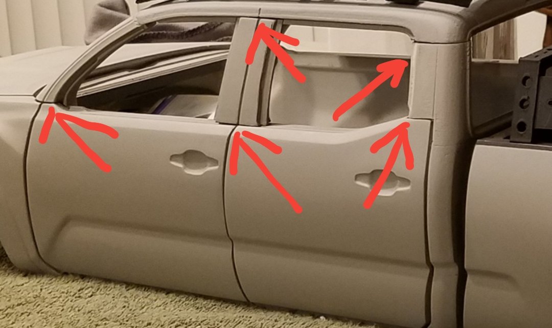

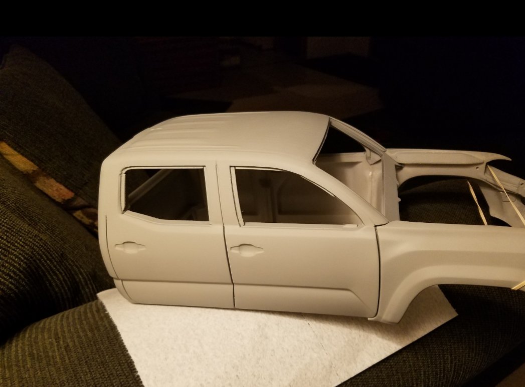

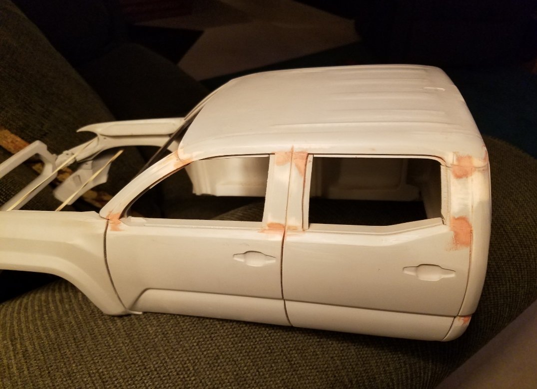

    Spent much of the last 2 days starting cab assembly. First trying to get panel gaps as close to even as I could but also making sure other parts lined up. Then filling seams that shouldn't be there while retaining good body flow.
    After

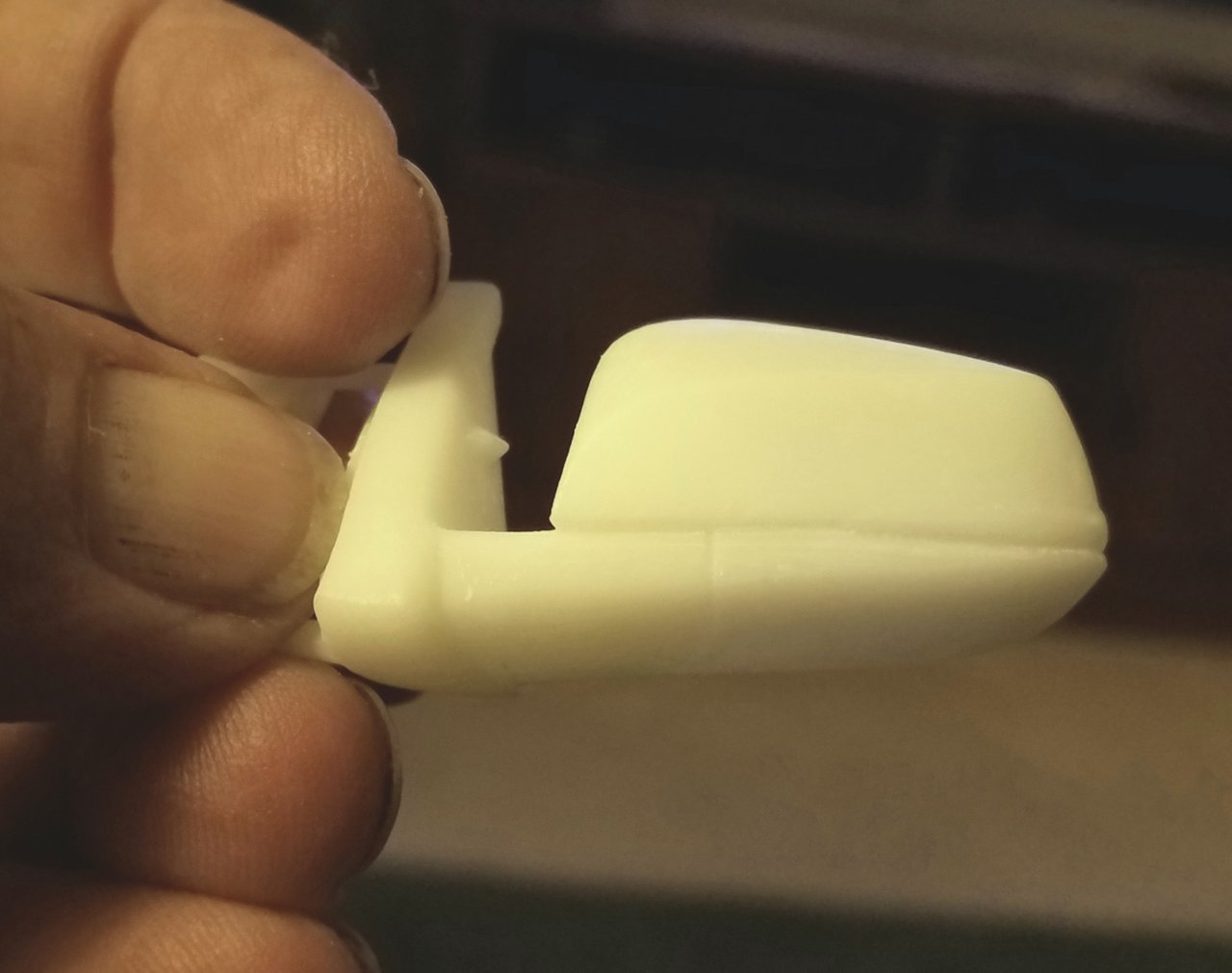

    Many people just put it together and paint it. It looks really good from a distance. My OCD won't let me do that. Also, just ordered my mirror ditch and puddle lights. Gonna give it a try on the extra set of mirrors I had made. Not gonna be easy since the mirrors are so small. :eek:
