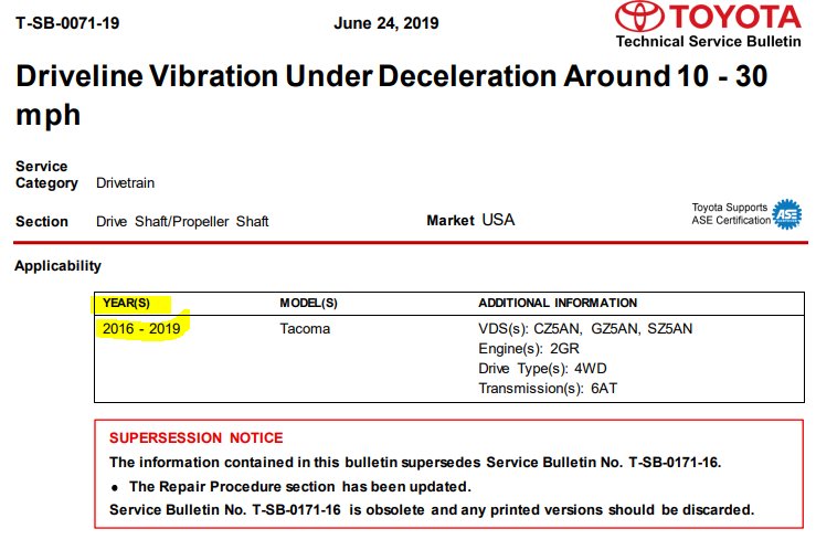

    Then I guess I don't understand how it applies beyond 2019 since this is what the TSB says:
    Do they just apply it to additional MYs without updating it?

    Great, thanks! Different TSB number.

    27
    check the original post it had a link in it for the TSB I am referring to. I think the one you showed has the same work that was done

    Shoot that’s my fault. I copy and pasted the wrong one. I’ll fix it now.

    Fixed

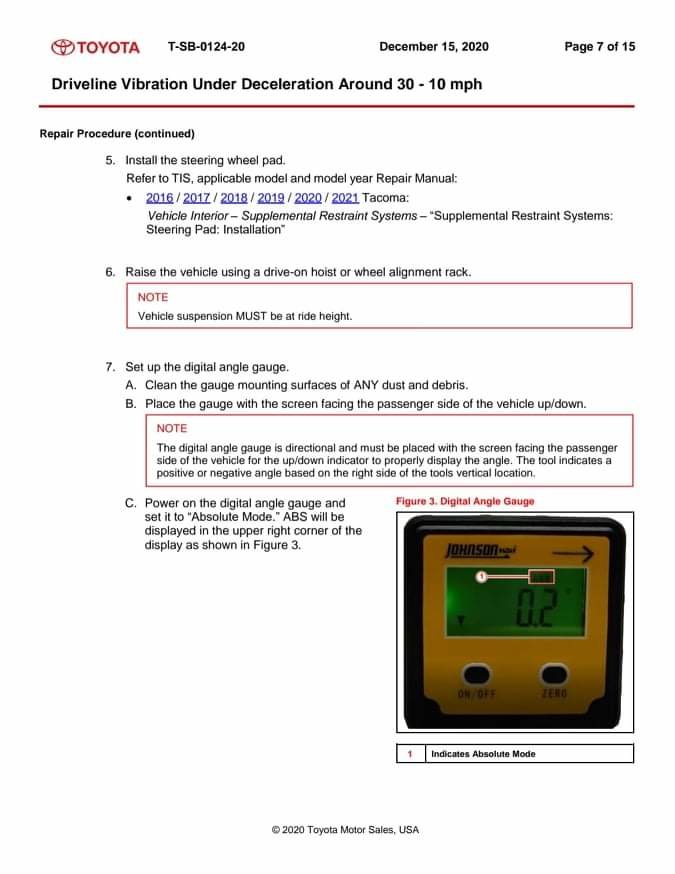

    I have the same issue on my 2021 4wd double cab, vibration decelerating at 25-20 mostly but also other speeds. I took it to the dealer and they changed the rear leaf springs per TSB 0124-20 (which supersedes 0071-19 and covers MY16-21) and added the steering wheel damper under the horn pad. This helped but I still feel the vibration, especially when braking or decelerating. I owned a HD truck shop for years and am very familiar with driveline vibration, which is what this is, probably caused by U-joint angles being wrong. It's not warped drums/rotors or anything else as it's a very fast frequency. Changing the leaf springs changed the pinion angle which decreased (but not eliminated) the vibration. In the past I've added pinion angle shims between the leaf spring and axle or raised/lowered the carrier bearing to correct this. Leaf springs are expensive compared to pinion shims, I was kind of surprised that Toyota would take the expensive way out.
    It will go back again but I'm not holding my breath. I'm expecting them to say NPF and give it back to me. Supposedly both the tech and the SM drove it after the repair and pronounced it fixed......
    PS The TSB has the tech remove the driveshaft and drive it in 4H to verify the shake is gone. The u-joint bolts weren't touched so I know he didn't do that, and probably didn't measure the angles like he was supposed to. My guess is he flat-rated it, hung the springs and considered it fixed. I have a lift so I checked his work including bolt torques.
