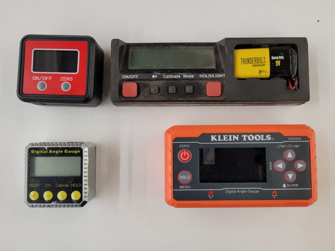

    Just a minor update, I used 4 different angle finders to shoot the angles, it's interesting that they all worked quite well. Three of them (excluding the red one) including the cheapie Harbor Freight unit read exactly the same numbers once they settled down. The Klein finder was the quickest to settle to its final number and was the best, but only by a hair. It's also the most expensive, 2x or 3x what the others cost. The others were all great or excellent. The red one measured .2° different on one measurement but the same on all others, certainly not enough to be concerned about. If you shoot your angles, be sure to remove and reset the finder several times and average the numbers you get. Wipe the flange and magnets each time with your finger to remove any debris, even the smallest crumb will affect the angle considerable. I used the tube and yoke (in pictures above) and cleaned the yoke flange thoroughly to make sure the finder seated properly.

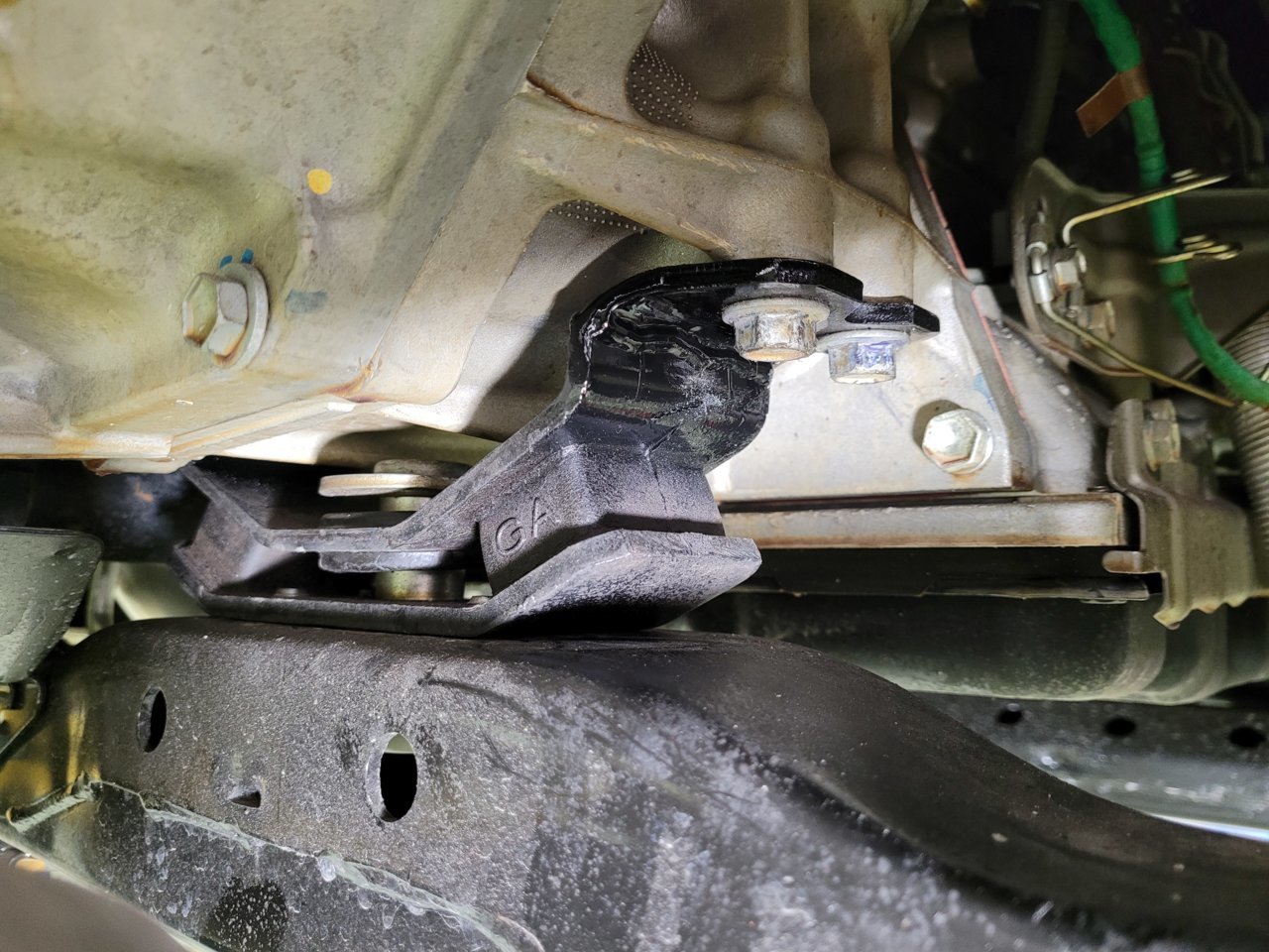

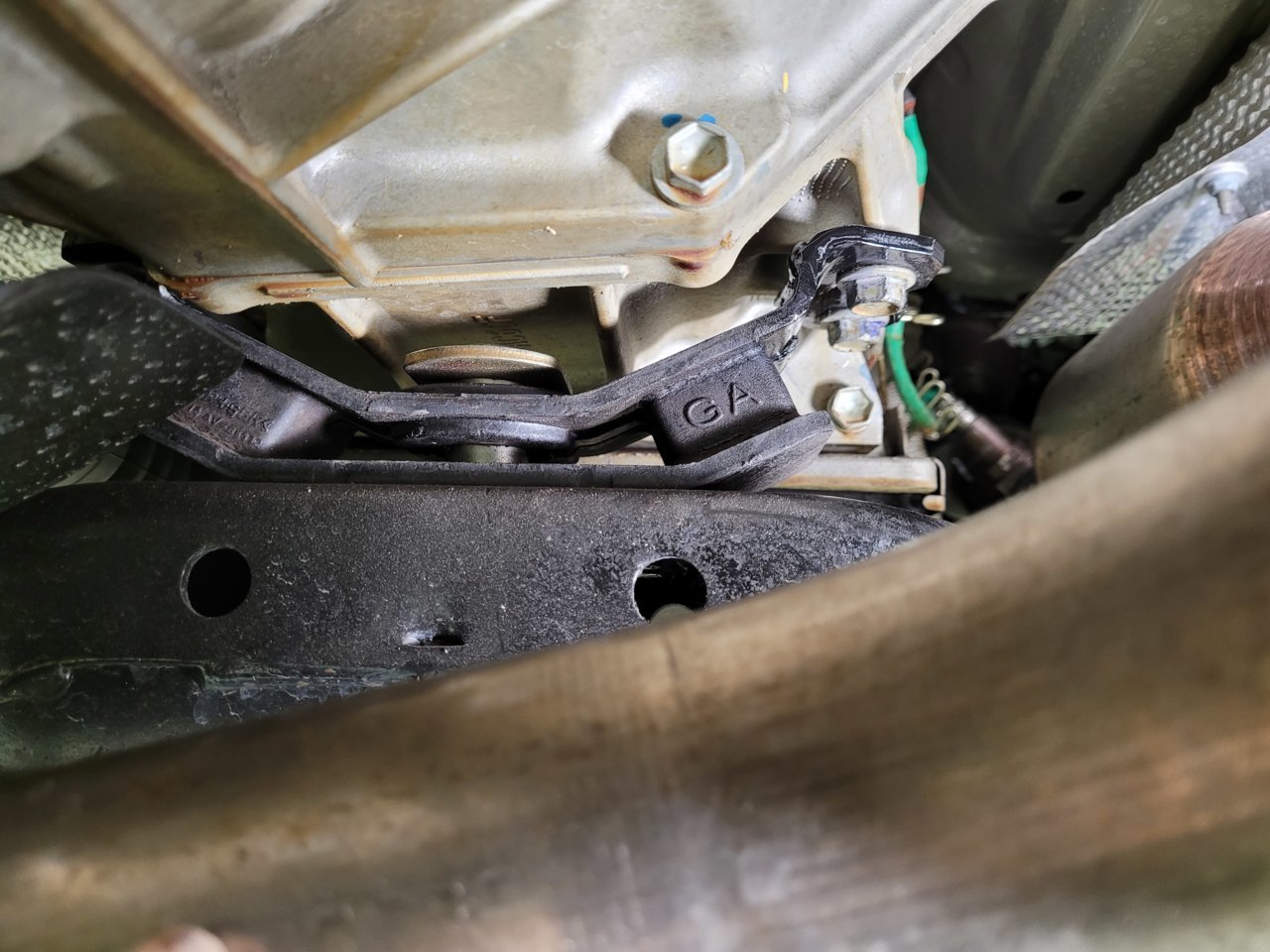

    See pics below for the "new" mount installed, compare with pic above for the unmodified mount.

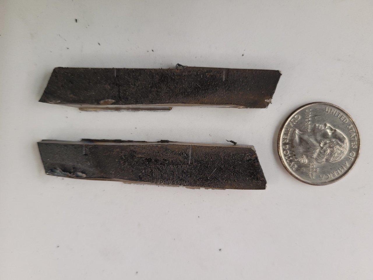

    The other picture is the two pieces of metal removed from the mount legs. I may have overshot my target angles, with the suspension loaded I'm currently running:
    Front joint: .2° down
    Center joint: .6° down
    Rear joint: 1° up
    These angles combine to an almost perfect number- the output shaft and pinion are within .2° of being parallel. Spicer wants them within 1° (.5° for motor homes). I'd use the .5° number as I'm fussier than most.
    I will put in a shim in to regain my target angles, I'd like the front joint to be about 1°. This means if you want to cut your tranny mount you should probably go for about 11mm rather than the 13ish mm (about 1/2") that I cut out.
    I'll put a 1mm shim in between the mount and crossmember, drive it a while, measure the angles, and report back. At this point I'll repeat that the vibration is still 100% gone, I have well over 1K on it since the change including some highway trips and there is zero driveshaft vibration at any speed or in 4wd. (We have had considerable snow here lately!) This makes me really happy, as a few months ago I was undecided whether to keep this truck or not. I could not have "lived" with the vibration forever as many of you are, I'm too fussy for that.
