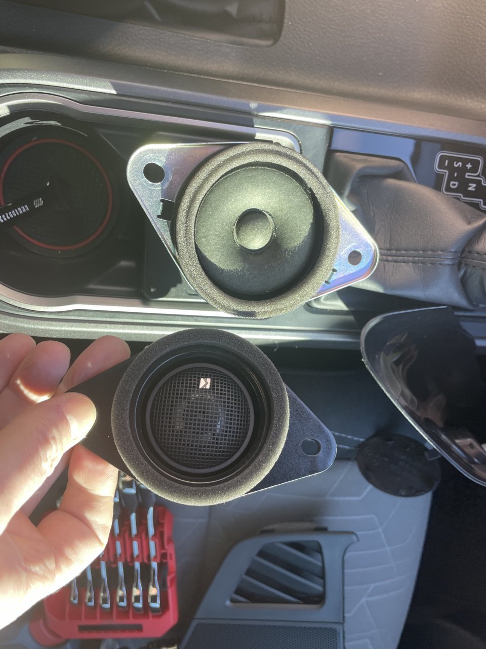

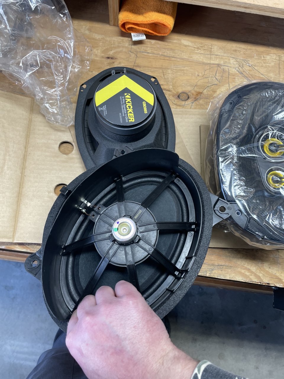

    Just did the full kicker speaker swap on my 21 TRD OR AC with the 6x9s in the front doors, Subaru tweeters in the dash and 6.5s in the AC doors. Sounds a lot better, much less muddy in mids and highs(and I’m not an audiophile by any means so I can’t begin to elaborate further into the sound ha.) However Personally I would move that mod farther down the list for any thinking of it, nice but not a NEED. DIY tip: buy the plastic pry tools off Amazon for interior panels. Screwdrivers work but mar up panels a bunch. Also when reinstalling trim, take clips off the door and install on door trim before putting the trim piece back. Otherwise ALL your GOD DAMN clips will push back through the door and you’ll have to BAND AID with DUCT TAPE until more fasteners ship in, UGH.

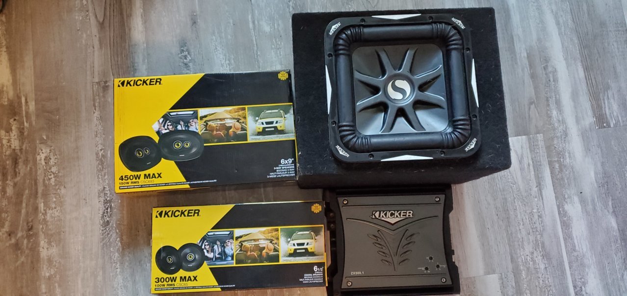

    The fix is to install a sub for your bass instead of blasting the door speakers

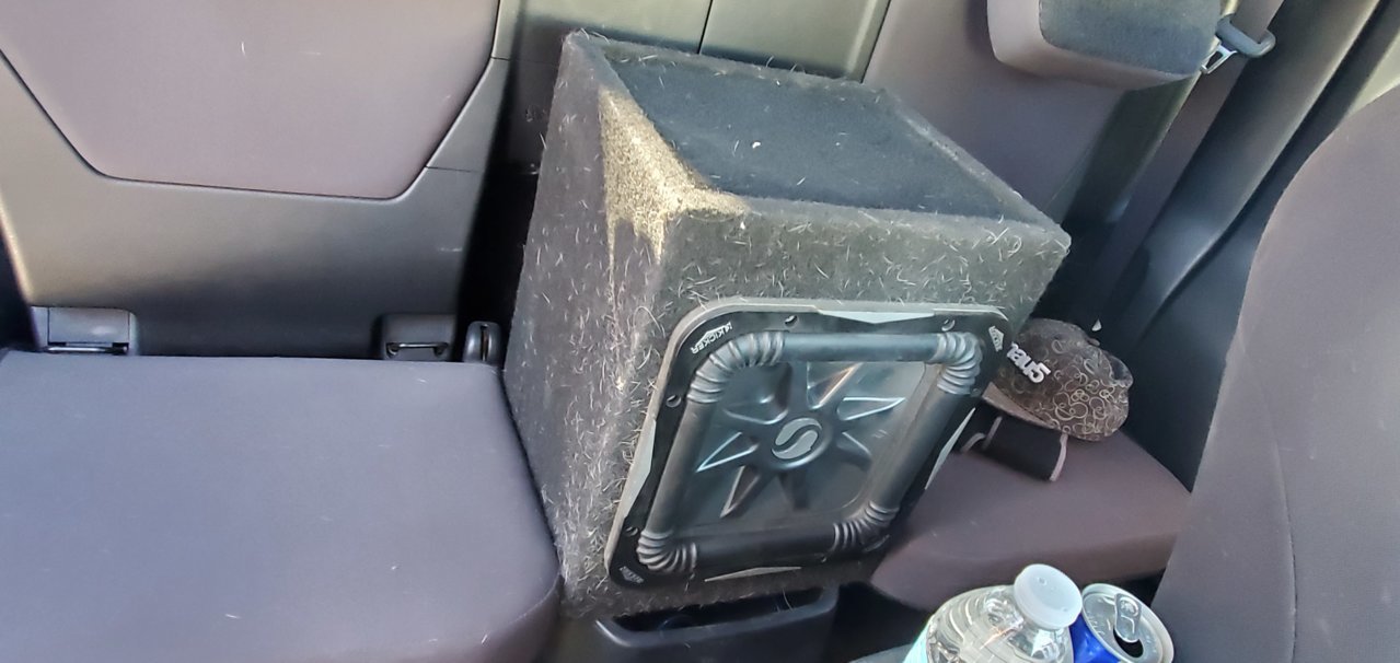

    Nice! Where does that bad boy fit in an AC though? My space is tiiiiiiiight back there.

    Fits perfectly between the rear seats, and makes a nice armrest back there. I want to build a custom stealth box at some point but haven't had time

    Please, allow me to be the first to applaud the fact that your kicker has grown a healthy beard. o_O:rofl:

    Yeah, it loves collecting dog hair...those fuckers don't wanna come out
