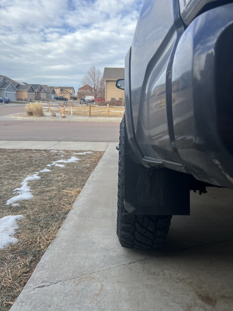

    OK I think I have picket out the 255/85r16 or 255/80r17 should I go 0 offset on wheels or -12? does zero get you at least even with the fenders?

    255/85/16 on 16x8 -12 wheels.
    FD052D33-4B29-41D4-904C-5F1569D21EBD.jpg CDB46CC6-D173-40CD-94E8-58CF32797C09.jpg

    thats about perfect. I suppose from your answer above you have no lift?

    Yep, no lift on the front and an AAL on the rear to counter the weight of the shell.
