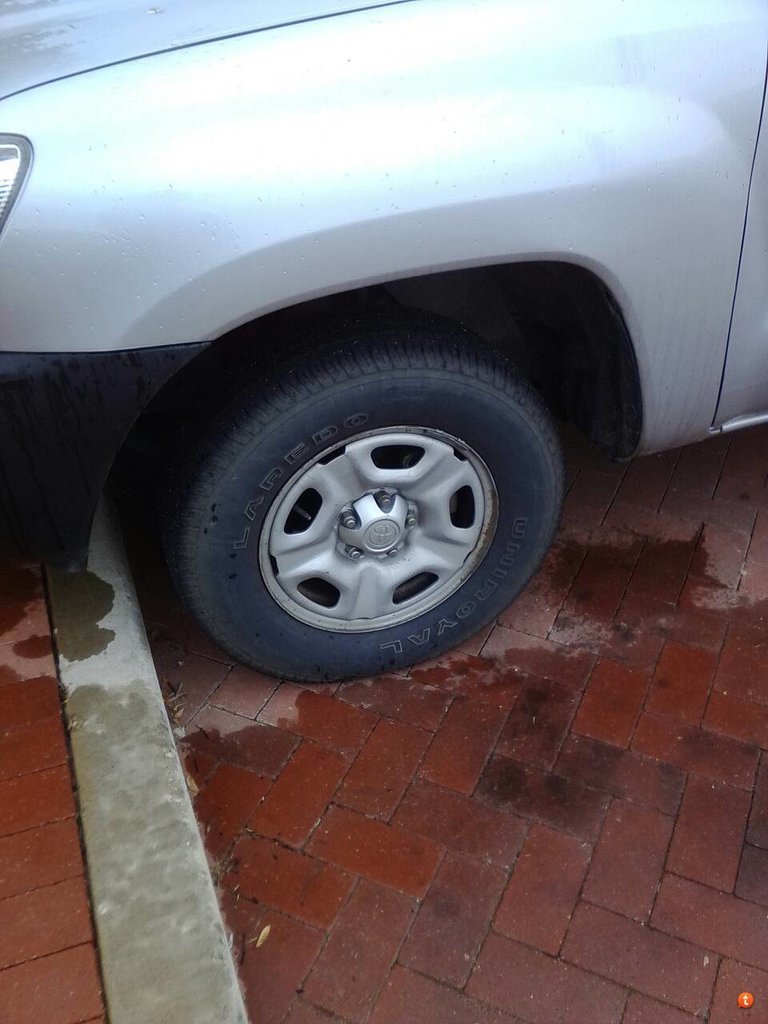

    No pics, but I currently have the Uniroyal Laredo cross country tires in that size on my access cab automatic. I've had zero problems so far. Before that I had the BFG all terrains. No problems.

    Any chance you could snap a pic when you have time? Thanks!

    ejujase3_46195b24446672a5122b52c01a3fac9015918d82.jpg My drivers side front. I'll try to get a side picture when it's not raining.

    Thanks buddy! Appreciate the pics. Looking forward to more!
