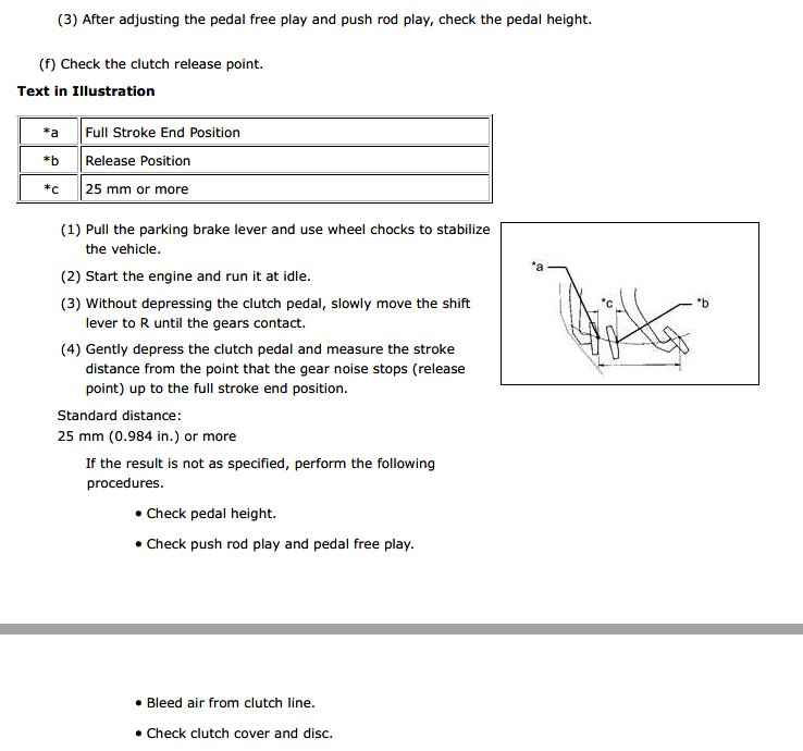

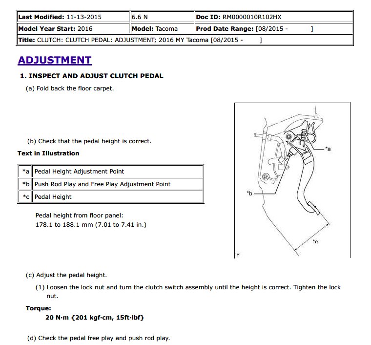

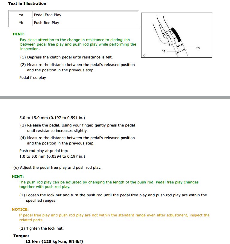

  2. May 19, 2022 at 5:53 AM
    ShirtTucker
    ShirtTucker Taco Tip Line: 248-434-5508
    Nov 24, 2017
    #236812
    1,160
    2017 V6 Sport AC MT
    Lots-o-stuff

    Close up the gap between the pedal and push rod. Leave the tiniest gap you can but be sure there's a gap. Leaving no gap is asking for premature throw out bearing wear. Also, the plastic top-hat that pivots between the pedal and pushrod could use some plastic-safe lubrication. Use what you prefer.
    For the love of all that's holy, get rid of the clutch accumulator. I waited till the 36k was up and I wish I did it on day one. There are a million ways to do it, I used a flex hose and banjo bolts.
    Now it feels like it should. Predictable clutch engagement, pedal feel doesn't change until <30*F and at that it's like any other of the dozen manuals I've had.
    edit: hey, i just looked at the FSM Shirttucker posted and it says 1mm gap. Go me :laugh:
    edit #2: The extra-weird dead space you're feeling is the combination of the big spring that holds the pedal up and the actual pressure place resistance. [edit]. If you notice that your clutch grabs strangely close to the floor, that's why. The effect of the spring fades after about half of the pedal travel then you're actually pushing the pressure plate out. (Figured that out when bleeding the system.)
    So it works like this: you start pushing the pedal, [edit], the spring makes it feel like you're actually pushing a normal clutch. The spring effect fades right about where the pressure plate is actually providing resistance and that's the strange, two-step feel you get.
    The three things you feel are air-gap to rod, pseudo-resistance from the spring, [edit], then the actual pressure plate's resistance.
    I tightened up the air gap and removed the accumulator. The clutch engages in the middle of the throw, I don't feel a pressure change in the throw and the pedal doesn't nearly stick on the floor when below freezing. Now, I DID have to relearn my habit of stabbing the pedal to the floor since this truck is like many others and it's not needed. I have other vehicles (fun cars) that engage right off the floor so there're always a few bad shifts when going between toys. Ah well, first world problems and all that.
    Edit #3: Tonered made me reanalyze things I thought I'd figured out, it's been so long that now I'm not as sure, so I redacted a few parts so as to not mislead.
