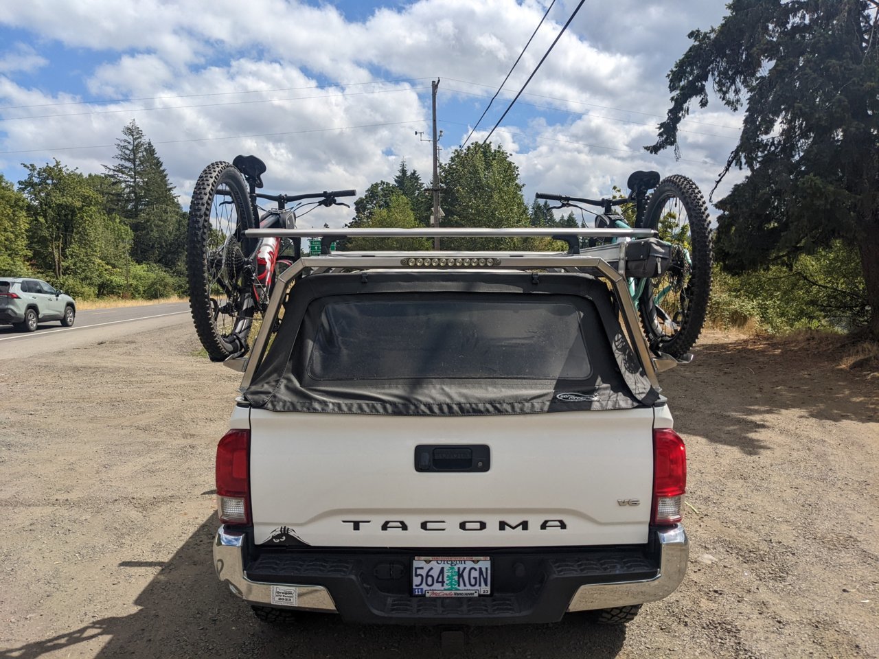

    I purchased a Curt trailer harness that ties in between the drivers side brake connections (plug n play).
    It was cheaper for me to go that route and just hijack the brake connectors and route a line up to my 3rd brake light.
    I have a Softopper as well, but also have a custom aluminum rack over it that I installed my 3rd brake light to.
    The only pic I have of this 3rd brake light.

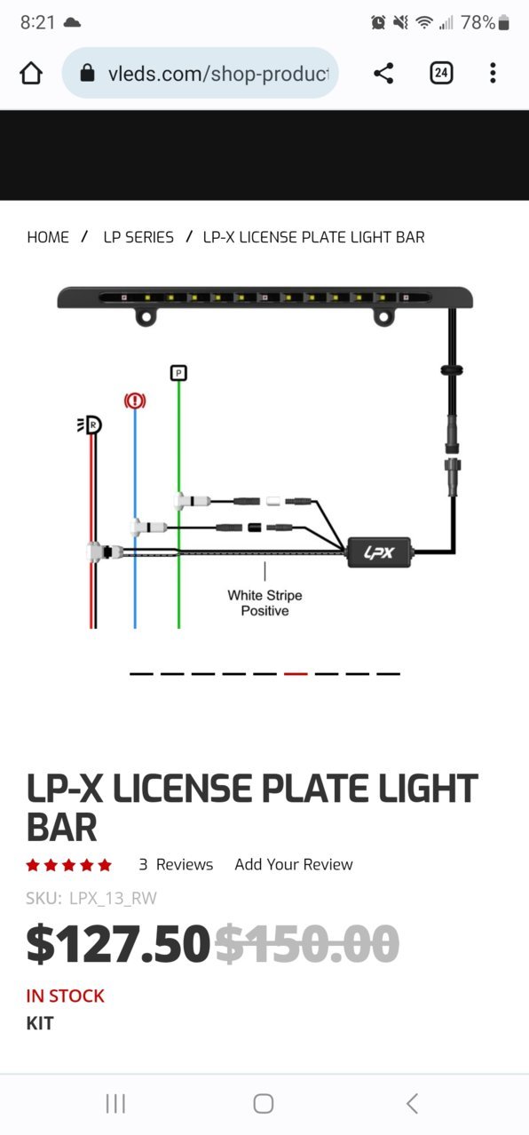

    This is one I was looking at, but not sure if I use this one or the long version. I want it plug n play on the original harness
