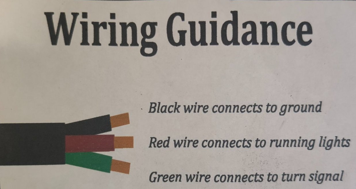

    No connector. Just 3 wires to be crimped as needed. 1 wire for ground, 1 wire for DRLs, 1 wire for turn signal.

    Do you want pure DRL or DRL + parking lights?
  5. Nov 18, 2023 at 8:16 PM
    daveeasa
    daveeasa FBC Harness Solutions
    May 14, 2020
    #328079
    7,460
    David
    PNW
    2016 Tacoma OR DCSB 6MT, 2005 RC 5MT PreRunner, 2002 Tundra SR5 RCLB 4x4
    Per that spec they want parking lights rather than DRL.

    I'd like DRL + Parking Lights if that's easiest connection I can make for this to make it work. Let me know how I can order some from you in that format. And thanks for all the info you've been providing.
  7. Nov 18, 2023 at 9:44 PM
    daveeasa
    May 14, 2020
    #328079
    7,460
    David
    PNW
    I made a sku for you, it's basically the same as the switch-pros version.
    If you wanted just parking lights, turn and ground, it'd be the same as the basic driver/passenger just with turn instead of drl and no diode module.
    I could probably crimp directly to those things if you didn't want to do pigtails and heat shrink butt connectors.
