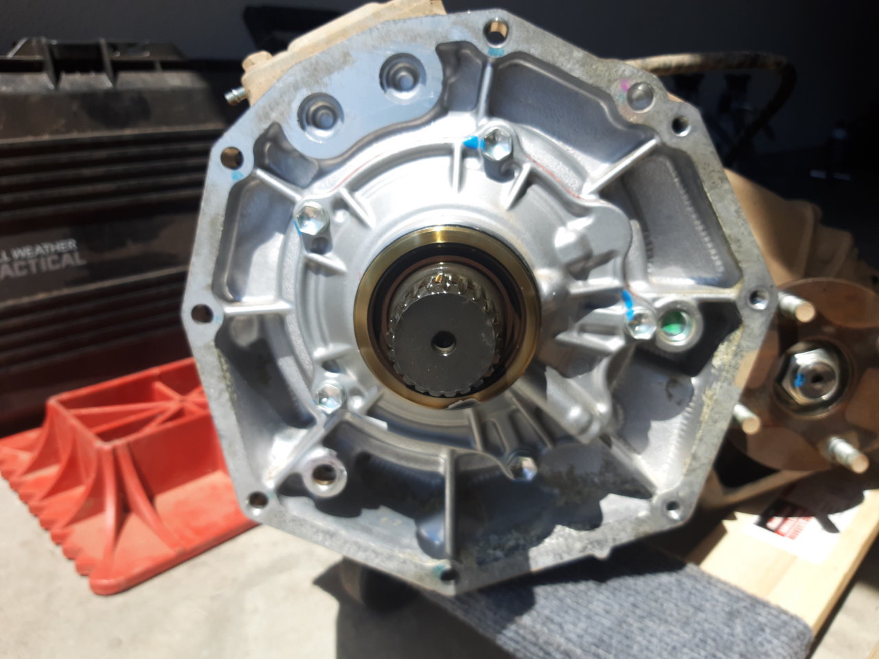

    Mostly Zip-Ties
    BigMike also said they were working on 19 spline couplers in his post. This has me a bit concerned after seeing your (@Littles) 22 spline shaft. I don't want to opt out of this group buy and then get a Taco Box with a coupler that isn't going to work. Who knows how long it would take to get resolved? I'm trying to get back to Moab early next year and I'd prefer to have everything at 100% and tested. That said, if I can save $600 on a coupler and take advantage of the promo, it would save $800+.
    I posted on the crawl box updates thread asking about the current Hot August 10% off discount. Depending on what Mike says I'll either keep waiting for my auto crawl box and go with the coupler in this group buy or cancel the order and place another order for a manual crawl box.
    Probably not what anyone wants to hear but it's where I'm at right now.

    BigMike and everyone at marlin is wrong on the number splines. My ability to count is yet another reason I am not putting my eggs in the marlin basket. I feel like they should know the correct number splines that need to be on this adapter that they are putting so much time and thought into engineering...but that's just like....my opinion.
    My transmission has 22 splines, so that's what the shop is making me. The shop is going to save the design for me, so when marlin puts out their 19 spline paperweights, and you still need a 22 spline coupler to install your crawl box, rest assured that we can make up another. By that time it will have been Moab tested and proven.

    BigMike never responded to or acknowledged my post. When I called Marlin a few weeks back to discuss the adapters, I attempted to inform one of his employees over the phone that it is a 22 spline after he incorrectly stated it was 19. He put me on hold to go check and came back a few minutes later to tell me I was wrong. I've given up on them. If they want to continue to perpetuate incorrect information that's on them, but it does not give me much faith in them.

    which is bullshit cuz the 6speed has been out since 05. they for whatever reason seem to refuse to put any support into that transmission. also, the bullshit of spline count. doesnt matter how many people tell them they are wrong, the refuse to acknowledge that. even wyatt's write up he had when he had his forum explained it was 22 spline and not 19. last but not least, their double row bearing is garbage too. there was a big thread over on ttora about it and people having a ball bearing pop out of it. which happened to me. and they still refuse to admit its a bad design.
