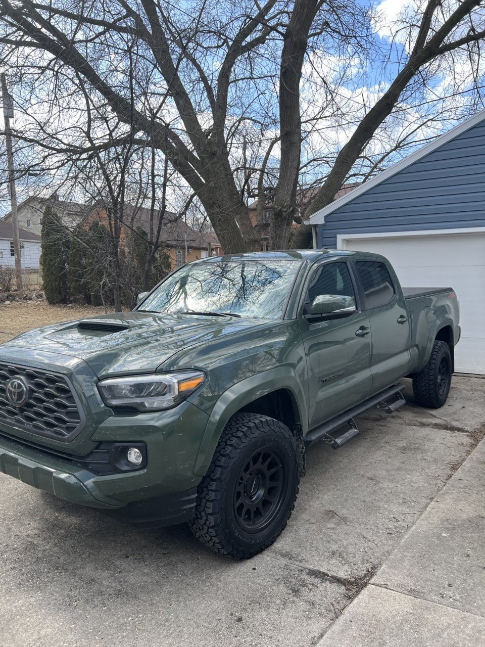

    Hey guys,
    I'm pretty new to world of Tacoma's and trucks in general. Looking for some help in understanding what's going on with my new Tacoma.
    I got a new 2022 TRD Sport DCLB with the advanced tech packaged a month ago. First few weeks of driving it has been amazing and I've loved every second of it.
    This past Friday I took it into discount tires to upgrade the wheels/tires to the Method 703's with 265/65/17 KO2's. I specifically choose to stay with the stock tire size because I didn't want to modify much else as I had no intention of touching the suspension for now.
    When they finished the install, I started driving home and noticed the steering wheel was shaking slightly and then when I hit a 45MPH road, the shaking got so bad that it was obvious I needed to turn around and go back (it was also pulling very hard). They blamed the shaking on these small rings meant to hold the plastic center cap in place and removed them, then rebalanced the tires (I think they fucked up balancing the tires to start with).
    Anyway, I started driving home once again and noticed that it wouldn't stop pulling to right but would also pull to the left when I corrected it. On the freeway, it seemed to mainly just pull to the right. But it almost seems like the truck will pull to the side I corrected it to last, not just one side only. Like it doesn't know how to just go straight anymore.
    So I went back a day later and they switched the front tires to see if it was a tire problem but the issue persisted. So I got them to agree to pay for an alignment at Toyota dealership. The alignment came back showing the toe was off by a couple hundredths of an inch (hard to imagine it caused any issue), they fixed that but the issue persisted.
    Today I went back to discount tire and they replaced all four tires and once again, the issue STILL persisted.
    I'm at a loss of what is going on here and just want my truck to drive STRAIGTH again. It was perfect prior to replacing the wheels/tires.
    Could this issue actually be caused by the 'wider than stock' 703 rims? I know other Tacoma Sport owners with 703's who don't have this issue. Any advice or help would be greatly appreciated as I've had a hard time finding information on this.
