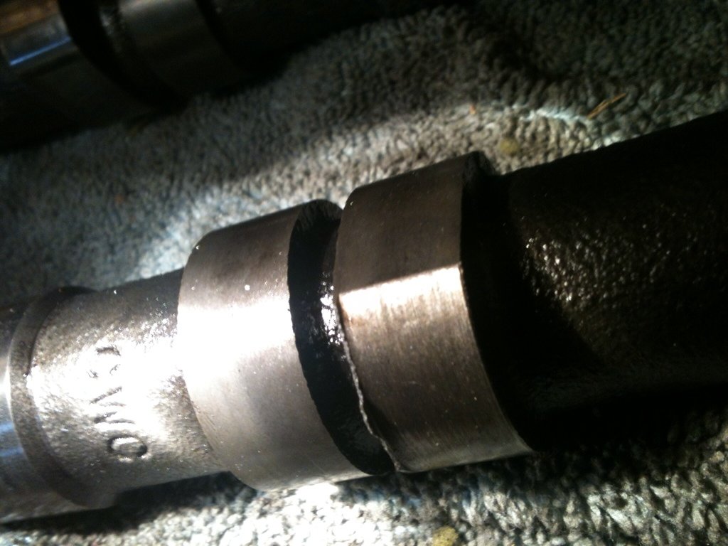

    Well i took a chance and picked up a 22r assembled for 100 bux, it wasn't rusted up and siezed so it already had an advantage over the motor in my crawler. Tore it apart and the cam had some wicked wear on two lobes and the rocker arms, it was burning oil in two cylinders, same two cylinders have pistons that have wiggle room in the cylinders, BUT it has a dual row timing chain, the chain guides look perfect, the cylinder walls are in great shape and the block deck and head surface aren't warped.

    Just trying to track down what causes this wicked cam wear so it doesn't happen again, non adjusted valves? Oil starvation...? It only happened to two lobes

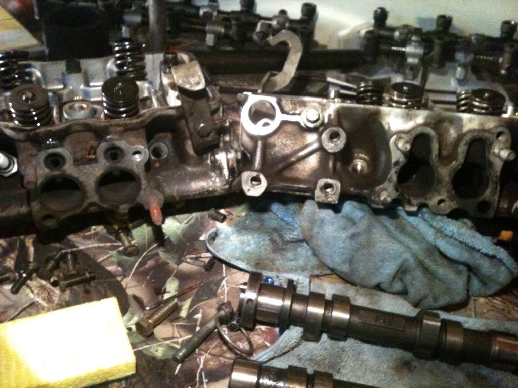

    The siezed 85 motor has pear shaped exhuast ports, i'd like to use the exhuast header that was bolted to this as its brand new. Can i use a 85 ex header on the pre 85 head?

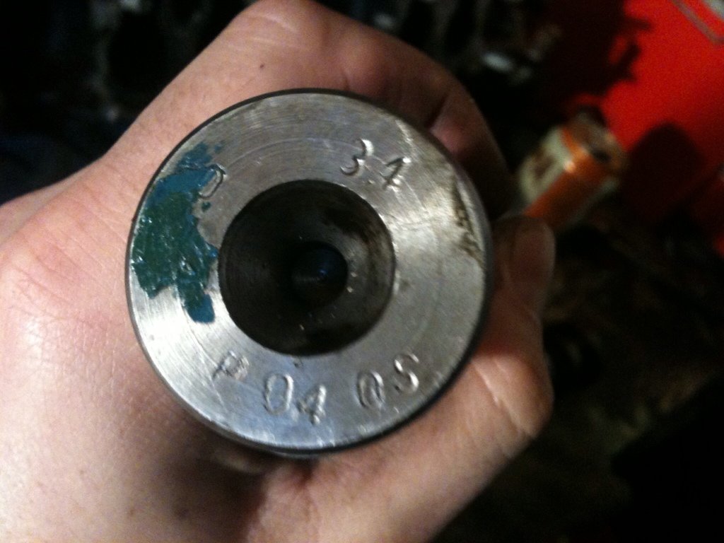

    Just to kill my curiosity, How can i tell which cam i have?

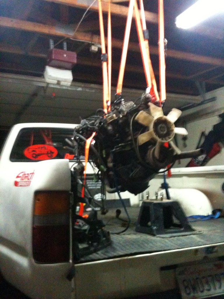

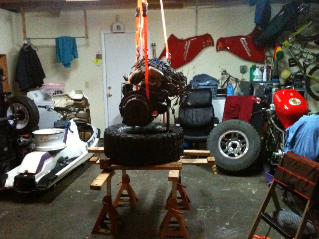

    Thanks to a buddy i now have a stand and hoist now so i don't have to do this again...

  2. Dec 12, 2012 at 4:12 PM
    YotaDan
    YotaDan Dan
    Apr 1, 2009
    #15461
    2,360
    Dan
    Oregon
    The common Cam Wear problem on 22R/22RE engines is the lack of zinc in oil now days. It is crucial when installing a new cam to break it in with high zinc break in oil or you will ruin it right off the bat. Unfortunately the stuff is like $10-$12 a bottle. Even after break in, it is a good idea to use a good quality oil. Preferably something with zinc in it.

  4. Dec 12, 2012 at 4:44 PM
    YotaDan
    YotaDan Dan
    Apr 1, 2009
    #15461
    2,360
    Dan
    Oregon
    As far as why just those two lobes. Not really sure. Except the oil ports that feed oil to the lobes are very small. They can get clogged if a person never changes their oil.
