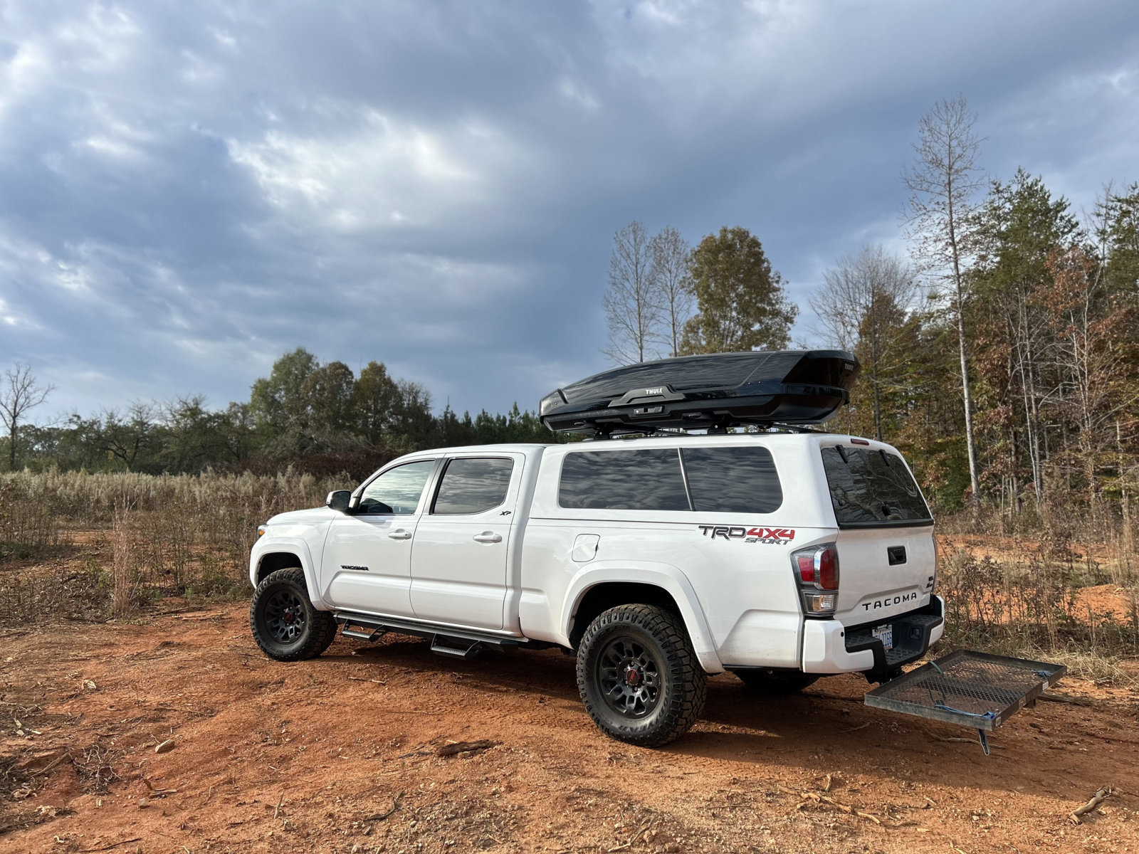

    New guy here coming in to share my story.
    Bought a new Tacoma 4x4 TRD long bed Sport off the lot Nov 22.
    Fast forward a year and I have 36k miles on it.
    Engine light came on while on a little road trip, but everything seemed fine. Turned off by the time we got home so I thought nothing of it.
    A week later the light pops on again and the cruise control stops working, won't even turn on.
    Call the dealer, set up an appointment and stopped at my buddies to pull the code incase the light turned off again. P11EC00. Light turned off the next day go figure.
    Take to dealer and explain the issue. They say it's been popping codes and errors according to the system and take it in to diagnose. Couple hours later they say it needs a deeper look and send me home with a loaner. They call me that night and explain that there is a new issue happening with these engines and there hasn't been enough for a recall. It's all under warranty and will be replacing the heads and valves.
    Here is what they communicated.
    "It appears on this engine Toyota is experiencing an issue with loose valve guides in this motor. The fix is to replace the head as well as the valves. I am not sure they have seen this in enough vehicles yet for a recall but it is on their radar."
    "I am going to be removing the engine and breaking it down to the block on bank 1 only. I will replacing the bank 1 cylinder head and the exhaust and intake valve of cylinder #1. The problem that occurs on this cylinder heads is the valve guides wear out prematurely and do not allow the valve to properly seat. This causes the malfunction indicator light to illuminate with a code P11EC00 Cylinder #1 Air-Fuel Ratio Imbalance (Port) due to "unmetered" air in the affected cylinder detected by the air/fuel ratio sensor."
    Not sure how/what to think and generally just worried about this truck. It's my second Tacoma, my first one was a 2005 and had 230k miles on it when i got rid of it. We bought this one thinking we would have the same experience.
    Anyone ever had a major warranty issue like this? Do I have any grounds to work the dealer into a new truck or some kind of trade? I haven't really experienced anything like this and frankly feel uneasy about the truck.
