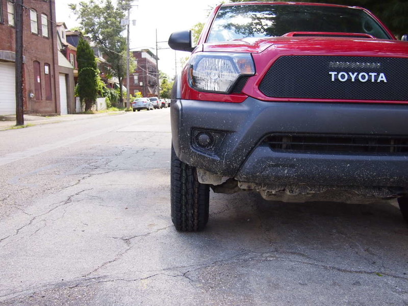

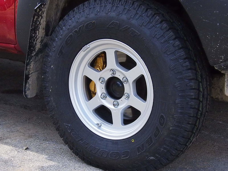

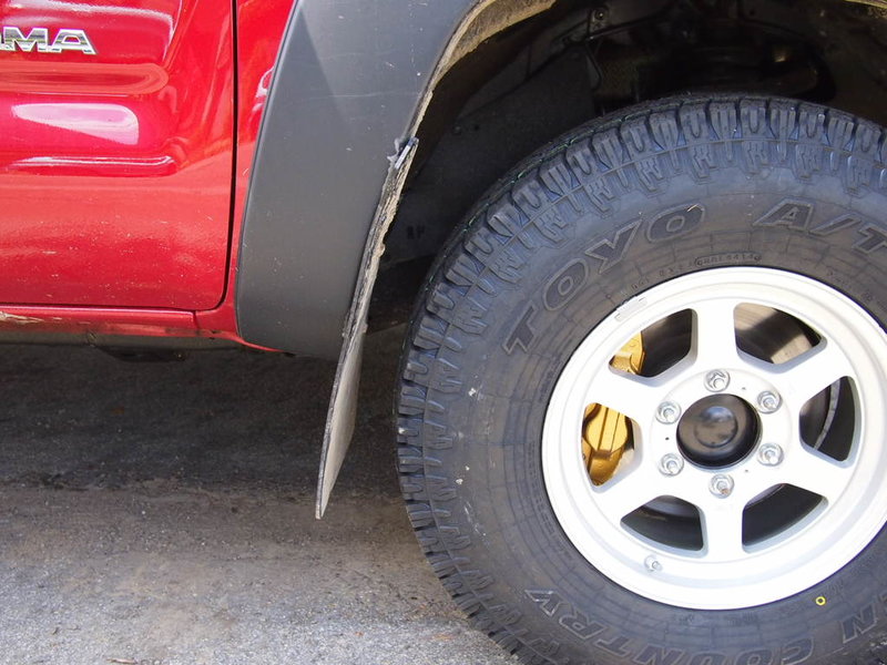

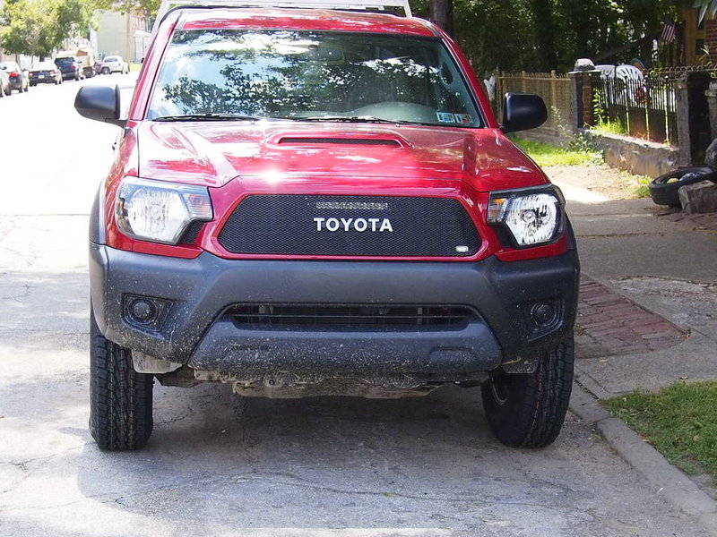

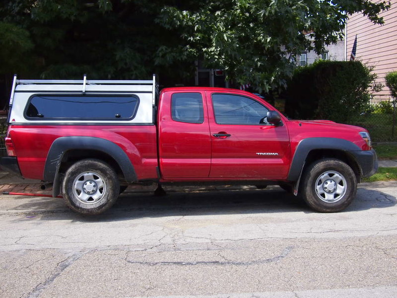

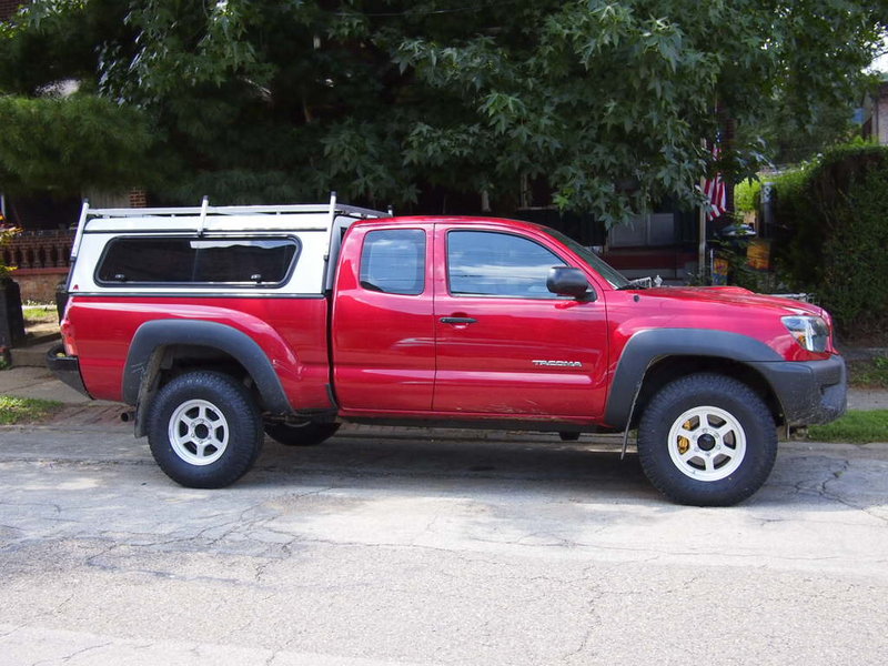

    Just finished installing! Looks awesome! Painting the calipers was a pain but so worth it. I've got plenty of clearance for mudflaps. What kind of pressures are you guys running? I'm gonna test out around 36 psi.
    Before:
    After:
    Some more shots:

    Need to get longer lug nuts also. Had to run open for now...

    What brand of rims are those?
    Truck looks great man!
    Good call and you saved on shipping. :headbang:

    Thanks dude! Those wheels are made by Rays Engineering in Japan. The same guys who make the famous Volk series sports car wheels. They were originally an option on early Nissan Frontiers. Forged aluminum, 16 x 7, +39mm offset. I had to run 1" Bora spacers. Also I had to have the center bore machined out to Toyota's 106mm because Nissan was like 101mm or so. They're supposed to be very light and strong, I was lucky to find em on ebay, they're getting rare. They weigh about 15 lbs a piece.
    I haven't noticed a significant change in drivability. I can still cruise at 35mph in fourth gear without lugging the motor. I noticed is a bit harder to start from a very slow roll in second gear. I report back with mileage after a tank. I usually get around 18.5mpg of pure city driving.
    No vibration from spacers. I went up to 60mph so far. Truck seems more plush on bumps, but I also added a leaf to the rear. I will say that if i turn hard and fast enough to hear the tires squeal it feels also more spongy and unstable than it did with the Dunlops. But it's not a sports car, so as long as I don't drive like an asshat I expect to love these tires. No perceivable road noise either. No hum or drone. Still gotta play with pressure, maybe do chalk test.

    looks good man, i got a cap like that too. damn, they are skinny. digging the gold calipers

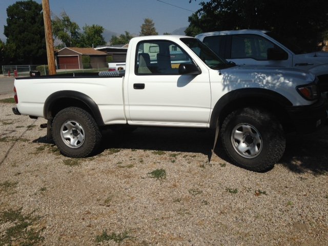

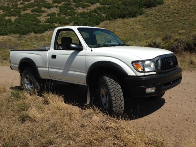

    I stuck mine on today for a trip to Southern Utah in a few weeks. At 30 PSI the Cooper ST Maxx's feel like P-rated tires on pavement and just glide over washboarded dirt roads. Can't wait to try them aired down!

    awesome man I got a cap just like that, idk if mine sticks up a little bit higher then yours. I have stock tires are just averaged ABOUT 17.8 MPG. idk maybe to give you a reference. Im thinking about getting some type of roof rack fairing and rigging it up.
