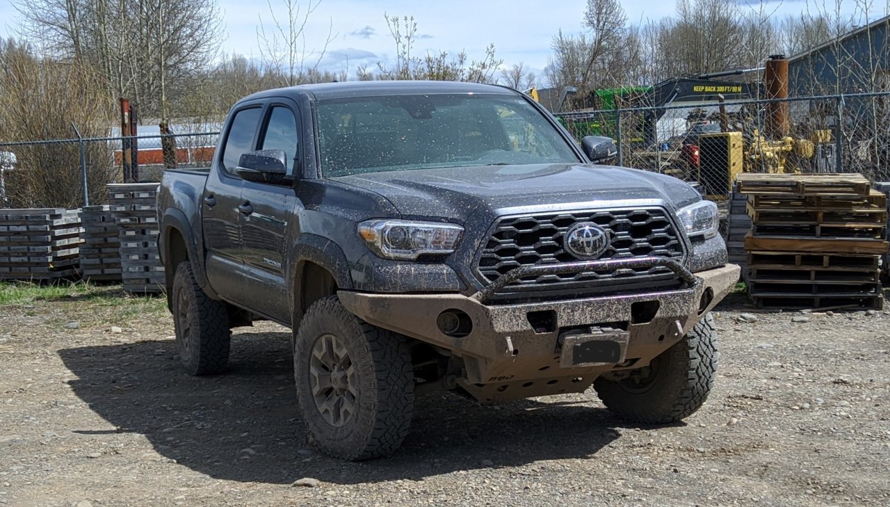

    How are you liking the Destination XT tires? I have the same ones and have been impressed. Snow traction is very good. Weight is very reasonable, although I realize sidewall strength is not the same as my BFG KO AT's.
    I opted for the skinniest 16 you can get in LT's; 215/85 r16's

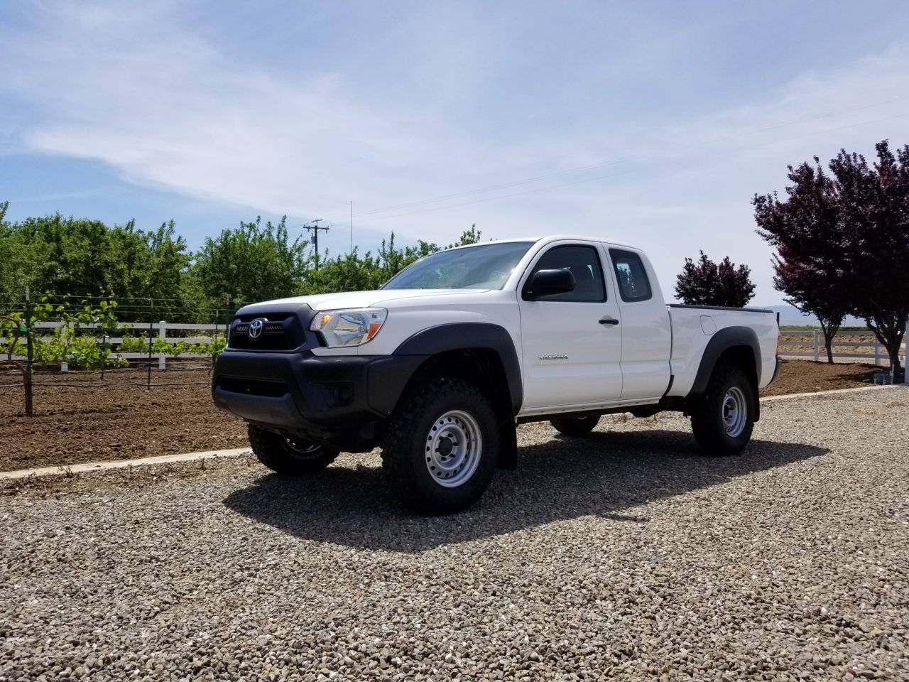

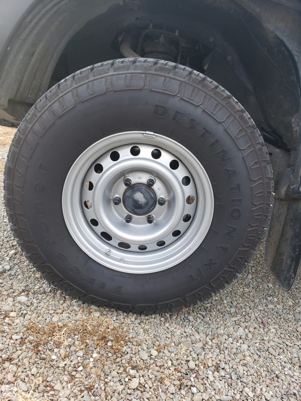

    '15 Access Cab, 4x4, V6, White Base Model, 235/85/16's
    16" powder coated factory steelies, 235/85/16 Firestone Destination XT, front seat risers, Rear deck mod for K9, Custom vertical bed mounted spare tire holder,
    Woofer2609, I love them so far. I only have about 1K miles on them but no snow time yet. Compared to the prior tire I had, (Pirelli Scorpion), these tires ride like a dream. The Pirellis looked very aggressive and were great in the dirt and mud on my ranch, but were HORRIBLE on the road noise and ride wise. They reminded me of the Super Swampers everyone used to run back in the day. Those look great on your truck. I went with the 235's as I have a 2" lift on the front of my truck and I was afraid the 215's would look a little too skinny and not tall enough. I like the look of the Destination XT overall as well as the performance. I have always had BFG AT's on my prior 4x4 vehicles but I think these seem to be about the same overall?

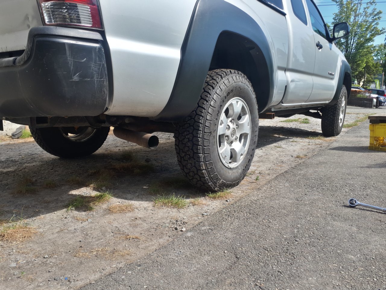

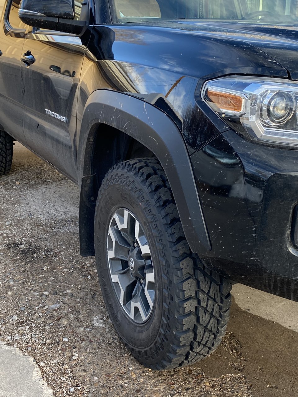

    IMG_20211015_143645~3.jpg 235/85 16 fits on stock OR without issues, I had the dealer put them on before I picked up my truck
    A couple of hours after getting it from the dealer
