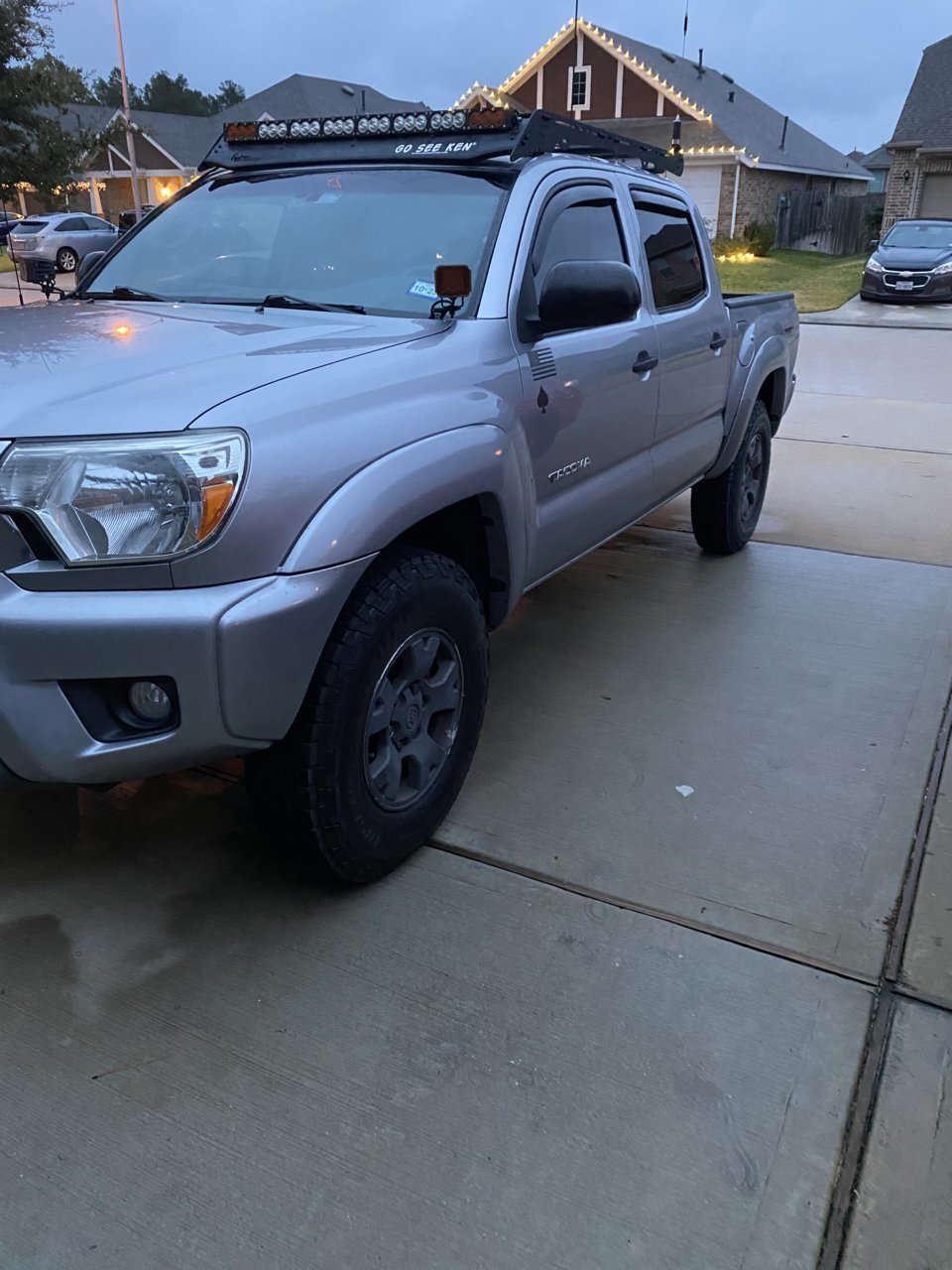

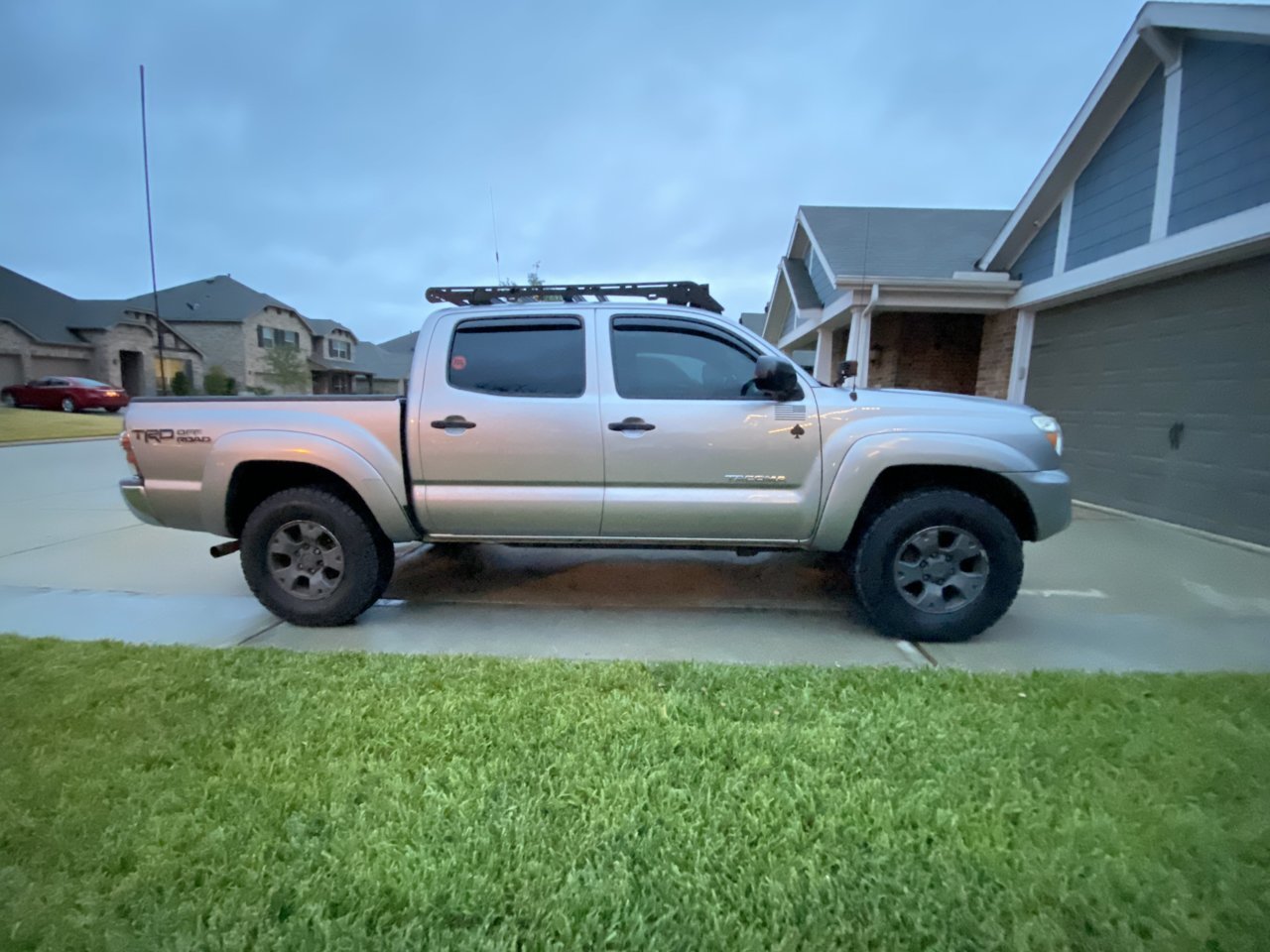

    Joined the skinny club today hitting some Discount Tires Black Friday deals.
    These New tires are so quiet!!!
    Previous: 265/75/16 wrangler duratracs
    40mph - 65db
    70mph - 75db
    New: 235/85/16 Cooper discoverer at3 lts
    40mph - 62ish db
    70mph - 70db
    impressed so far. The noise difference was like I got a Lexus. Will be excited to see MPG Difference here in a few weeks.
    I think this size looks a lot better with a more aggressive tread pattern like a KO2 but I’m happy with the purchase and am hopeful these stay trouble free and keep me safe for the next 50,000mi.
    thanks for everyone who helped me solve the problem I already understood lol

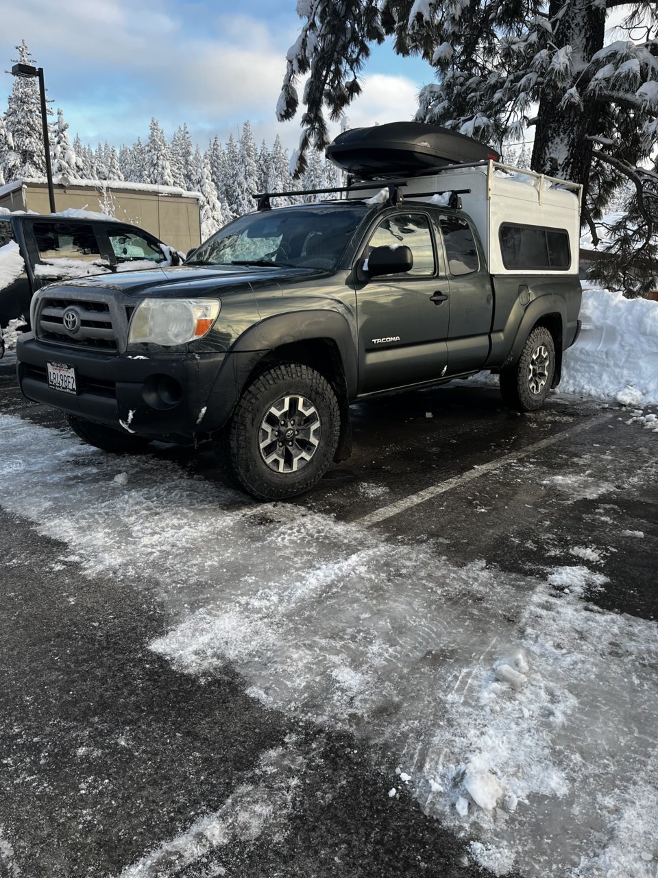

    Long time reader. 1st time posting….
    Got them tall skinny’s and wanted to give my stamp of approval. Living in the high sierra, got nuked with snow and this tire size lives up to the hype.
    Tire : mastercraft courser trail hd 235/85/16
    no rub, 3rd gen OR suspension.
    look great!

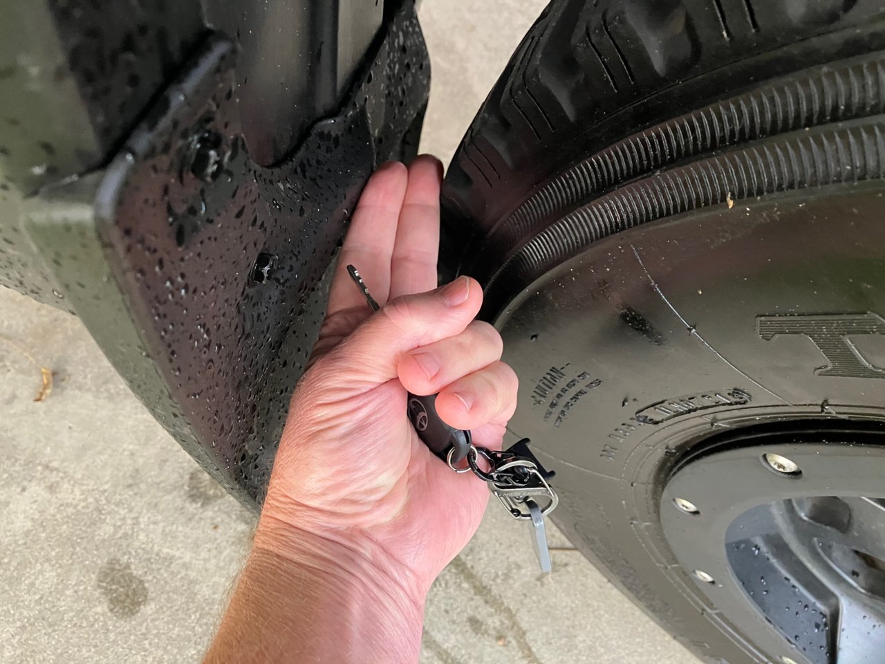

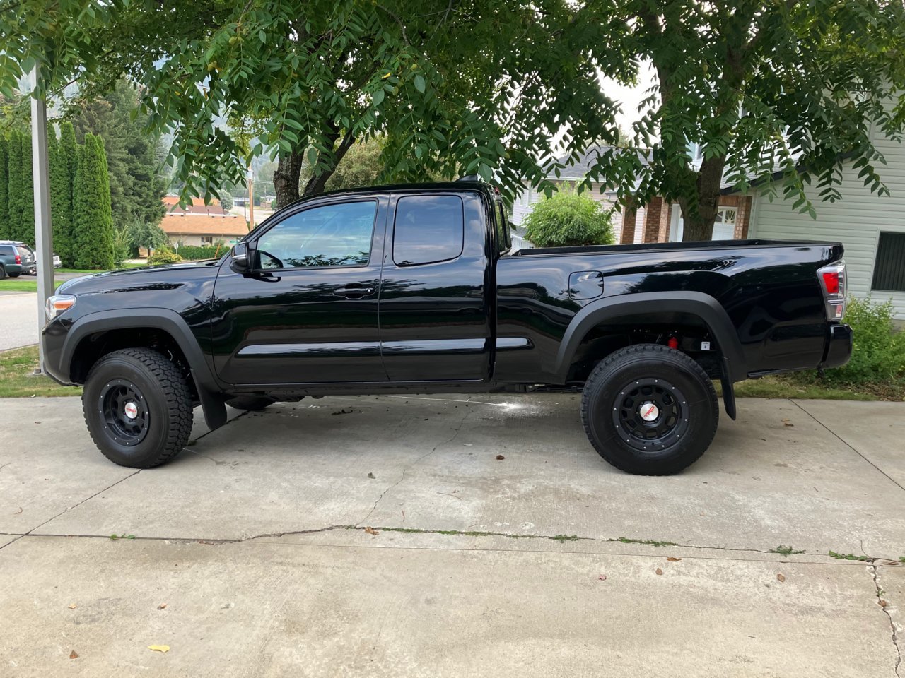

    Toyo M-55s, which are very common around here on trucks used by loggers and other forestry/mining workers. Very durable and have the "mountain snowflake" logo for winter use in BC.
    Truck is a 2022 AC MT with the factory TRD lift kit. Clearance is shown for the right front tire at "worst" angle. Same clearance on the driver's side. The fake beadlock wheels have a 10 mm offset versus the OR wheels at 25 mm, so the outer face of the tires are in the same location as stock.
    Did a "calm" drive from Calgary to the BC Interior (~666 km) in early November and kept it at 90 km/h (55 mph) through the National Parks and most of the BC highways beyond. Averaged about 9.0 L/100 km (~26 mpg) after taking into account the larger diameter of the tires. They are running at around 45 psi to retain the full load carrying capacity of the stock tires...that probably helps with the fuel.

    The 235/85 is the same diameter as the 265/75, and a bit narrower, so should be no rubbing. Wife has the latter on her Sport on OR wheels, and has never had a rub.
