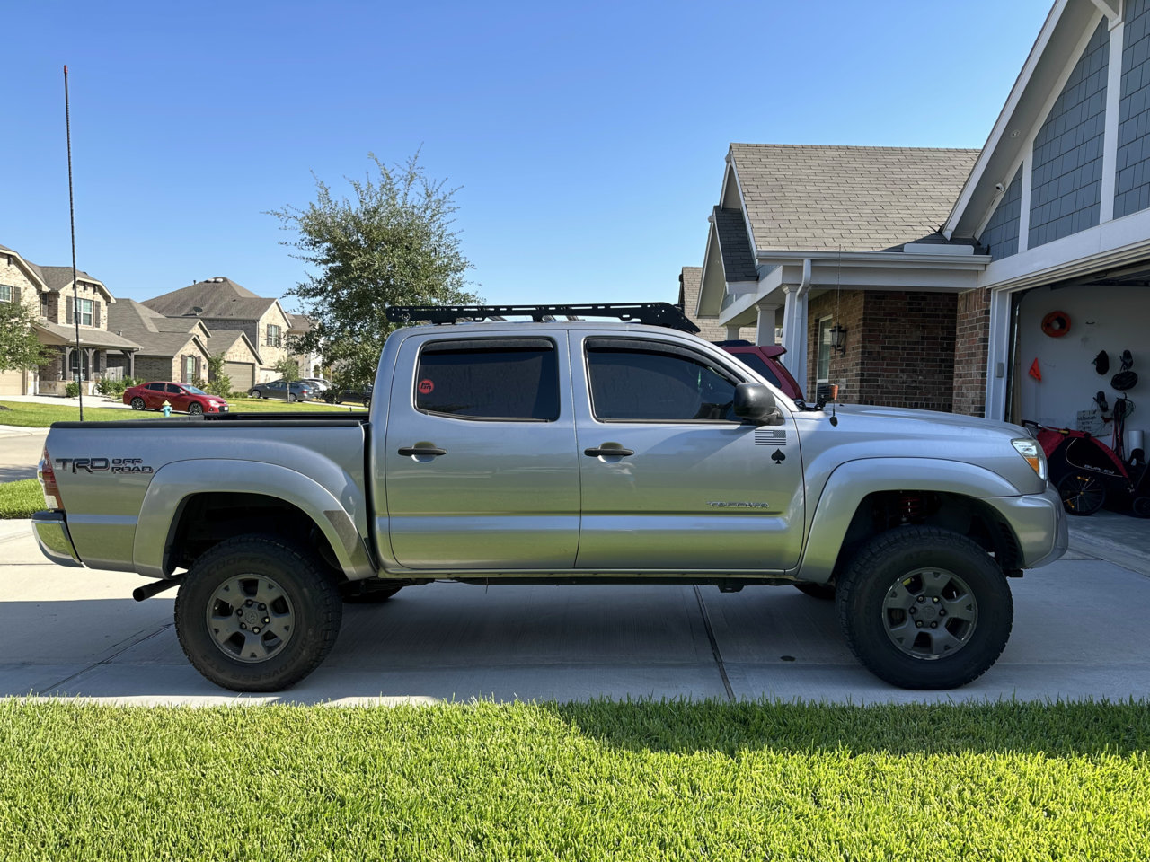

    Conrad

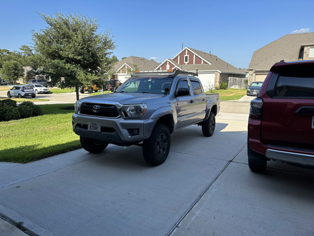

    I went from 265/75/16 to 235/85/16s, no noticeble difference in power. We haven't had too much rain lately, but when I got the tires put on last fall (our cold/wet season) I noticed considerably less slippage. But I also went from worn out duratracs to brand new ATs so I'm sure that had more to do with the tread pattern than anything. They're definitely quieter than the Duratracs lol.
    Performance in cornering. I will say I noticed a bit of a decrease in hard cornering which makes sense, typically race cars have wider tires for a reason. I carefully eased into how hard I'd send the truck into a corner but I have not lost confidence in the truck.
    I have since lifted the truck and they do look a bit small. Next tire size will likely be 255/85/16 and back to a more aggressive tread (just for looks) but the Coopers have been a pleasant surprise and all around good tire so far. I did get 0.5mpg average back compared to the duratracs, we'll see what the lift does.

    They look good on your truck i agree a tad small especially with a small lift which is what i have, i did not expect the 4.0 or the 3.5 to notice any power difference from 265 to 235's unless you went with a significantly lighter tire. With the 2.7 though we have a lot less power to begin with so small changes are felt, heck i go from a passenger and a little cargo to without and i feel it so i am expecting a little. I am not hoping any speed difference, its a 160 hp 5000+lb 4wd brick in the wind there's no tire that would make it fast or faster. Its all about drive ability if i can get the trans to downshift and lug less thats the goal.

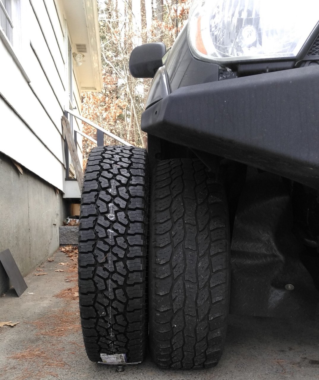

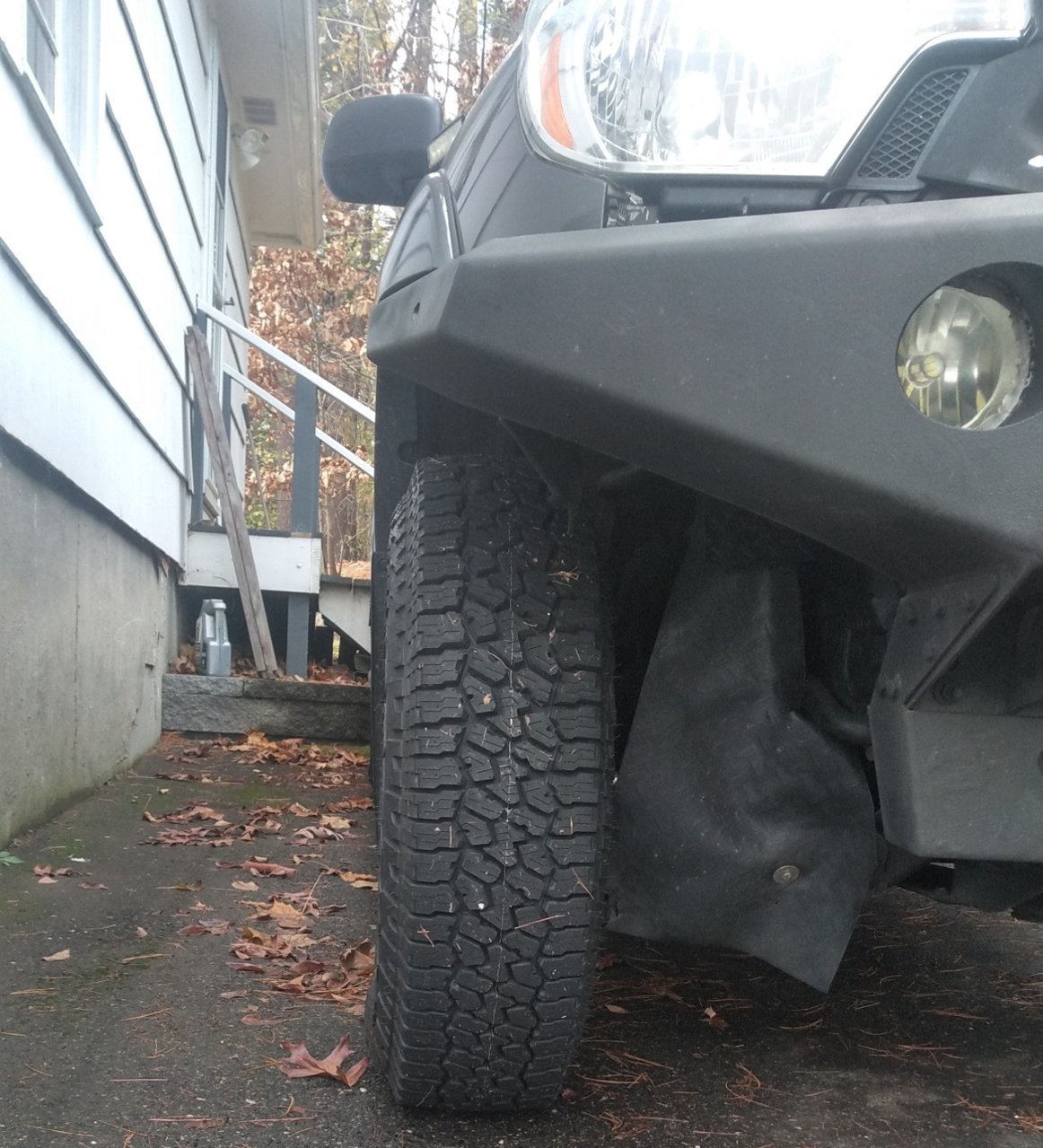

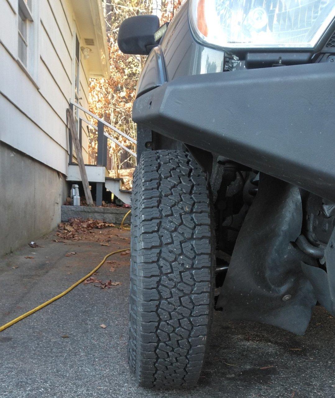

    235-85-16 Falken AT3W, had them since last fall, switched from 265-75-16 Cooper AT3. Drive well, only noticeable thing is the ride is a little rougher because they are at 42 psi cold/45psi warm based on a chalk test (AT3 where 33/35psi). Added some 1.25 spacers because I didn't like that they sat a little in the wheel wells, now they poke out just a hair.

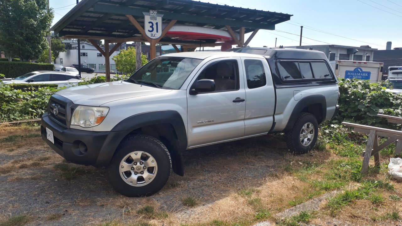

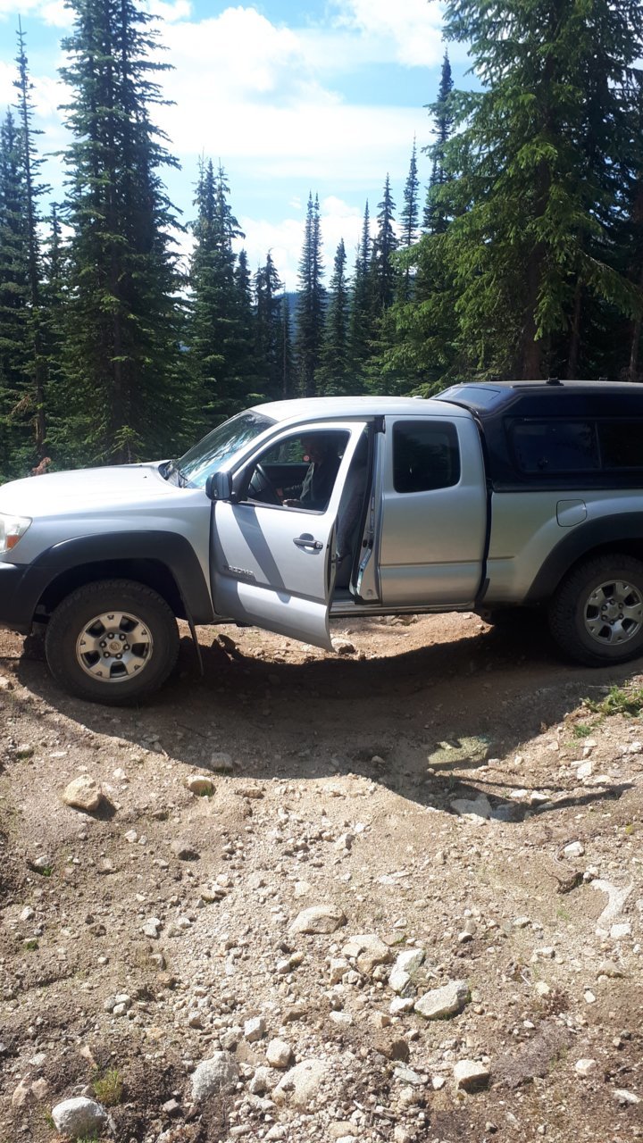

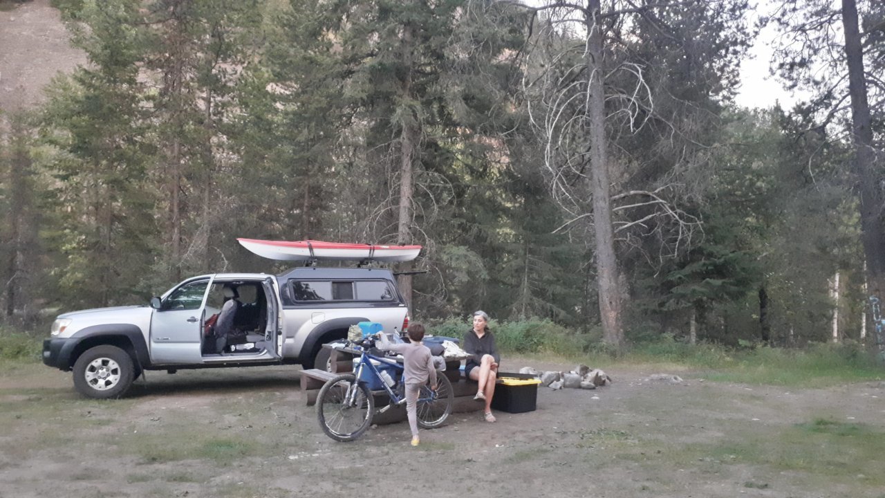

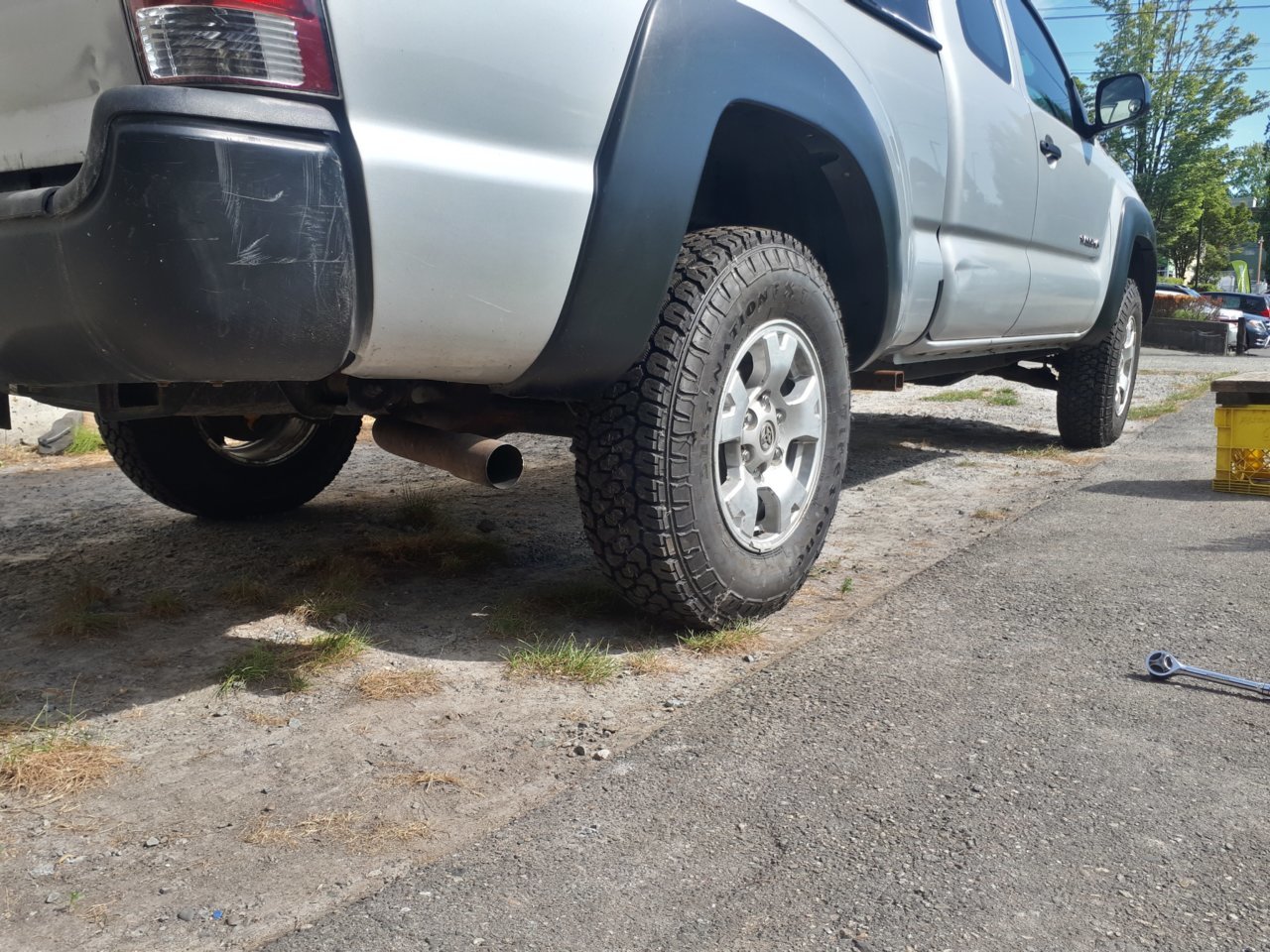

    I hear you with the in between gearing, and dang, those are LIGHT wheels. Yeah, I wouldn't want to go any smaller in dia., I think it would look funny. I deal mostly with snow and rain here, so I prefer skinny. I kinda like the look. Drives great, and the gearing just works. Very happy with the tires themselves, regardless of size. The X/T's are E rated, and I do not expect them to be as bombproof as BFG KO's (which are almost solid rubber), but met my requirements when I was hauling a lot of gravel, and I expect them to be at leat as puncture proof as a P rated tire..

    They look good a little small but fits the 2nd gen, even though they are almost the same size the 3rd gen just looks bigger the 215 would look too small. Love the color and are mid rise seems like good minds think alike. The wheels are FSW 2020 trd pro replicas i liked the wheel, not my favorite but the price was good and the weight was great. Dropped 6lbs from the stock sx alloys i felt a difference, looking forward to 235s i prefer the skinner look
